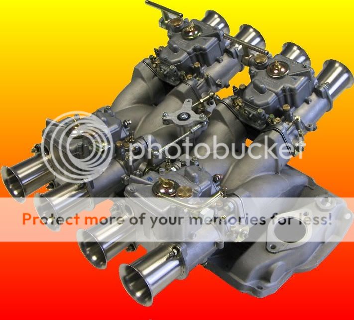

    The other day, on the Jalopy Journal blog, Ryan posted some "teaser shots" for the Hot Rod Revolution, and in one of the photos there is a 283(no Assy. holes) with 4 Webber carbs.Has anybody out there built an engine like that? That motor looks bad ass!

  2. 302 SBC w/4 webbers

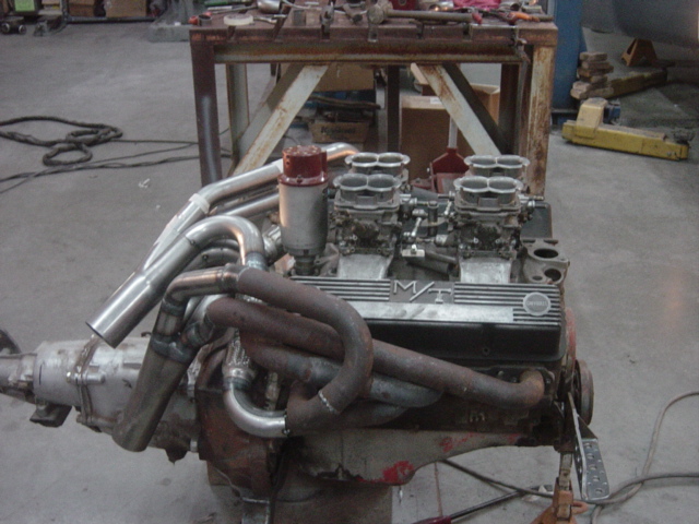

    Home made setup...

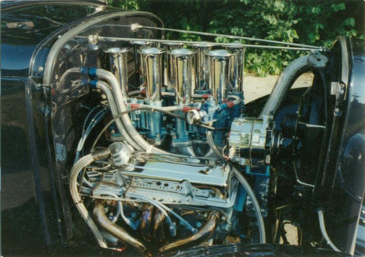

  13. Yep... The Roadster on the right had 48 IDAs on a Moon Racing manifold atop of a Snotty 355 SBC best run without VHT 12.40 at 119 and with the super glue VHT a 10.98 at 121!
    When you build it be sure to have a "Colortune" and an accurate flow meter and you'll do fine until there is a significant barometric change then expect completely different performance.
    I would highly recommend the IDFs for small engines for the street... they have smaller chokes and are better suited for the street rpms!

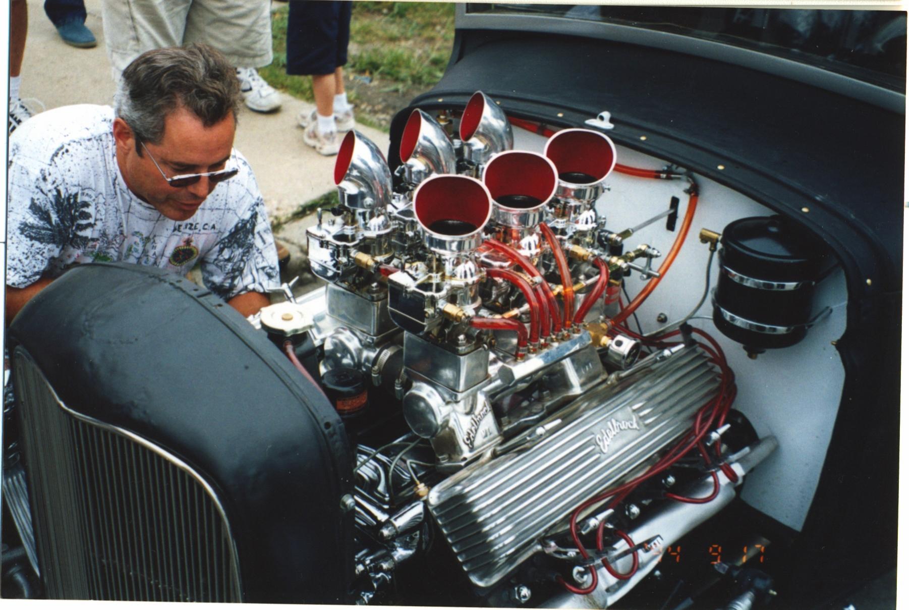

  15. The ultimate carbs for a Shelby or any SB Ford.

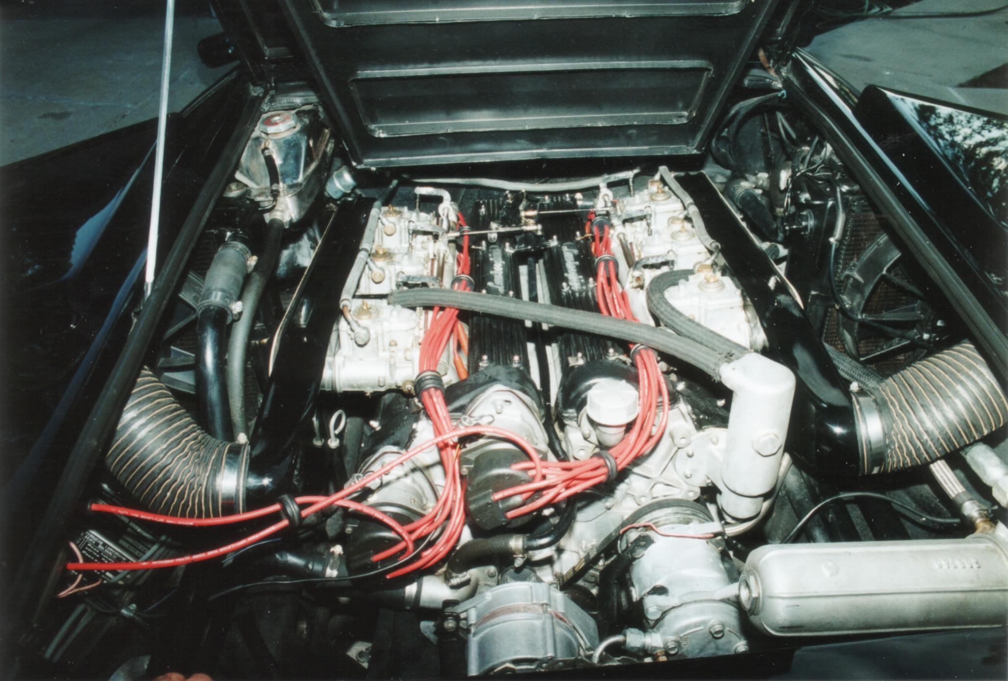

  18. I actually got really good at setting up Weber's, Delorto's, and SU's since I 've owned all combinations and raced them all.
    As I mentioned before it's important to get the right size for the application and yes they are very tune-able if you know what rpm to engine flow ratio... because that'll determine your "Air Meters" and choke sizes.
    Another factor is if your running Individual runners or a common plenum manifold. Individual Runners will require accurate flow meter as well as a British tool called a "Colour Tune" that'll indicate the mixture going to each individual cylinder is perfect and will greatly enhance the performance of your engine.
    Common Plenum Manifolds are like the old multi-carb logs and are more forgiving regarding mixture levels because you can shut the idle mixture screws off the end carbs entirely while running off the center carb's idle circuits... that way you can conserve fuel and not accidently load up the engine at low RPMs.
    I've tuned Countach's, Ferraris, AC Cobras, GT40's, Jaguars, Austin Healeys, Hot Rods and aircraft from what I learned from Webers and SU Carburetors!
    The Countach ran 6 DCOE side draft carbs and I developed a special tool to balance the air flow where you don't have to remove the quarter panels and that has kept me more than busy with a couple of fellas car collections in the past.

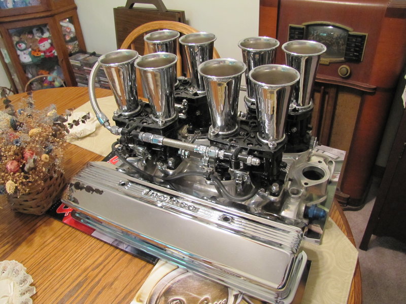

    Hope to learn from this post as I have an older unit that has never been installed Have valve covers from Inglesse & all the other parts to install but not sure about Have talked to Comp Cam & they were very helpful just haven't pulled the trigger yet
  25. nor6304
    Joined: Aug 23, 2009
    Posts: 402
    nor6304
    from Indiana
    pic of webbers

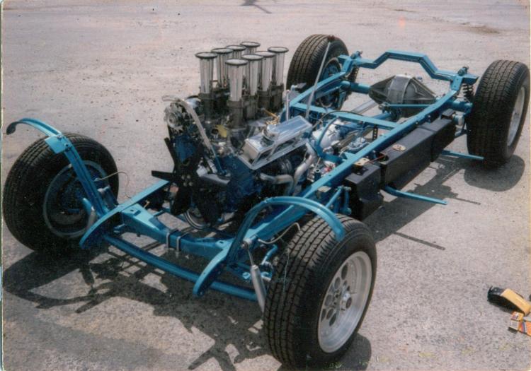

  29. The "Teaser" pic is of my motor. Small journal 327 with 48 IDA's. They are good for 660 CFM per carb. Alot of consideration goes into the setup. # 1 and most important is the cam selection. Must be custom ground with almost zero overlap of intake and exhaust valves.
    Yes.they are costly. 3# fuel pressure MAX. They are awesome once you get them tuned !:cool:
    volvobrynk likes this.
