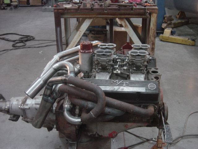

    Here a 8 IDA set up the my younger brother put together. the other is a 4 IDA on a tunnel ran intake.He works for pierce manifolds in Gilroy Ca.

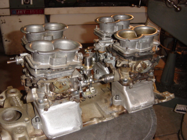

    You did make (cast?) those adapters eh metalshapes? Nice way to go after that, smart thinking. How does it run, flow? Not too many SM's around anymore to pick over.
  4. When is to much too much....?:eek: I don't think I could see that many cfm going through that 409??? LOL it is different... kind of like running a pipe organ for an engine.
    How many of those carbs are actually functioning? How many vacuum leaks did you have to chase before you could get it to idle?
    At least there is a common plenum for each set of 4 carbs
    About the time I would have to tune those carbs... I would've pealed them off and got the Hilbourn to run on the street... I think it would've been much easier and just as impressive!

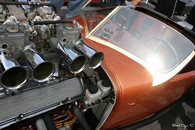

    Thats actually a 4 DCOE+4IDF, but it is still crazy.
    I'd really like to hear it, but mostly does it really need 8 of those?
    The roadster i know, i got a few pictures, that manfold w/ the 4 DCOEs is awesome.
