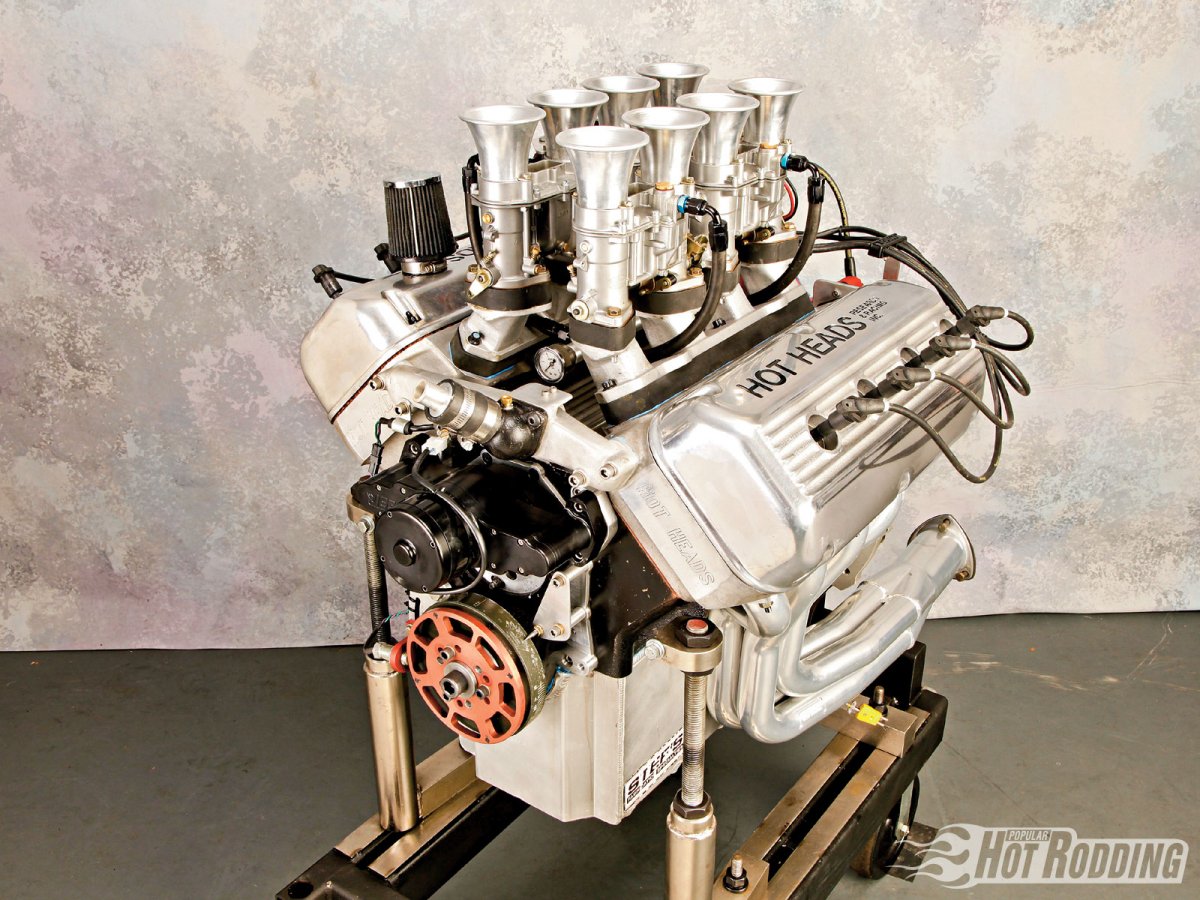

  16. Gene Adams and Hot Heads did a nice job with a 385 ci early Chrysler Hemi in one of the Engine Master Challenges

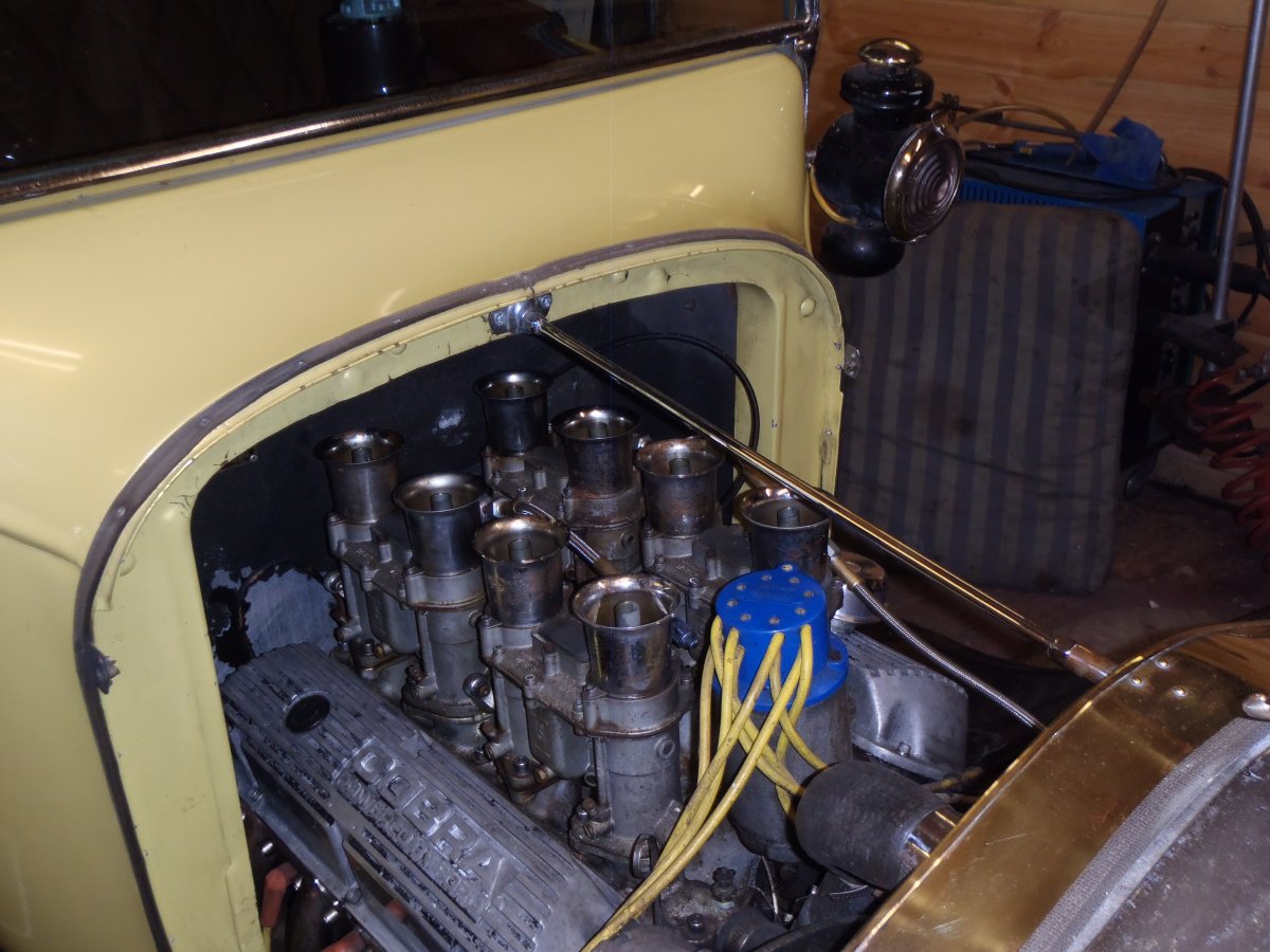

    Just about to start on this. Had Webers on this for years and its always been a dog. Sometimes runs fine, other times its like we threw a cat down the trumpets.
    Any info will help.

    This is a familiar symptom to me. The snapping you describe is a lean condition and I believe, in my system, that it is caused by a small particle p***ing through the low speed jets. The small particle I believe is a product of heat on the gas in the line making a sort of carbon like substance. It is so small that a filter won't take it out. I thought it was the gas tank but latter found a isolated area of gas line that was very close to the exhaust system. The carbs were always backfiring as you describe. When I would pull the top of the carbs off to expose the float bowl there would be a very fine brown substance, that I believed to be rust, in the bottom. After removing this substance the system (drain the bowls and use a vac***) they would operate fine. I coated the tank and cleaned all the fuel lines, at which time I discovered the line close to the exhaust. After insulating the line from the exhaust the problem has gone away. I also found that the carbs are very sensitive to heat. You have to have a barrier between the manifold and the carb. The 1/4" asbestos gasket needs to be in the system and with the tight conditions in my engine compartment I ended up with a 1/4" laminated plastic plate that deflects the heat from hitting the float bowls. I also tried an aluminum plate that worked, but not as well. If you enlarge the photo in my last post you can see the heat deflector plate between the carbs and manifold. From pictures I've looked at it seems to be common placed.
    Hope this helps.

    Sidedraft DCOE's have the same problem.....especially when mounted on 4 cyl non-cross flow type engines, where you have to install a very effective heat shield under the carbs as the heat from the exhaust header underneath will cause terrible running issue's as soon as the car is stationary from extended times, such as in traffic. Not a problem in a pure track compe***ion car, but used to cause a real headache when in a road registered semi-comp vehicle.

    In retrospect I believe that the DCNF Weber would have been a better choice for my V6. I know why they used the 3c IDA as that is the experience they had with DCOEs which they used because of the distributor location on V8s. However the DCNFs would have fit nicely on the Buick V6 with its distributor location. The DCNFs are designed to fit closely in a row and the low speed jet is out in the open. The IDAs are a problem tuning as all the low speed adjustments are almost covered up on the left hand carb. If the car were used for compe***ion, this would be a problem with changing jets for track conditions. However once the carbs are set for the street, that's IT. In the end you make the adjustments to use the system and live with it or go to a 4 barrel or multi 2 barrels which is more HAMB friendly anyway. I know the drill and am prepared to live with it and that is what makes mine different. I believe that is what hot rodding is all about.
    Greg

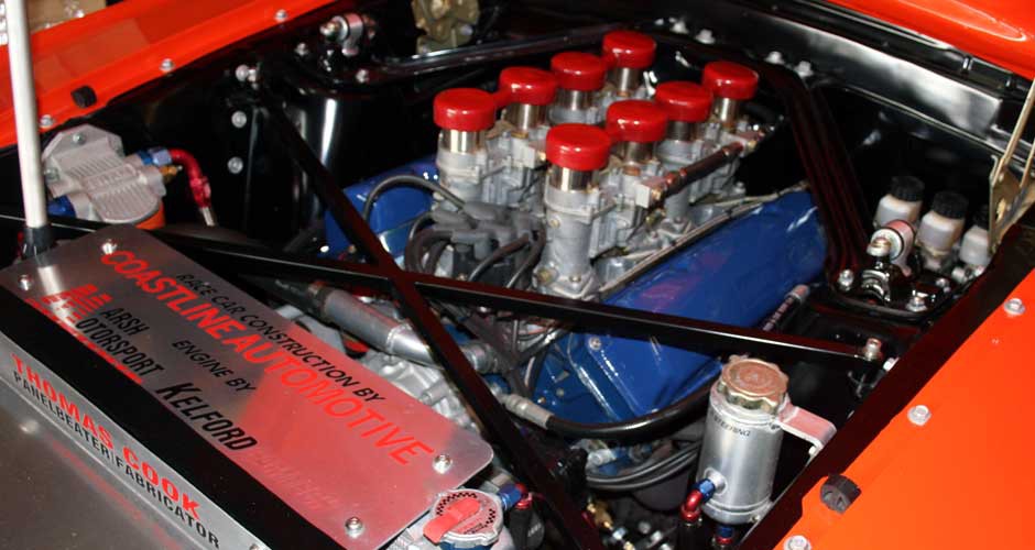

    Not a Hemi, but you get it.
    All of the above.
    Go big, or go home.

    The yellow tourer above. Now has 'standard 302 crate engine. I think the jets are 151. Can anyone give me a starting point for the mains as it sees to run OK on the idle jet (up to about 2500 rpm.If I can get a starting point for the mains then I will make some venturi plates and open them up in 2 mm increamants to see how it makes a difference. Always willing to learn and take advise and no problem with machine time. Just want to get this sorted out.
    Funny thing is NEVER had a problem with twin carb set up on a 4 banger.
    Is the old style flow meter with a tube and float OK for balancing them????

    I don't think your mains are the problem. Do you own a lathe? Restrictors might work but you would be better off making chokes. The check for main jets is the same for all carbs, wide open, chop the gas and ignition, coast to a stop and check the plugs. Black you are running rich, white you had better open them up. There is a lot of info on Ford engines with Weber carbs. Are your accel pumps good and adjusted correctly?
    Greg

    You need to make sure the chokes are the correct size for your motor/application and jet around them.

    I do have a lathe. We used a set of these on a Rover V8 (small Buick) back in the day and even with help from 'experts' couldn't get them to run right. I started to turn up some chokes at 32mm dia but we sold the set up before I completed all 8.
    It shouldn't be a problem to get the carbs working right but for some reason I cant get my head around the problems because they change all the time. Fitted an electric fuel pump and regulator, made no difference.....What fuel pressure is best.
    Looked for info and came up with mostly race set ups. This is a road car and not hammered, except for the odd occasion. Just want it to run right and smooth. Course EFI would sort it out. All done on the PC not with your hands getting dirty, but there's no fun in that; is there.

    Fuel pressure is critical. Has to be below 4 psi. You will have to run a regulator and your float valves might not hold that much pressure (more like 2-3 psi). It sounds as if you aren't getting the low speed (best lean) adjusted correctly. This drill takes many times to get correct. Adjust to best lean, match flow with flow gage and air correction jet, bring RPM back to set (mine is 1000 RPM) using the idle stop screws. Carbs have to separated at the linkage from each other. They all have to be at best lean, draw the same air and be at the correct RPM before you connect them together. I was about to throw the thing away too until I got my head around the fact that it is like tuning a single cylinder motorcycle times 4, 6 or 8 times. Its a individual runner system and each cylinder has to be adjusted to match all the others. If a cylinder isn't correct I have found that going to the rear of the car and listening to the exhaust one or both will sound as if you have a leaking valve. Every time you adjust flow with the air correction you have to return the idle to base RPM using the idle stop screw on that carburator. Mine works just the way you want yours to work. The TR3 is a road car and runs on the idle circuit to about 3000 RPM which is about 75 mph. Anything above that is main jet and choke. I know that there is a emulsion tube involved here too but there are only a few that work with larger engines so you really don't have to make too many guesses if all other methods fail (chokes and main jets). You can go to EFI but then you will be doing it with a computer and won't be getting your hands dirty. LOL.
    Hang in there.

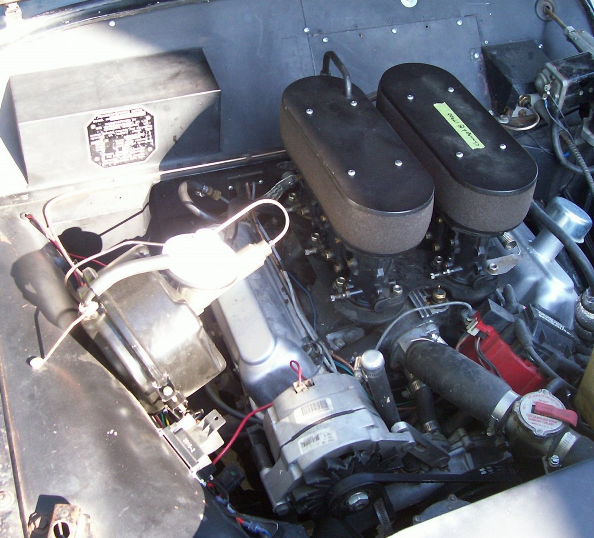

    Anybody know who makes/made this setup?
    I have fetish for oddball induction setups.
    Most everything I have are multi carb setups. Ive had three sets of Webers over the past 30 some odd years and love them.
    The setup her intrigues me. All I need is the intake for a chevy. I'll figure out the rest
