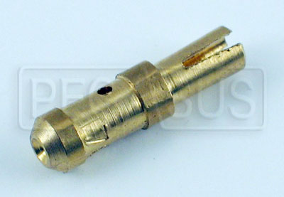

    Pull out the idle jet holder:
    And examine the idle jet, before ordering more. There are TWO different types (no idea why):
    This:
    And this:
    You can get individuals at: https://www.pegasusautoracing.com/images/L/74822.JPG
    Or you can buy a tuning kit.
