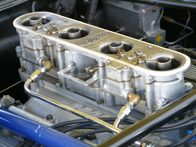

    In '68 or 9 Ford actually made carbs like that and used both one and two 4-throat carbs on a cross ram manifold. They called it a Cross Boss. You just drill a blank intake cover as needed. ford carb.jpg
    Hnstray, loudbang and Deuces like this.

    Thats really cool. I have never seen that setup before. Im guessing fairly rare (and spendy)
  17. big duece
    Joined: Jul 28, 2008
    Posts: 7,093
    big duece
    from kansas
    yes, and yes
