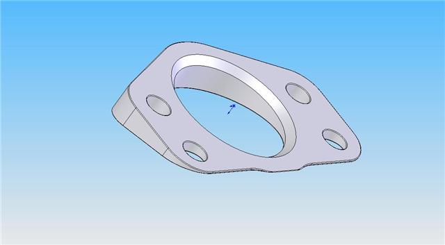

    I had a friend CNC carve a pair out of a chunk of aluminum for me last summer....
    hopefully I will have the fairlane rolling again by spring and can give some feed back
