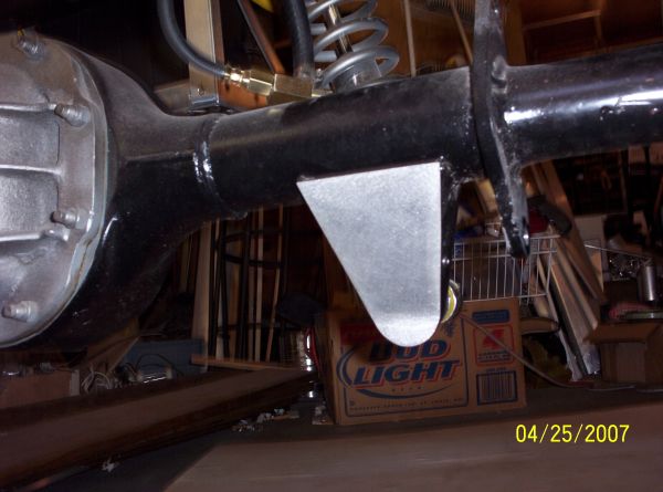

    While waiting for the bondo to set on my hairpins I thought I'd try and
    get my rear shock brackets looking better.
    Ended up making little covers to hide the nut holding the coilover on.
    Took some .080 aluminum cut the same as the bracket and welded some
    1/8" alum. tabs on the back side to screw into.
    Pic.1 is the before thing and pic 2 is the cover before black paint to match
    the housing...

    Clean & simple - looks good!

    Been thinking of ways to "clean up" the coil over mounts for my "A."
    You just gave me a way!
    Thanks!
    Dave
    BTW - did you make covers for BOTH sides?? (front and rear)
