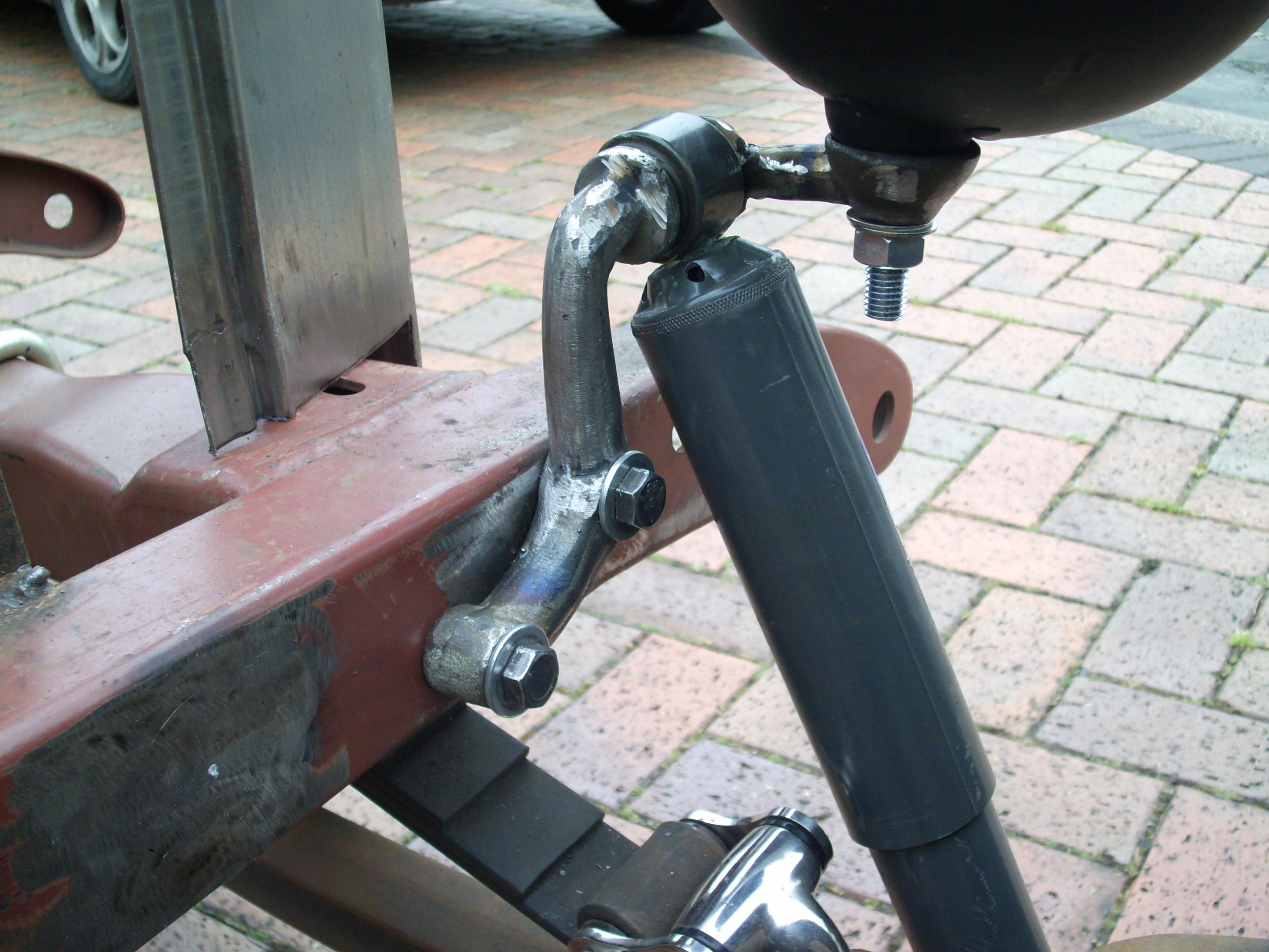

    O.K. Heres a bit more of an up-date.I've been doing some more frame/ch***is work.The rear shocks are now in a more normal place, I had them angled forwards mounted to the bottom ladder-bar bolts!They looked **** and were streched too much, not enough travel left.Now they sit mid point in the their length.I've also cut down the front shock mounts 2 1/2'' and mounted the headlights I got last weekend. I'm not too sure about the headlight mounts at the moment, I'll more than likely change 'em as I not to keen on running a headlight bar.I've also lost all the speed holes in the front frame rails, YIPPEE!:D;)I never dug 'em so filling the ******s in!I've also made a new gearbox mount too, which took a bit of working out due to the gearbox mount sitting ''pissed'' as we say over here!!!:DAlso boxed in the ladder bar front mounts, they should hopefully be strong enough now.

    Nick,have you considered welding the headlamp mounts to the shock mounts?As you say,if you leave them where they,you'll need a headlamp bar to tie them together. Without it they'll move about like a **** in a shirt sleeve!
    Frame looks loads better with the holes filled.
    Nice to see you're making progress,good work.
    Cheers,Mark

    Mark, Welding the headlight mounts to the shock mounts was the plan, but I spat the dummy with it!!!!:D:D:eek:I'm gonna have to have another crack at it as thats where I want 'em to be:)and THANKS guys for the kind words.
