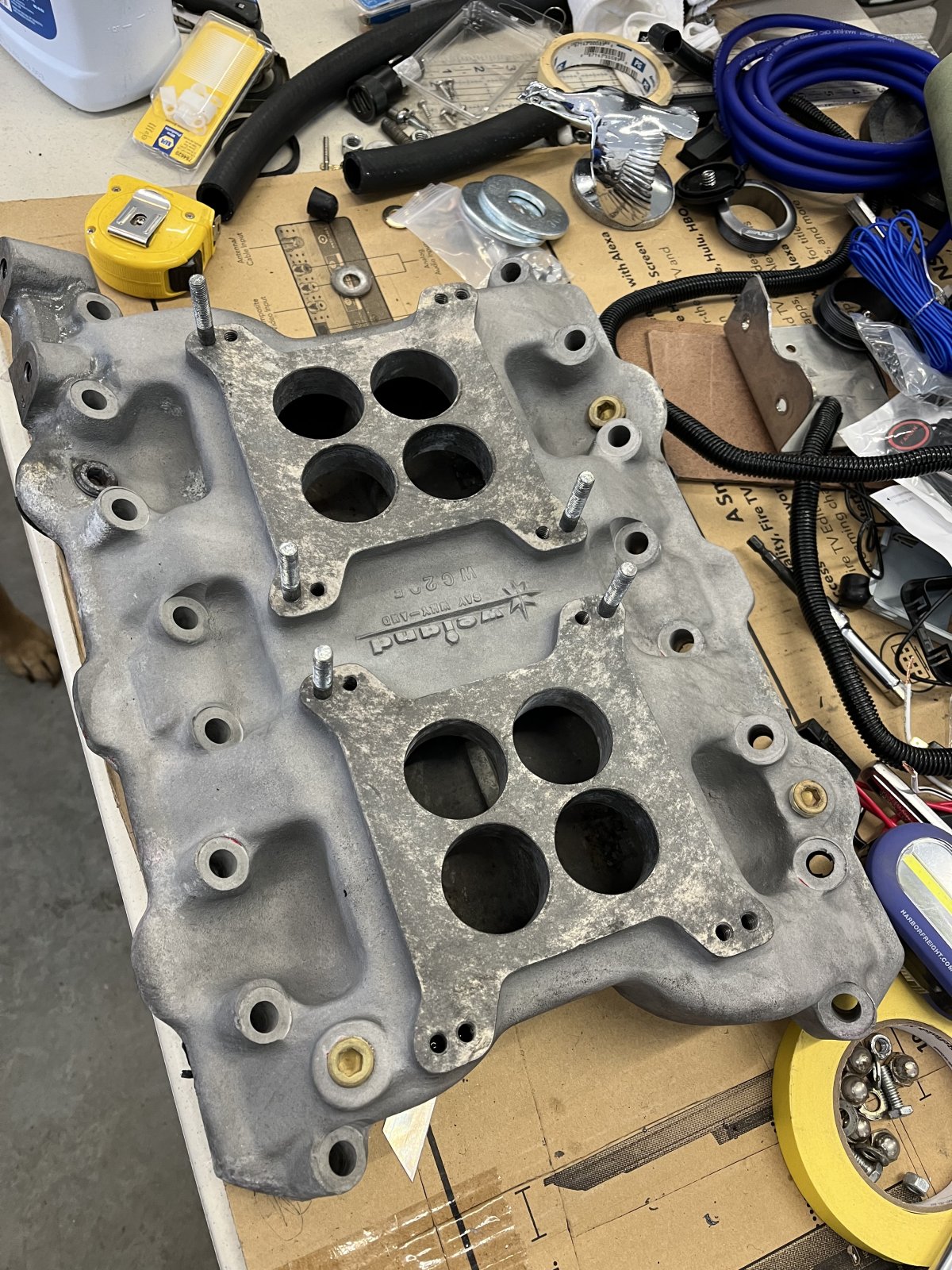

    I’m curious about polishing my Weiand intake manifold. It was powder coated when I got it but now that it’s been stripped clean I’m worried that it’s too rough and porous to get a good shine. The powder coating shop chemical stripped it, they did not sandblast it.
    Has anyone polished one of these? If so, could you post a picture?

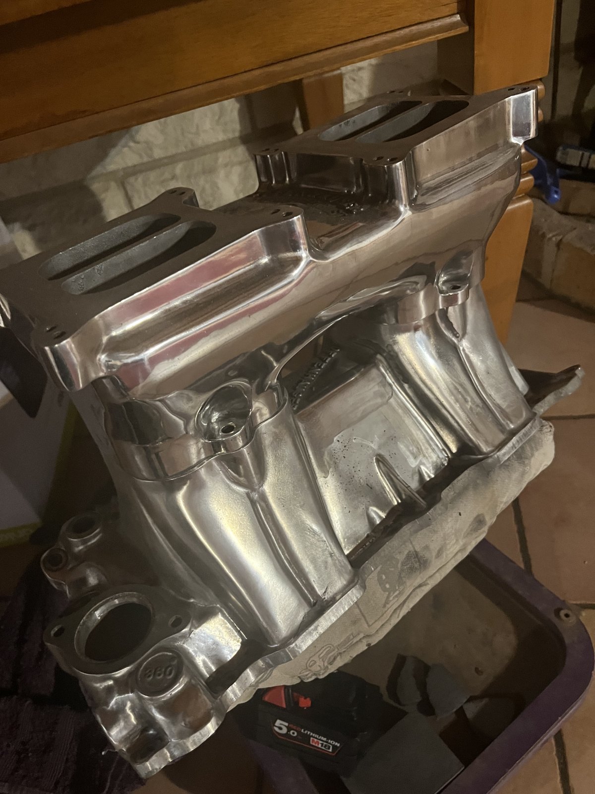

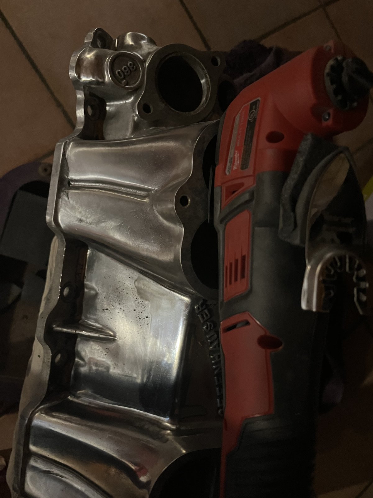

    Milwaukee multi tool (cordless) cheap ebay sanding parts (they don’t last but are cheap) start with co****st grit you get in the packet then go all over, change grit and continue. I’m at 800 , buffing machine next. It takes a lot of hours to do a tunnel ram but I was quoted A$2500 and that wasn’t going to happen. Would rather put that sort of money into engine parts 4D473BF0-7813-41D4-BE11-18FD08C54F20.jpeg 4E37177C-51B0-46BD-BCFB-9FC86481B57E.jpeg

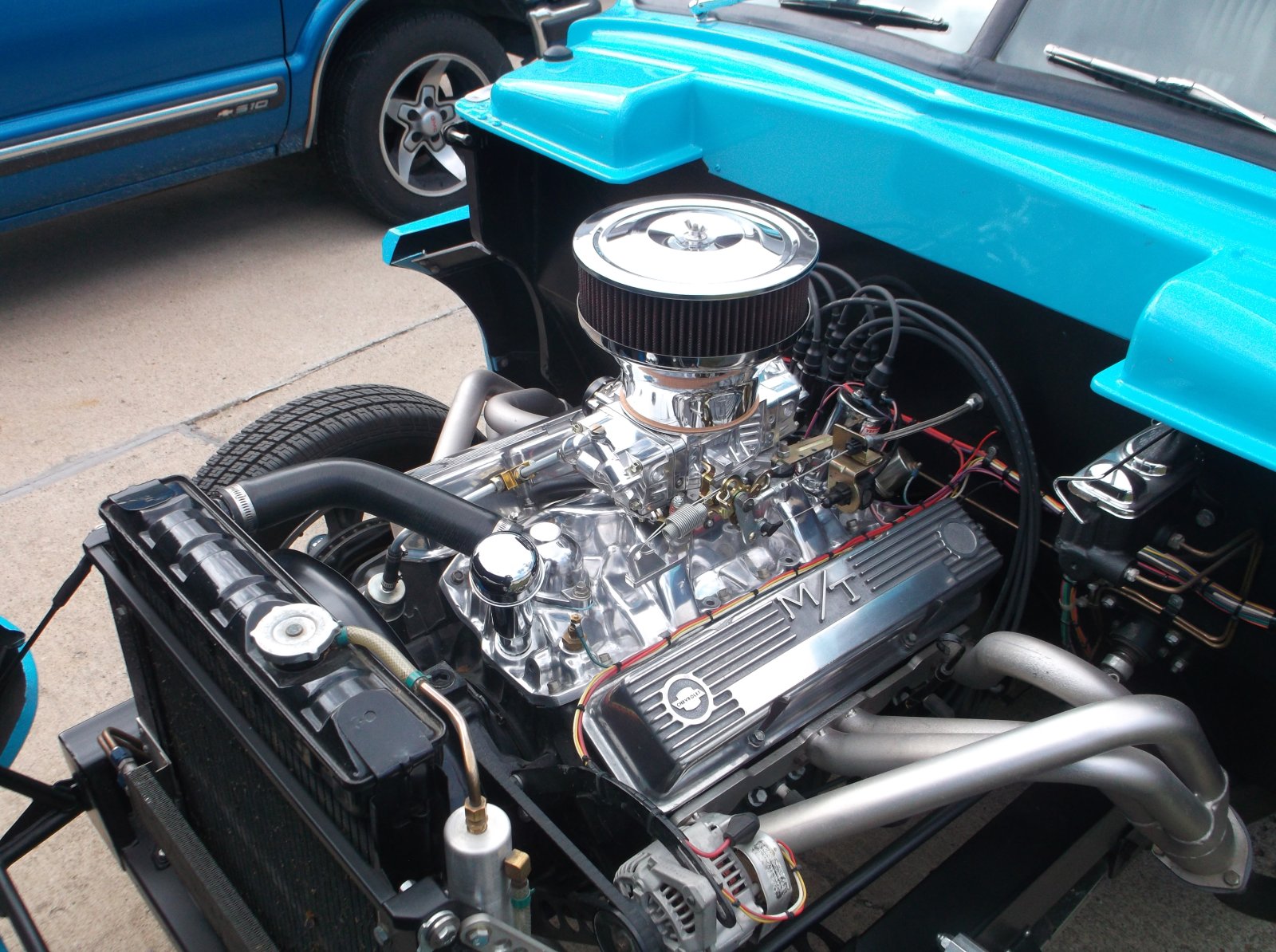

    I have a friend who is into the polishing, he starts with carbide bits and a die grinder and moves onto sanding drums and dremels etc. You need to rig up a vacuum so you aren't breathing all the dust. Here is some of his work. [​IMG]

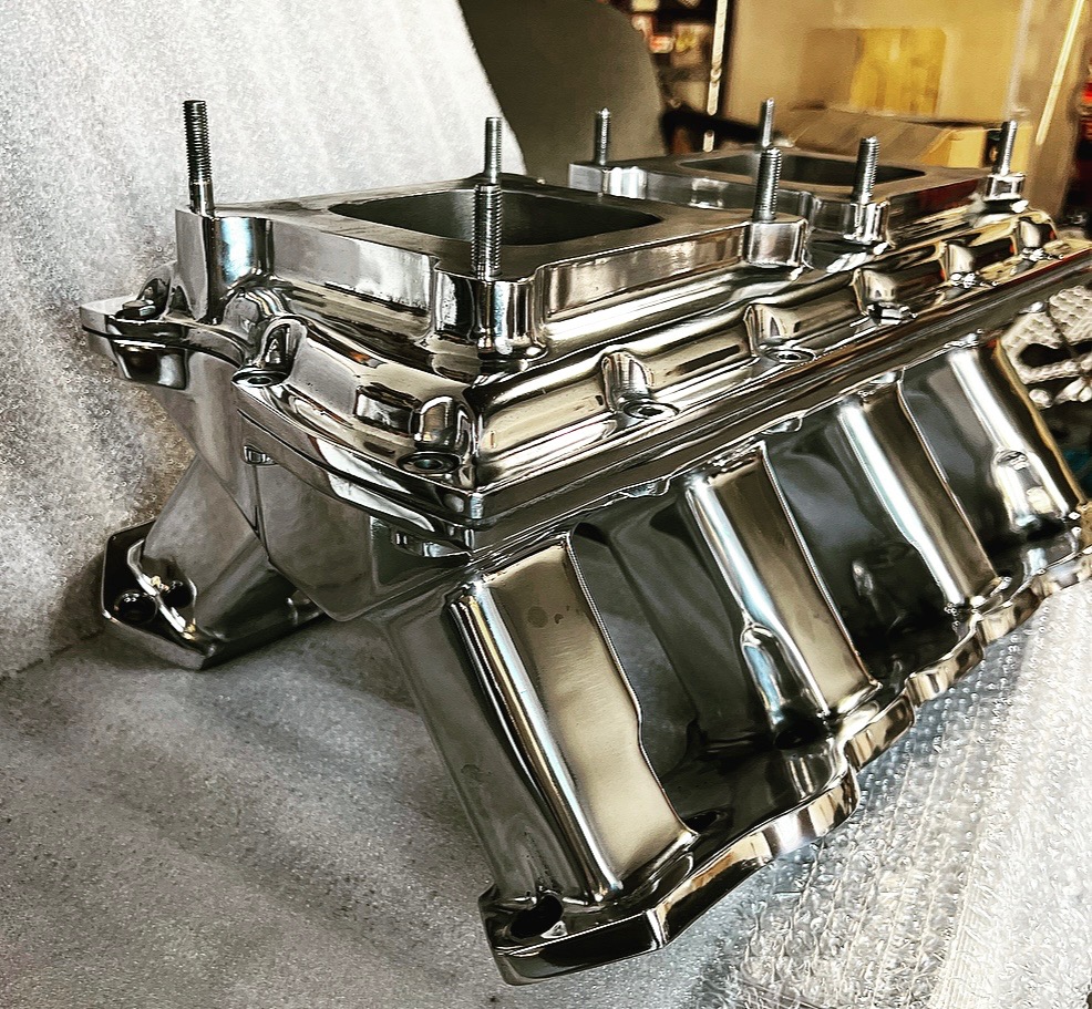

    slayer

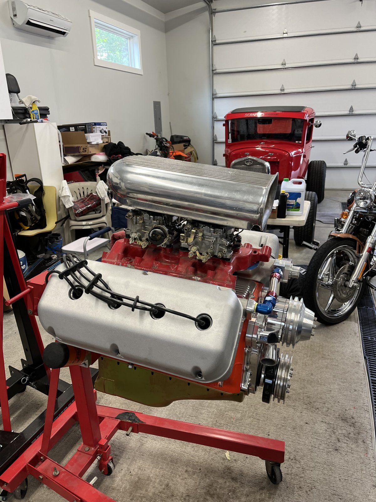

    This is obviously not the same intake, but this w*** a sand cast intake with a ruff finish for a 392 Hemi 16539.jpeg . Dad just picked this up from our polisher and it is better then new!

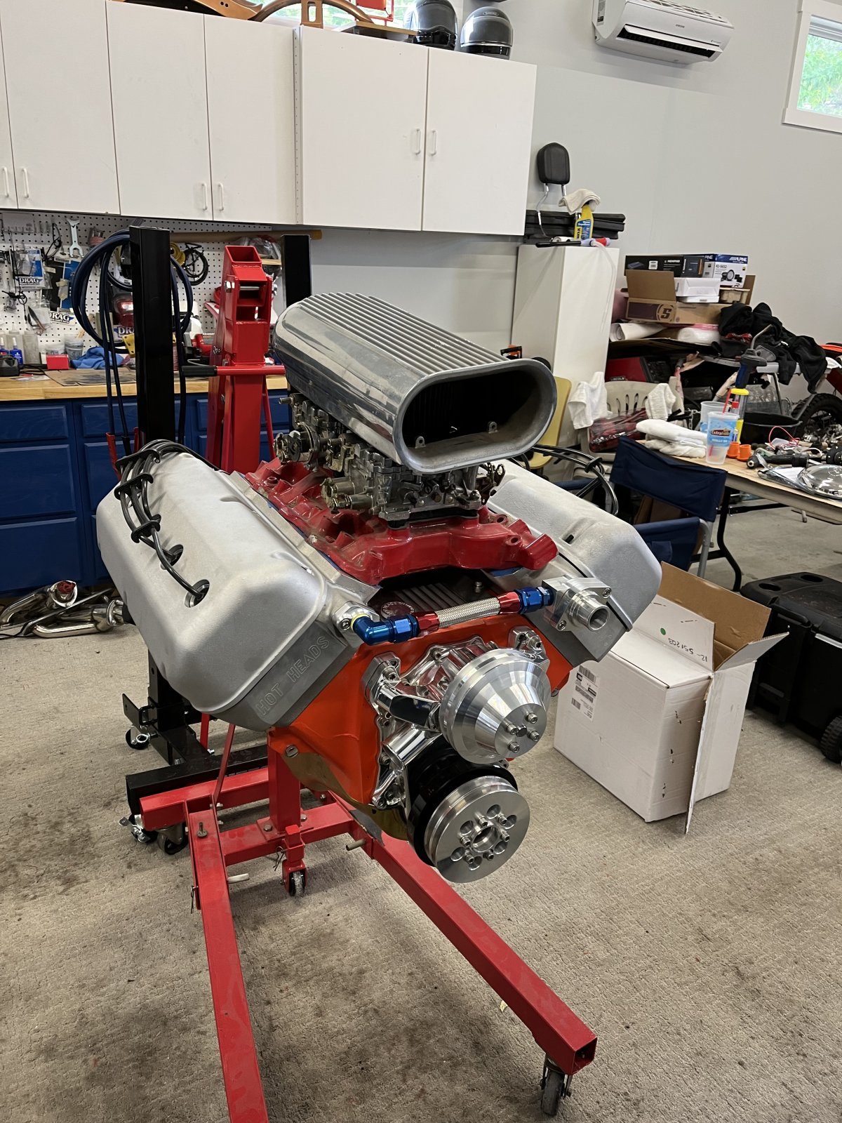

    It can be done at home, lots of careful sanding with rolls , various grits and patience. Then polishing with several different compounds. Eastwood sells kits to do a manifold. I use there products. WIN_20220403_14_36_59_Pro.jpg

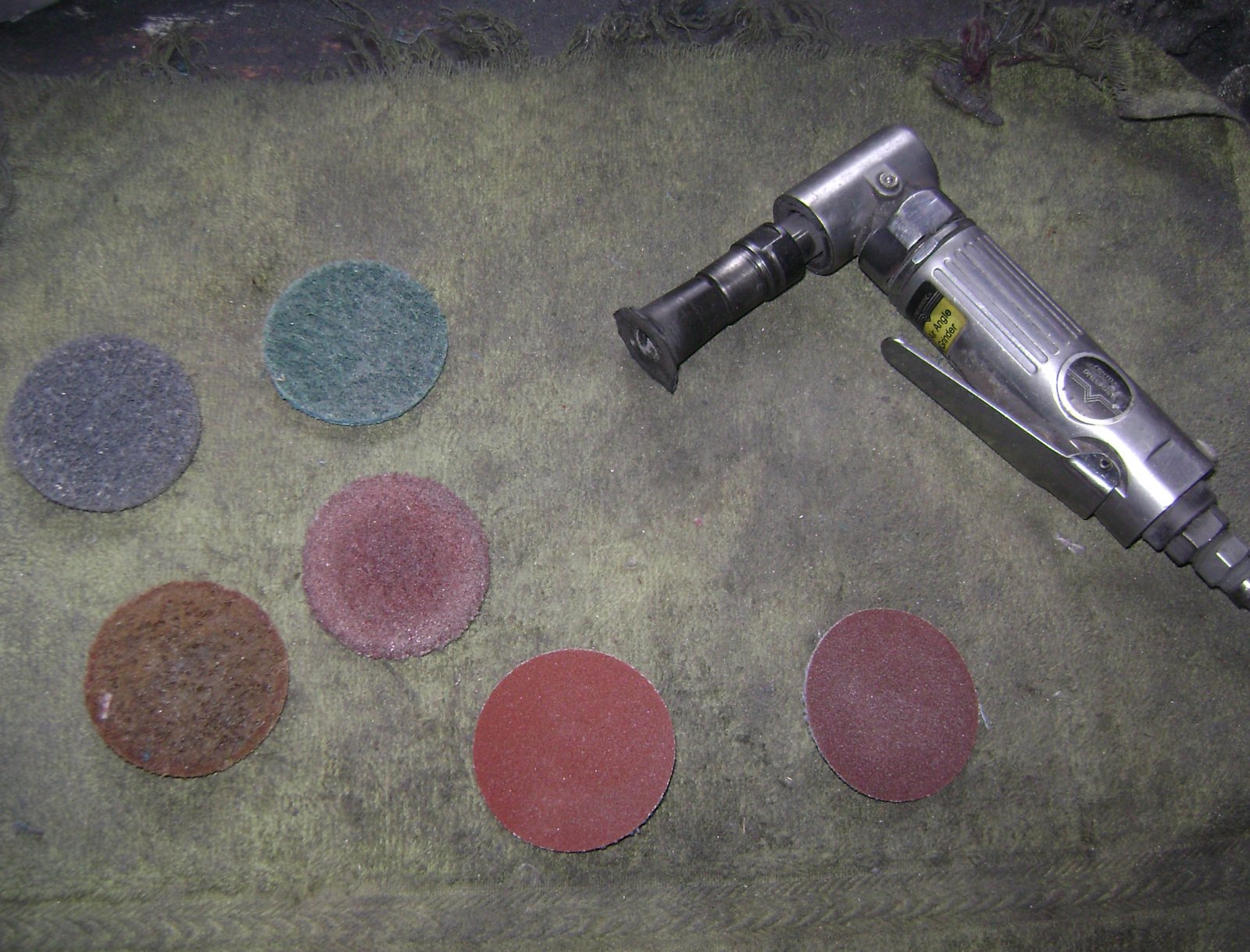

    I've been using 3" roloc 'surface conditioning' discs (AKA Scotchbrite) for years to prep aluminum for polishing. It'll be more expensive than sanding rolls, but not by a whole bunch. The time saving aspect makes it worth it to me. Here's an example... Alt  cover start.jpg
    This is the start. While this is an originally polished part, there is corrosion and various nick and scratches. The top was hit with a 400 grit disc to remove a deep gouge.
    This is after hitting with a blue then grey disc to remove paint, corrosion and scratches. About 15 minutes.
    After polishing with my buffer. Total time start to finish about a half hour. If you want a mirror finish, more time at the buffer will be needed but keep in mind it'll be harder to maintain.
    The tools. The discs are in order of aggressiveness: brown, maroon, blue, then grey. The sanding discs are 120 and 320 grit but I use those sparingly, primarily for 'leveling' out gouges and s****es. Note that the disc backer is cut down; that's important, it allows the discs to 'bend' into curved areas. Fresh discs will be more aggressive than used ones, and if the disc starts 'smearing' you're running it too fast or too much pressure or it's getting worn out. You'll figure it out, it just takes a bit of time. I also use a 6" disc for leveling large areas, but you won't need that for the intake.
    Your intake casting looks pretty smooth, I'll bet you could start with blue discs then finish up with greys before polishing. There's lots of recesses on that intake, that will be the time-consuming part of this. Buy the discs in bulk, you'll need a bunch of 'em. It pays to shop for the best price, I get mine from Keene abrasives out of Canada.
    A tip: no matter how hard you try, there will be places where you just can't get these (or anything else) in there to smooth the metal. I've found that s****ing these areas with a sharp tool (knife, modified wood chisel, etc) works very well, the buffing process will blend it nicely. If you use sandpaper, then it takes multiple sanding to get rid of the scratches.
    All this applies to aluminum, steel is a different kettle of fish entirely.
    To get an idea what a time-saver this is, I did all of the below...
    ... in about eight hours. And that's not all of them; the five items that aren't engine covers are times two, I just didn't show them. Granted, these were all originally polished but several of them weren't fully polished and all needed some smoothing to get rid of scratches, pitting and gouges.
    My buffer is a 1.5 HP Baldor spinning 10" buffs. A smaller buffer will increase the time. You'll also need some 1/4" shanked cotton buffs to get into those nooks and crannies. This isn't really rocket science, it's mostly time...
    Good luck!

    The polish job cost $425, but the intake needed a lot of extra work.
    Performance Metal Polishing did the work. His contact info is 1128 lunt ave, Schamburg IL 1(847)5441162
    He is a one man show and does all the polishing for Dyers Blowers. He also restored our stainless trim to better then new condition.
