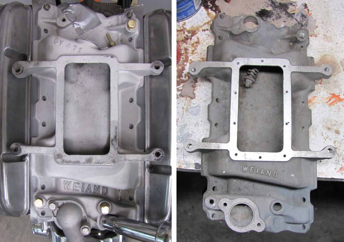

    Anybody know the difference between Weiand SBC 4-71 intakes #7135 and #CV471? I got one of each, and the castings appear to be the same except for the logos and numbers... just curious if they are older/newer versions of the same casting, or if there's an actual difference I'm not seeing.

    my guess would be the large block letter logo is the earlier version

    I dont think there is a difference in them the CV part numbers were the early intakes

    Judging by the change in the Weiand logo, I would say they are two different vintages of the same product.
    I believe that the one on the left is newer.

    Maybe one is from before 1998 when the Weiand Power & Racing company was sold to Holley Performance and the other is from after.

    Yes Crager did make one too I saw one not too long ago sell for 400 which is a steal
    I have the 7135 version on mine its the newer of the 2 shown I would guess the CV 471 casting would be mid 60's vintage and yes they will bring really good money im guessing they quit making them in the 70's but thats just a guess

    I have a '62 Weiand catalogue I will look up when I get home, hopefully that will at least pinpoint to the early sixties which is which. However just knowing a little bit on early Weiand stuff I would guess that the C prefix is the earlier intake and I know the 7 Prefix was used later on, but hey I could be wrong.
    Reason I say this is that the Drag stars I have are prefixed like 'WC8' which is a Weiand Chrysler hemi 8x2 the blower intake I have is a WC671- easy to work out.
    so I take is that since they were making Chrysler products for V8's before Chevs the C mostly ended up as Chrysler, as in the WC, I do have a 2 3x2 chevy intakes that are C356. No W or V. will try to scan the catalogue when I get home.

    61-2 catalogue lists a WCV 471 for 55-59 chevy's

    looks like a Weiand 7135 with the name and numbers removed
