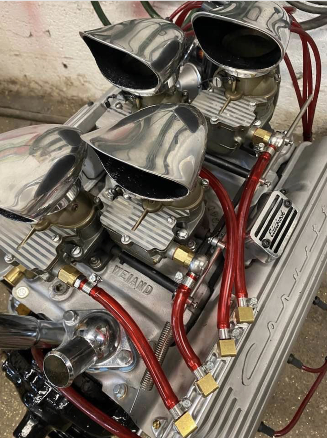

  1. Hey guys I'm setting up 4 x 97s atm on a mild 283 with ported power packs, 9.4:1 CR, mild hyd stick, 2.5" Vette rams horns.
    Qun I have is, has anyone set up this intake idling off only the 2 center/middle carbs alone, and have the front and back carbs without idle circuits in them ? If so how did it work for you with idle AFRs and transition/cruise ? I'm thinking it should work on this intake if set up this way ?
    The front and rear carbs will still have accelerator pumps hooked up as do the center/middle carbs.
    This is on a direct linkage, not progressive.
    Curiosity is getting the better of me......any thoughts ?
    Thx !

  4. Yep it'll be interesting but I'm going to test it as I described.
    Being a dual plane intake, I'm betting that the 2 center carbs will provide more than enough idle air/fuel to the cylinder if the 2 outer carbs idle circuits are temporarily blocked off.
    Here's my home fabbed linkage with Clive's extended shafts/supports.
    Anyone else have any input ?
