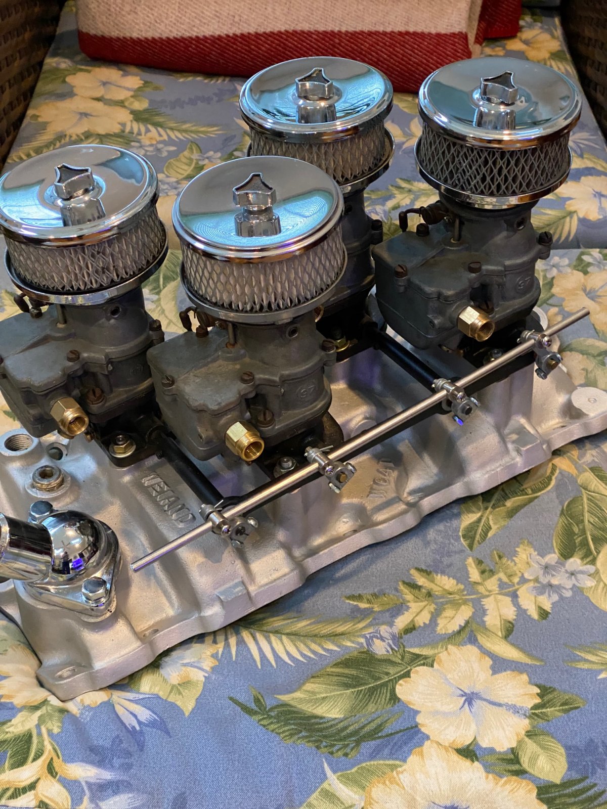

    Hang on, I’ll let you know in a couple of months. My 283 is at the machine shop now along with my manifold and carbs . It is going in a fad T with a 5 speed and 3:55 jag rear. D7011147-CA6E-4C46-AD0B-FDE62377E222.jpeg
    I have had 2 very bad 4 deuce experiences…..on the Edelbrock 360. When my engine went into the machine shop, they agreed to everything being dialed in correctly before I pick it up……I can hardly wait
    For my Maryland friends, Jim Bunting of JB Machine will be doing the carb work. He is our local 97 Guru….almost as old as the carb 97 number

    all of it came just as you see it. I bought it from that dreamy guy @Moriarity . Maybe he would know

    That is straight linkage that I made. I would rather run straight linkage these days to keep the fuel in each carb fresh...

    Not in the car yet, but ……….
