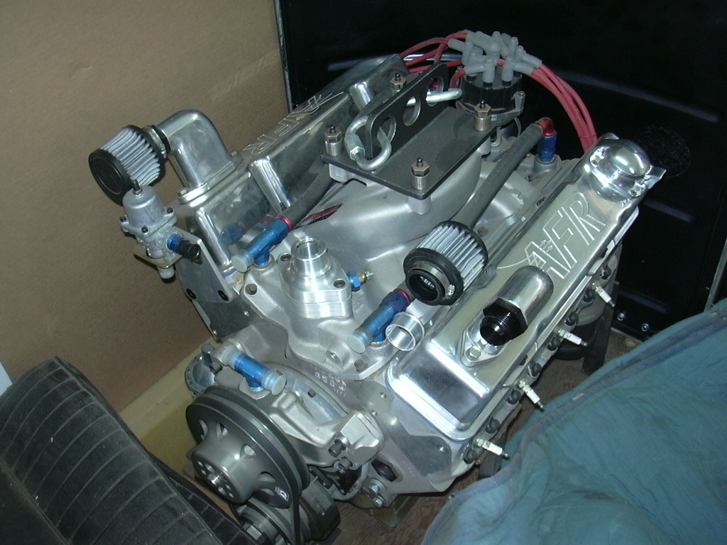

    1. A-D Truckers
    Later blocks and heads were light weight castings, I know I was amazed the first time I picked up my
    Vortek heads.
