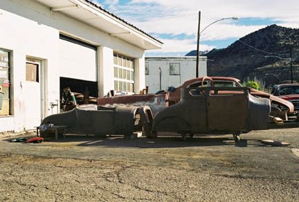

    Rick I am dying to see some progress pics. Im building the same thing. Have a 331 Hemi and a 27 Roadster!!!! PLease post em!!!!

    nuther pic

    I gotta see more of that chopped coupe body.....DAAANNNNNNG!!!

    That coupe chop is crazy, I remember checking it out at Bo's place this summer.
