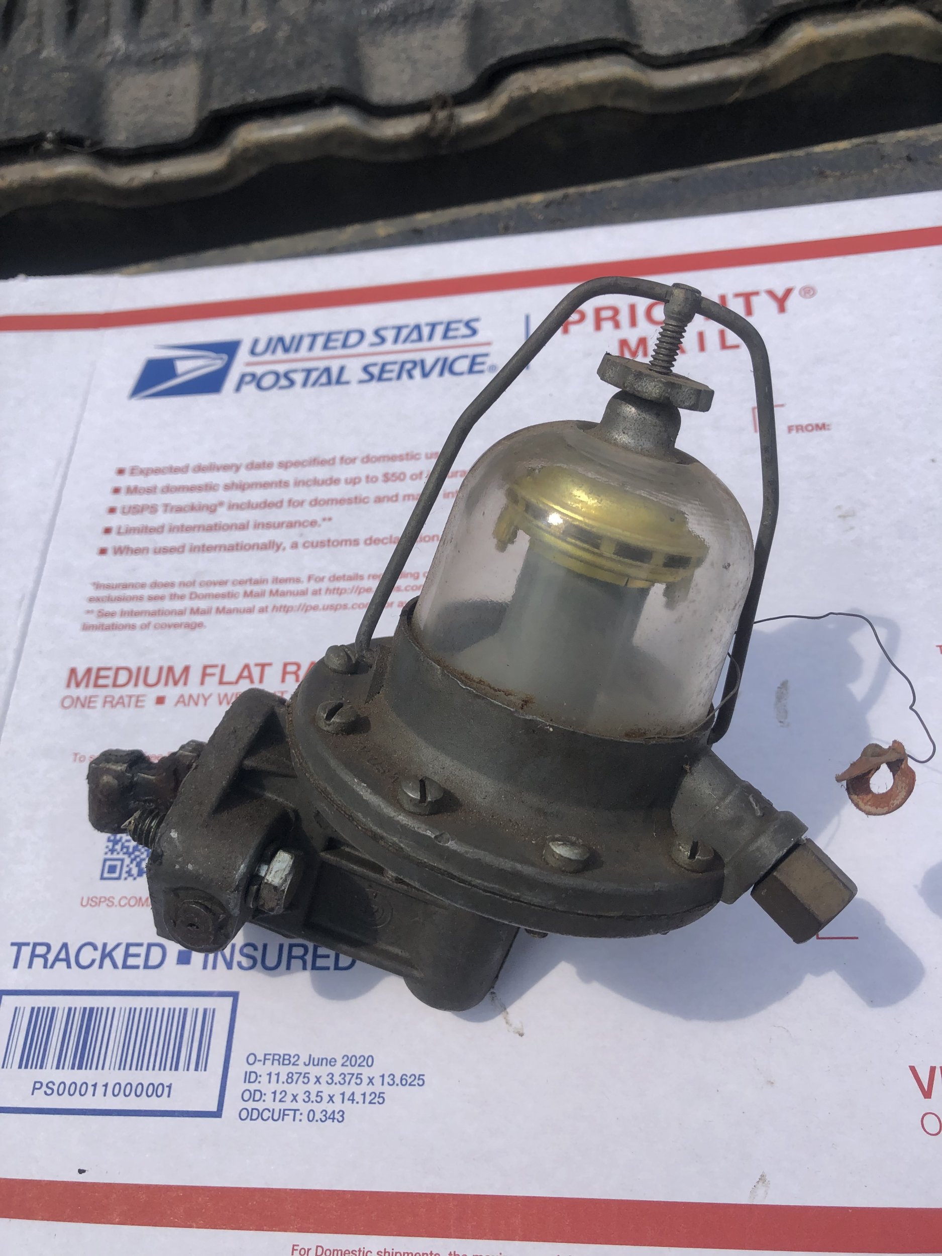

    I originally posted this on What's It Worth, but got tumble weeds. 20250707_110827.jpg
    This came off a flathead in a AV8.. The previous owner was just using it as breather as the car has an electric fuel pump. He called it a "school bus pump" and I have no idea what that means, and can't find any useful references on the internet. It almost looks like the bowl is mounted upside down, but I don't think that's the case.
    Any ideas on what it is or it's value?

    I think it's an upside down water trap for the gasoline line

    Definitely looks more like a separator than pump. I don't see any mechanical means to actuate a pump.

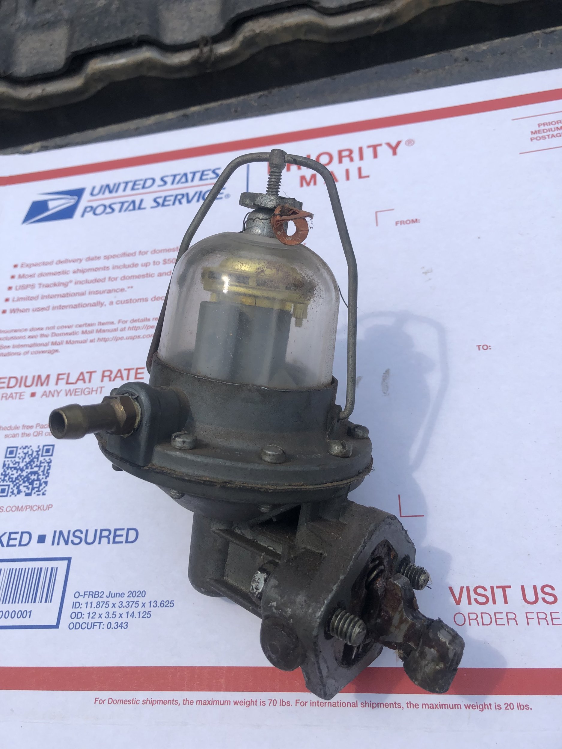

    I don't know. It definitely looks like it receives push rod from the cam.

    That pocket in the end of the arm goes over the pushrod.
    I think it was bolted on upside down.
    Try lining it up properly and see.

    If I flip it over, it won't clear the manifold. Also the actuator arm is spring loaded to be pushed upward. Its definetly not upside down.

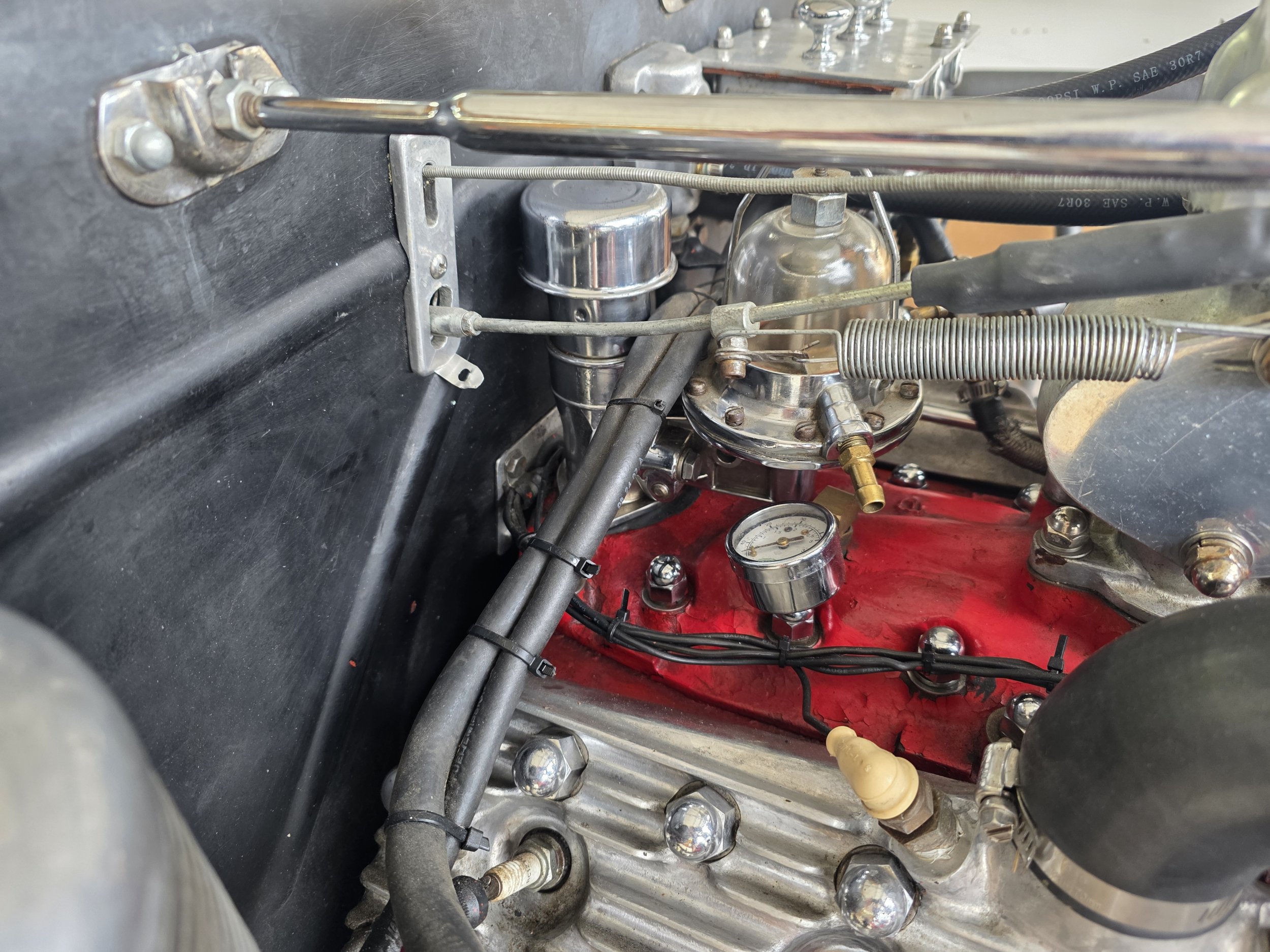

    The push arm cup has obviously been modified. We probably need pics of it from its natural environment to know how it fit on that bus.

    As requested, here's a photo of it on the car:
