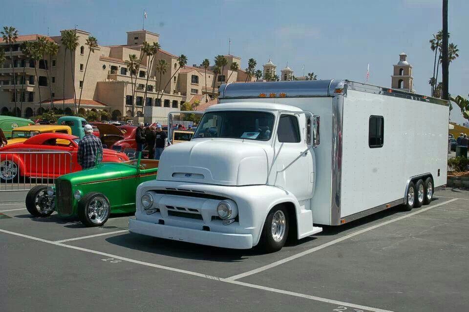

    Just get an old GM motorhome ch***is. I have seen a couple built like this with a trailer box on the back. I have no ideal how well they perform though.
