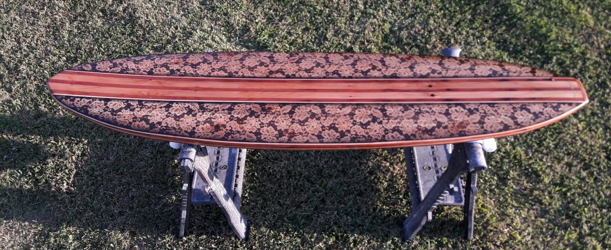

    My first attempt at a lace paint job on a wooden surfboard I built. Came out nice. 20171123_000548.jpg

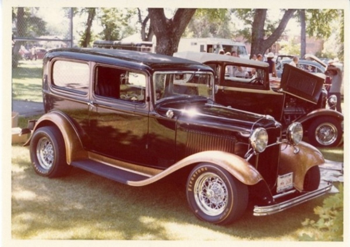

    My old 32 sedan, had Gold metalflake fenders with black cobwebbing, and gold lace on the gas tank.
    Mick

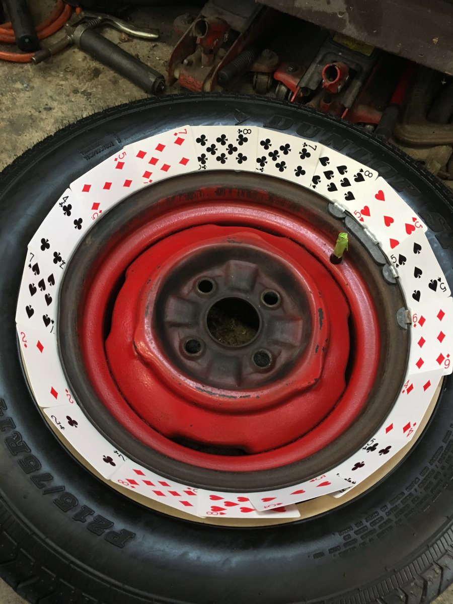

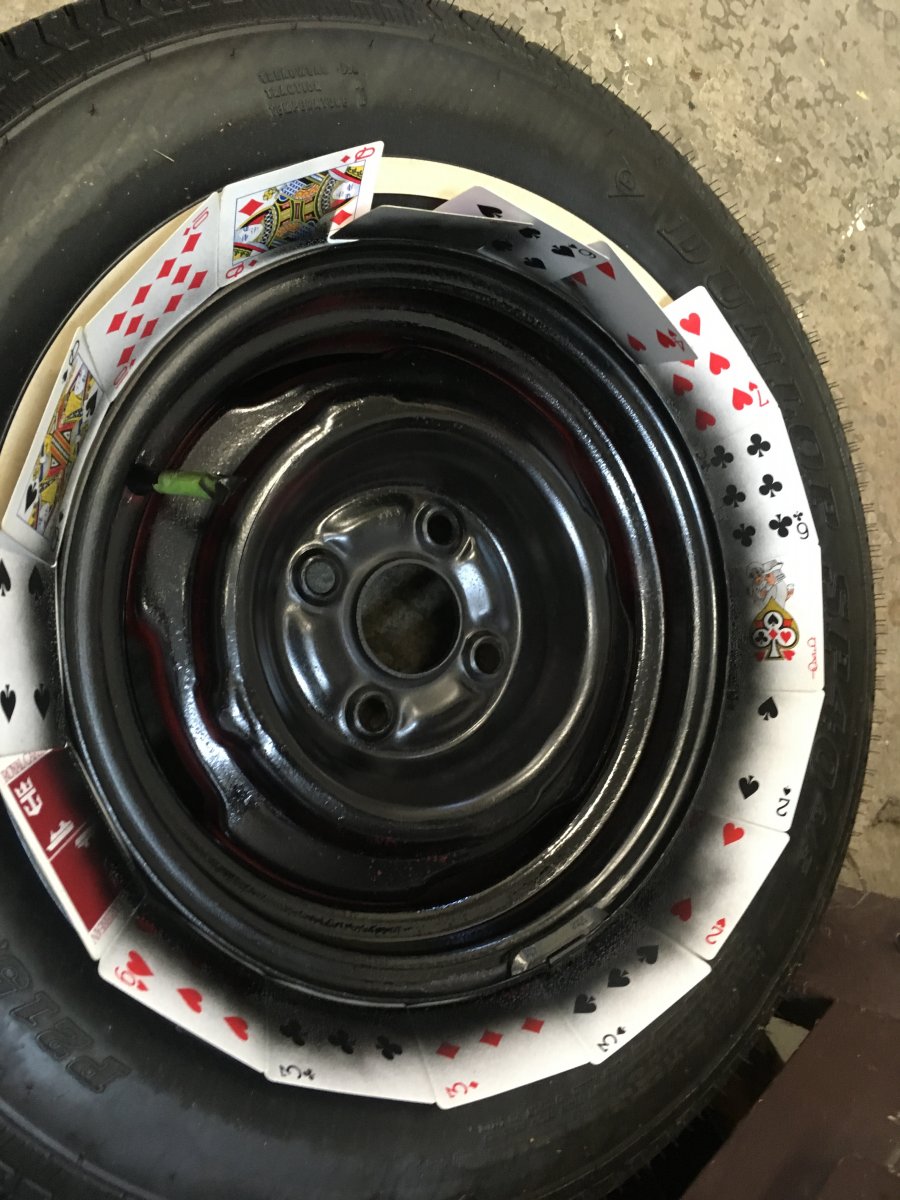

    B0596ACA-7EB3-4792-A876-A61EF943900B.jpeg 30AD5F77-DD35-4A99-9773-6A7BA2D5A60E.jpeg Bringing up an old one.
    Saved much time not having to remove from bead or mask.
