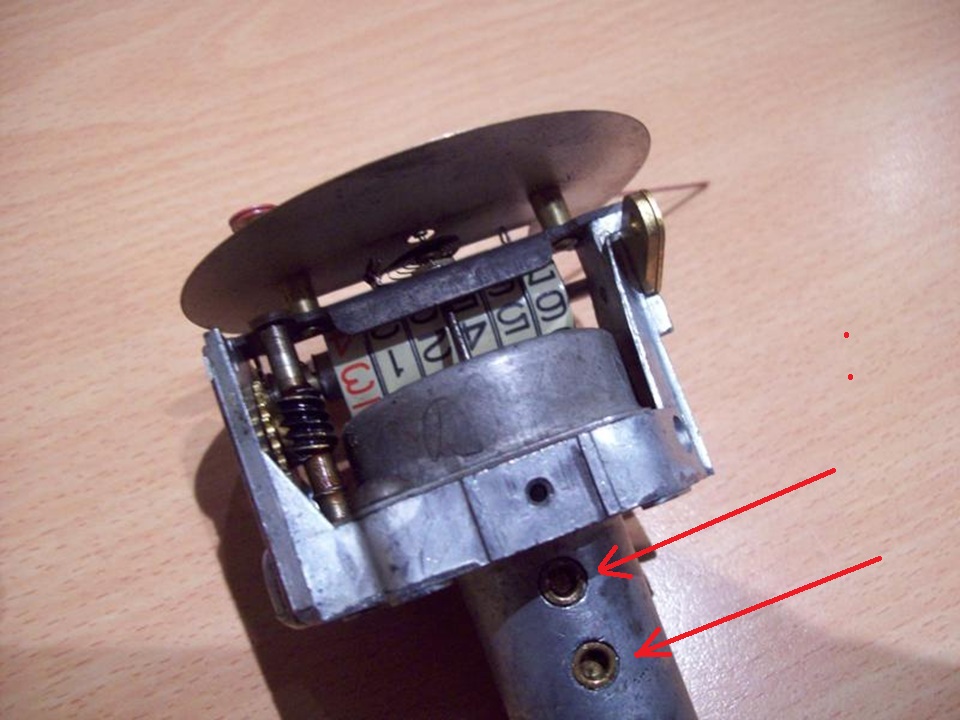

    My 57 was doing that, it wasn't the cable but the speedo itself. The 57 speedo has a little sponge bit that holds oil, accessible by pulling out a tiny plug. That was dry on mine. Have to pull the speedo and partially dis***emble it to get to it. If your car has the same, definitely needs to be reoiled.
    squirrel and 34 GAZ like this.
  9. These little plugs are on most old speedo's. Pick/pry them out using something with a sharp point or a new stanley blade. Don,t stab yourself :eek:. Then pick out the little sponge with a needle . Few drops of sewing machine oil to speed up the lubrication or WD40 if speedo is stuck solid. Once everything spins clean up excess oil with a cotton bud. Cotton bud can also wipe the numbers clean. spong in with a extra drop and then little plug in.

  13. I had a couple of stock speedometers that sounded and read like the OP. I ended up lubing the speedo head like this with 3 in 1 oil to fix it.......after I checked the cable first.
