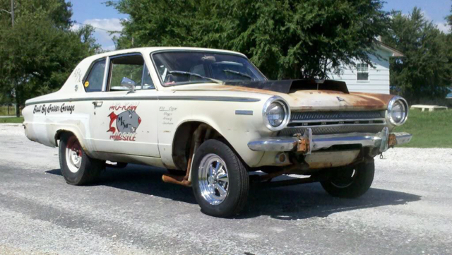

    Rawcjw19. Here is a pic of my old afx dart I made the hood scoop it was a copy of the max wedge scoop this would be era correct and it looks and functions good
    You can get them in fibergl*** but I was cheap and have a sheet metal brake so I made it
