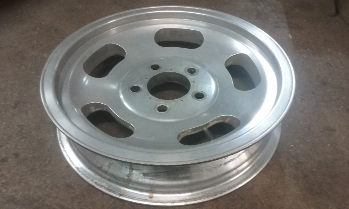

    I think I just took a good amount of unsprung weight off the front end with these 15 x 3.5 wheels, my et 5 spokes are available if someone needs some period correct front wheels. No name on these on the back so not sure what they are? 20161216_122642.jpg

  12. Gammz
    Joined: May 10, 2015
    Posts: 806
    Gammz
    from Lincoln Ne
    Bolt pattern.?
  13. 55chieftain
    Joined: May 29, 2007
    Posts: 2,197
    55chieftain
    The only inserts I have are centered and that makes them 4 3/4.
  14. saltflats
    Joined: Aug 14, 2007
    Posts: 13,576
    saltflats
    from Missouri
    What are you going to run for tires on your new front runners?
  15. 55chieftain
    Posts: 2,197
    55chieftain
    I really like the look of the moroso drag specials. debating on size but think will go with the 27 7.10 15 , minimum rim size for those is 3.5 so should be good.
    loudbang and Tickety Boo like this.

  18. Look like Fenton Gyro's
  19. Cool rims. I have the same ones on the 66 chevelle. A perfect period wheel.

  21. Gammz
