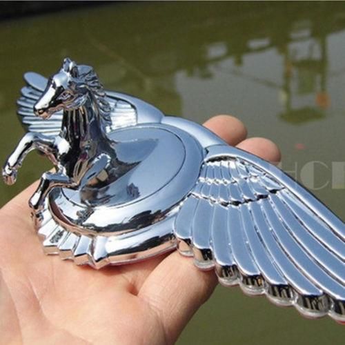

    I'm adding this hood ornament also, I've had the chrome part as long as I've owned it , but picked up the insert that will be lighted . not sure if it belongs on a g***er or not but have wanted it since I got the car. should make for a neat pic at the starting line for the night races with only the Indian head glowing. 20161220_132246.jpg 20161220_132233-1.jpg

    That's bad ***!!!

    I have been thinking about this one...it sort of looks like an Austin logo eating a pony.:p;)
