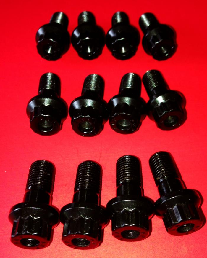

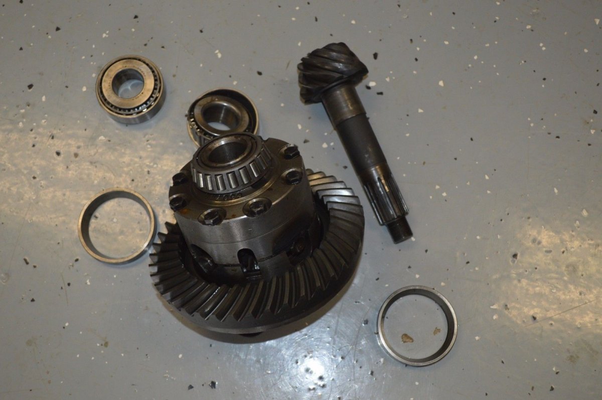

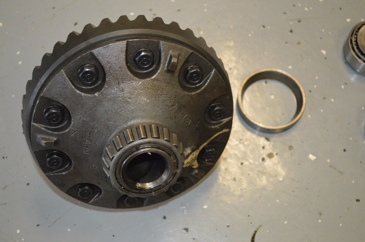

    Started on the rear end in my 55. Took the center section apart and it looks really good. Basically, the only part that broke last July, were the ring gear bolts. The ring and pinion look OK, as does the P-case, posi unit, and bearings.
    Since it was a 3 series posi, with 4:88 gears, I was using a spacer. This was actually a good thing, since about 95% of the damage was to the spacer, with basically no damage to the posi unit. The spacer was really chewed up by the snapped off ring gear bolts.
    Instead of just getting a new spacer and ring gear bolts, an (almost), NOS 4 series posi unit was bought......Along with a set of bearing cap girdles, and severe duty ring gear bolts.
    4 Series Posi A.jpg 4 Series Posi B.jpg Bearing Cap Girdles.jpg Ring Gear Bolts..jpg
