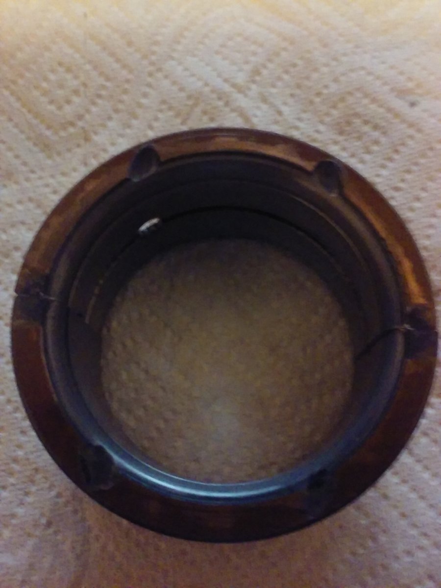

  1. all good tips on setting up a crank. i do one extra step when i put in a crank. i use a heavy plastic hammer and tap the crank front and rear a few times setting the thrust bearing. then i check the end play. sometimes the thrust needs to be sanded on a flat surface to get the right end play.
  2. the caps have shiny spots so they are moving around. the bearing halves are rubbing on each other. the bearings show some black death. the thrust looks worn out. i would say the crank is moving around so much that the oil wedge is at times being lost. this creates heat and wear. the parts tell a story. my thoughts are the caps or the registers in the block are shot. with the studs out do the caps move side to side?

    from Wisconsin
    Wiped them down and bearing side thrust areas look good. :)
    Measured a new bearing against used all have .090 wall thickness. side 1.jpg side 2.jpg new side.jpg

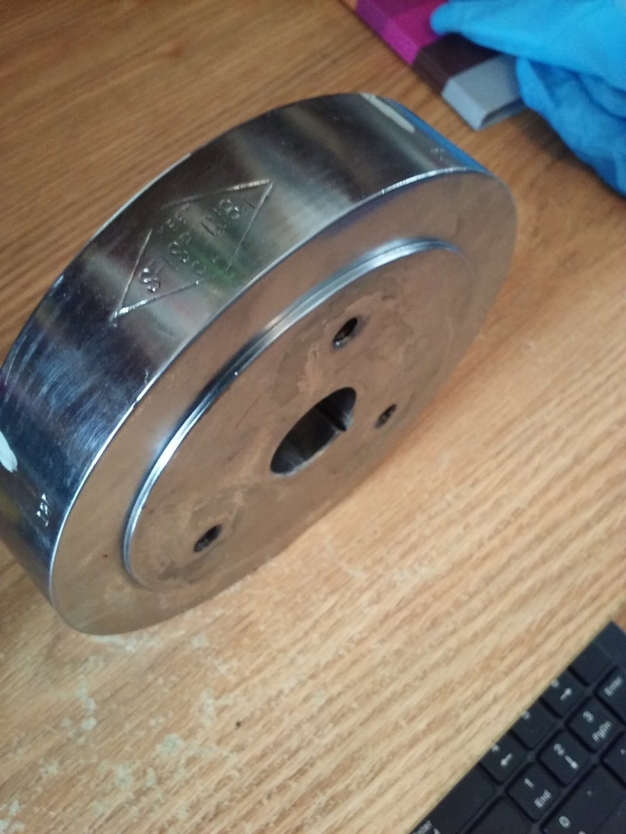

    damper.jpg James
    Running a 6" Fluid damper, also some feel that my Summer Brothers gear drive may cause problems.

    Machine shop thought most of the problem was dirt in bearings, he said the Clevite 77 H bearing is dark
    from heat treating new. The pictures are darker, ( what looks black in pics is really dark gray.)
    He felt that Honing with plates will solve the ring problem.
    ( this was not done on original build )
  11. Watch out for those Fluid dampness, sometimes the fluid goes hard, and turns the dampner into an unbalanced crank breaker.
    loudbang and powrshftr like this.
  12. I have the same main bearings, the H's I think, they come looking like someone waved a torch over them until they get blue'd.

    I've heard that from more than one guy up here.Temperature drops,and they solidify.

    Is there a way to test a fluid damper?
  16. well that's good news. I use the same bearing and they do look like **** right out of the box. when you get it back still check the cap fit just to be sure.

  17. saltflats
    Joined: Aug 14, 2007
    Posts: 13,597
    saltflats
    from Missouri
    I would go wit an ATI super damper. I have read good thinks about them but then I am just reading this now so.....
    loudbang and Tickety Boo like this.
  18. If it was bad, the engine would probably shake like a dog ****ping razor blades. You could ask the balancing dude to check it out, when he re-balances your ***embly, with the new pistons etc.
