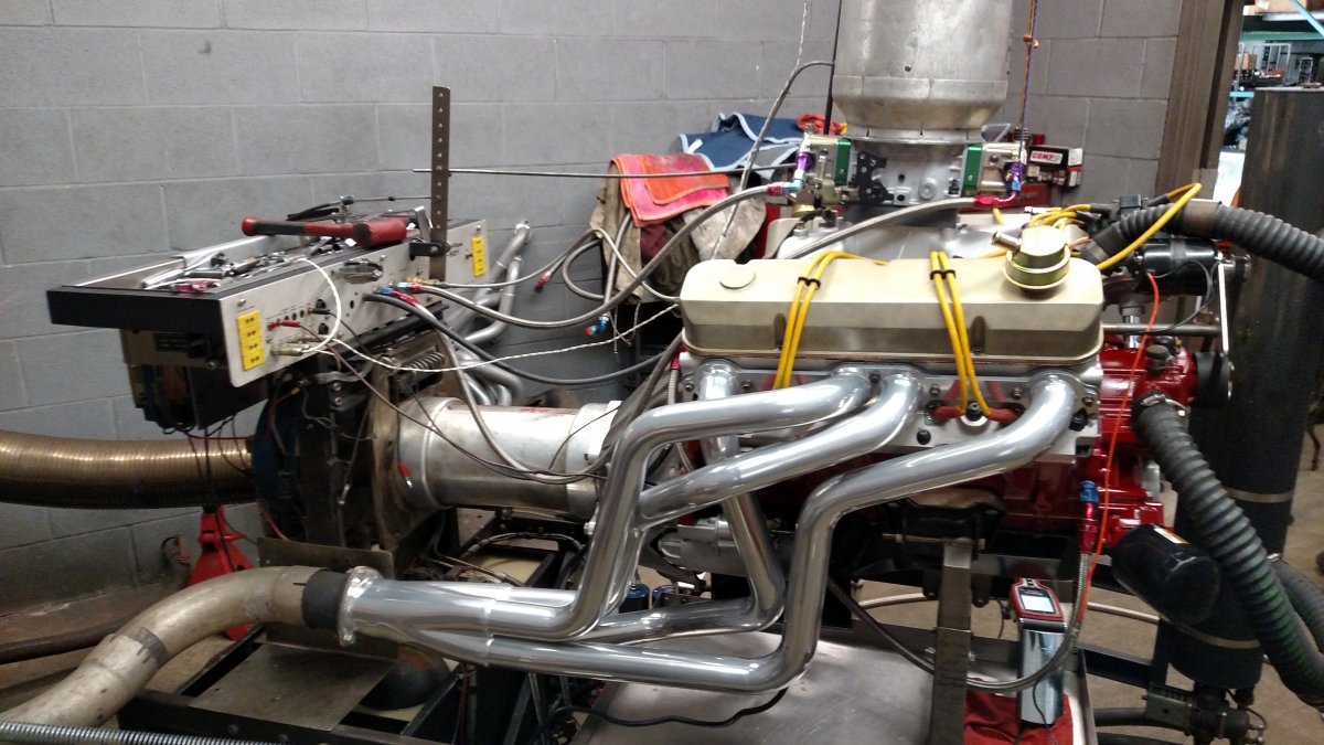

    Dynoed the new 464 for the Hemi Hunter yesterday. 703 HP at 6400, 626 torque at 5100. My poor stude is not gonna know what hit it. Gotta get busy and load this bullet in the chamber. Gonna be interesting with the altered wheelbase. IMG_20170608_153412856.jpg
