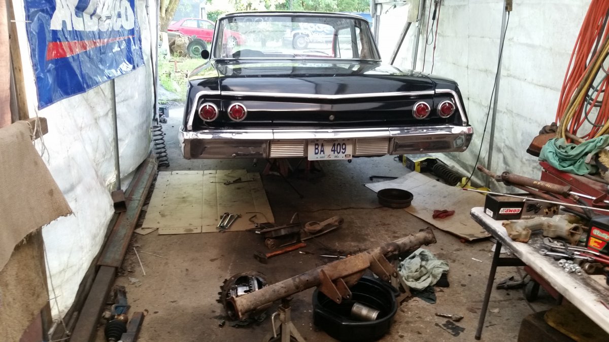

    I took out the ring gear bolts.
    In the replace the rear end now mode.....see no need of fixin it be just beatin a dead horse.
    Now I can step up to a 3/8 fuel line.....better look out!!!!

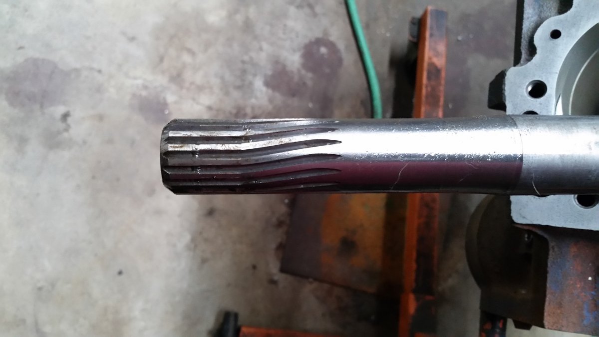

  21. saltflats
    Joined: Aug 14, 2007
    Posts: 13,579
    saltflats
    from Missouri
    This is what the left axle looks like......kind of sealed the deal.
    loudbang, 30dodgeboy, racer-x and 5 others like this.
  22. Deuced Up!
    Joined: Feb 8, 2008
    Posts: 4,224
    Deuced Up!
    I like the license plate James, what does that stand for...Broken *** 409? LOL
    Sorry couldn't resist, looks like you have it well in hand though!
    62Furious, loudbang and saltflats like this.
  23. saltflats
    Posts: 13,579
    saltflats
    from Missouri
    It does now but when I get it done it will stand for Bad *** 409
