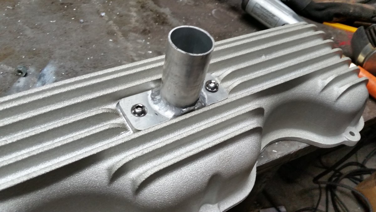

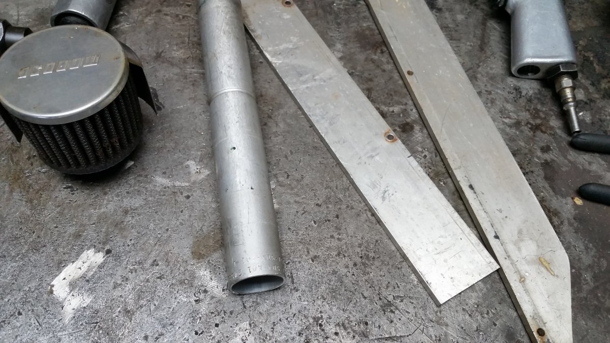

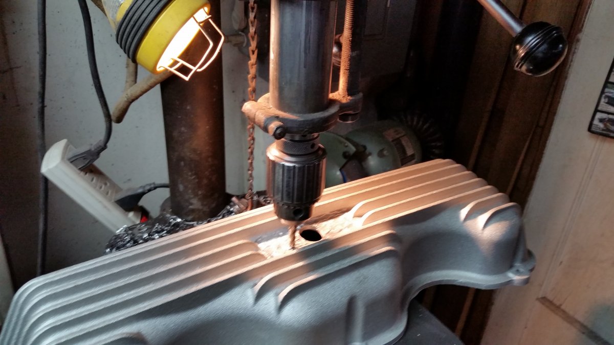

    Looks real pretty doesn't it I hate to do it to those pretty imperial covers but I'm gonna have to put some breathers in anyone got some they want to part with and yeah I'm being picky and want some early ones that match the era
