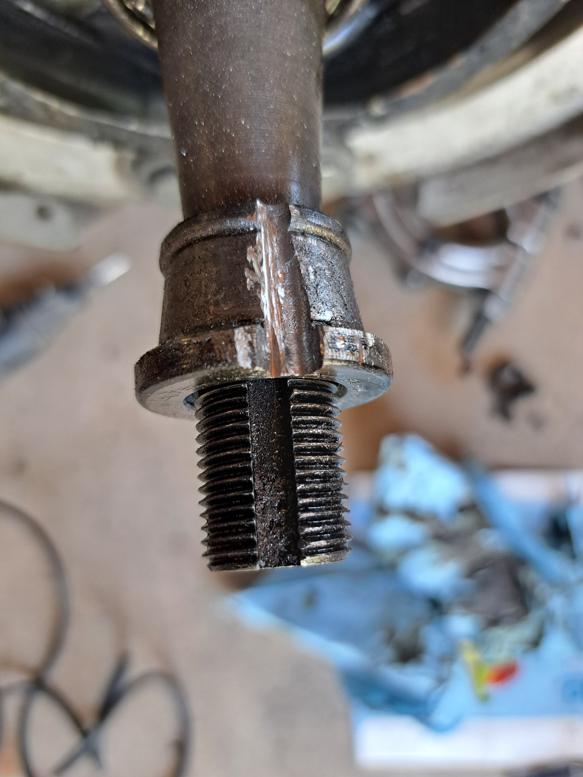

    I'm super bummed about this because the biggest car show of the year is this Saturday. I was driving my 32 roadster yesterday when I heard a noise coming from the front wheel, and then the car pulled in that direction. I pulled over and saw smoke coming from under the hub cap. Pulled the grease hub off and sure enough metal flakes. I got it towed home. Now I'm trying to dis***emble it so I can order new parts asap, to get them installed for the show. I can order new spindles so that's not the biggest issue. I can't get the the outer part of the bearing freed from the drum. Both inside and out. I've tried heat, and a big hammer but they're not budging.
    Any suggestions. Can I get new drums? I can't seem to find them online, and I'm sure the shipping will be an arm and a leg.
    Also, how the hell did this happen? Everything was greased with hi temp wheel grease. The inside of the drum is packed. But it doesn't seem like there's much on the outer bearing now.

  2. In industrial applications we've often welded a bead of weld, on the inner part (roller area) of the bearing shell. This "shrinks" the OD of it, an the shell is able to come out.

    It was set too tight. Or not packed fully. Grinder wheel is OK,but should be both top n bottom=the heat from grinding,most of time,lets it losen up. If not two BFH,one bang from each ;at same time from each side often pops it. So spindel is saved/as long as spindel nose can clean up OK,an new bearing feels right..

    I'd take a good sharp heavy duty chisel and a 2-1/2 lb hammer and split the inner race right where you made the cut. Or if you have a Dremel tool or clone with cut wheels you can make a better controlled cut from that spot. just cut through the bearing and you should be able to knock it loose after you have a slot all the way through it. Burnt bearing.jpg

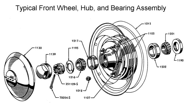

    This is good info. Thank you guys. This might be a dumb question as I'm new to this car. But does the outer roller stay in the drum? I ask because on the diagram it shows it as a separate piece.
  6. Item 1217 and 1202 are the cup portion of the bearing. Yes they are removable, there is often a notch in the hub, where you can get a punch on it, to help drive out. If not, narrow punch, catching the lip of the cup race, will knock it out. You're driving it out, from the backside of bearing.

    They're frozen in there pretty hard. Tried some heat and a chisel and hammer. Didn't budge. Would you suggest to keep working it or leave it. They seem undamaged. Maybe Ill do that after the car show.

    Heat stuck it there; heat shall set it free. I'd put the nut back on the end to protect the treads, put a good three fingered puller on that bearing race, crank it down tight and then hit it with the blue tip wrench. Have a buddy keep tightening the puller.

    A dial driver to knock out , a bead of mig weld 1/4 to 1/2 around race / cup it will fall out after cooling

    While that would work; in this case the bearing more than likely spun and tore into the spindle some. If you split the bearing, you may have a better chance of filing & sanding down the spindle without possibly doing more damage if you drug it back off over the spindle.

    If you have a welder, or a friend with one, the easiest way to get the bearing races out of the hub is to run a couple short beads in the center of the race. When the weld cools it will shrink the race.

    I’ve recently repaired 2 different cars with almost welded front bearings. Each was owner installed, new to old cars . They installed the bearings as they came out of the box . Never knew that they needed packing . They packed the cavity between the inner and outer bearings.

    I , too have used a torch op for this. Get the bearing metal hot and melting, then pull your torch away from the bearing while still melting it. This will keep the torch from cutting the spindle!
    Back in 1979 I was hired by the Muskogee Fire dept, shortly I was promoted to Master Mechanic. Several months in my job , I had to cut some seized bearing out of a pump transmission! I did not know it at the time, but the Chief came into my shop and saw the new kid inside one of the newest fire engine with a cutting torch! Years later he told me he just went back to his office to figure out how to buy a new fire engine! Then he told how happy he was to see that fire engine working agian in a few days! lol

    Re the inner race. The heat has probably softened the bearing material so it will not crack like a bearing normally does when first grooved with a grinder and then hit with a chisel. It is too pliable. I would carefully weaken it as much as possible and then try and chisel it off, all the time being careful not to damage the spindle. Looking at it you are lucky the whole lot didn't weld itself together and twist the end of the spindle off.
