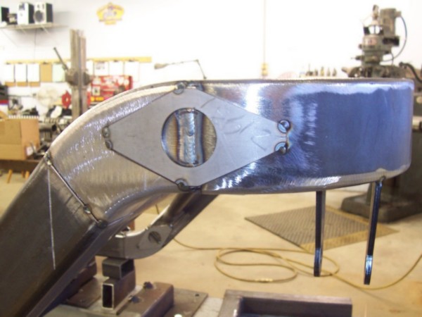

    One of the nice things about hot rod parts is that they don't know what they do. A rear four bar bracket, for instance, doesn't care that it's on the inside of the rail, on the outside, or in this case, on top of the frame rail. We're using one of our standard Model A rear four link kits with the frame brackets mounted in a bit of an unconventional way.

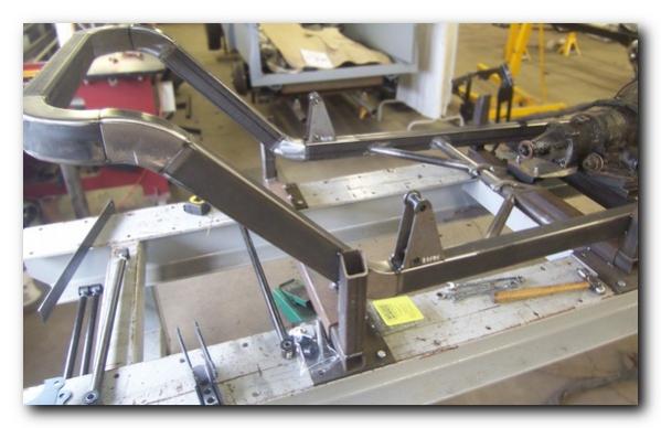

    Since the rails are not parallel at the rear, we supply the kit with 5 degree adjusters so that the axle brackets can mount outside the rails and the bars are aimed towards the bracket. We really only needed to measure the wheelbase - once the bars are ***embled and connecting the axle brackets and frame brackets, all you have to do is square up the rear end.

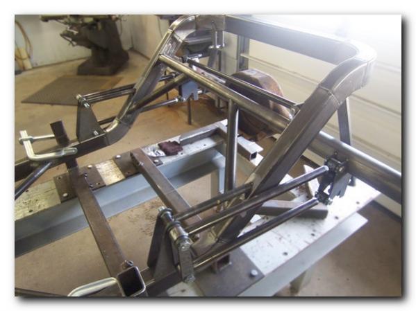

    At this point, we decided we wanted the pinion centered. It's also easy to tweak the wheelbase too, by sliding the whole ***embly forward or backward along the frame rails. The bars should be horizontal at ride height. We haven't quite determined the width of the rear end, so we're going to leave it for now so we can match it up nicely with the box.

    This picture is a bit misleading at first glance... ultimately, we wanted the pinion tipped 'up' about 3 degrees off of vertical. If you haven't already, read Inland Empire Driveline's setup guide. Grant made a neat, simple fixture that looks like a ruler with two holes in it. It picks up the top and bottom pinion studs and has a straight edge between them at pinion centerline. This is really handy for centering the axle brackets.
