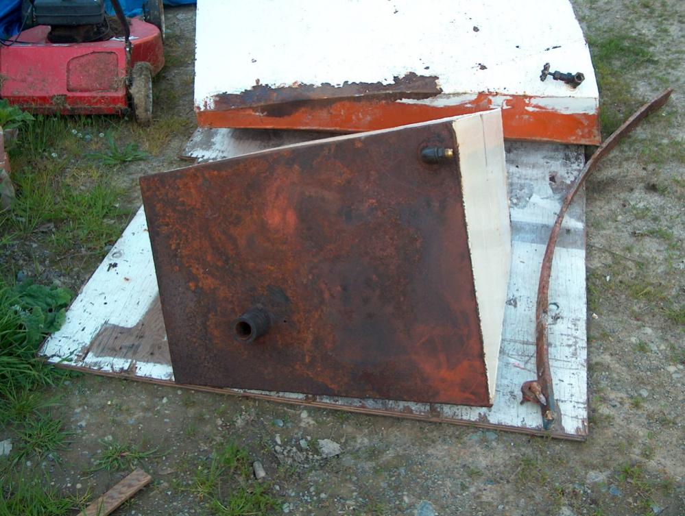

    not to hyjack your thread, i have fixed a few gas tanks, the largest was a 5000 gallon tank i cut the end out of the make a cement sylo, that one we ran diesel exhaust into for a few hours and then used a sniffer to check for fumes, and still i had to overcome some shaky nerves just before the torch made the first cut, but all went well, the gas tank on my 55 fairlane was like swiss cheese on the bottom, i removed the tank and carefully cut the bottom out with tin snips, i have yet to weld a patch back on, two days ago a guy brought a couple diesel boat tanks to my shop for repair, looks like i have to cut the top right off and replace them, so i ask, what would some of you guys do before cutting the tops off with a plasma, anything?, will diesel explode when not under compression
