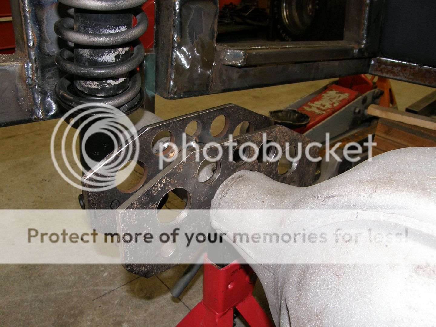

    Land Rover Discovery trailing arms.....................
    How about if I lay 1-1/2" welds, alternating on each side and let it cool 20-30 minutes between welds? 5/16" plate to that paper thin axle housing, I need some pretty intense heat!

    The cooling time may help, but ultimately it is down to the total heat in. Better to accept this and work with it (by welding or heating all the way around) than try to fight it.

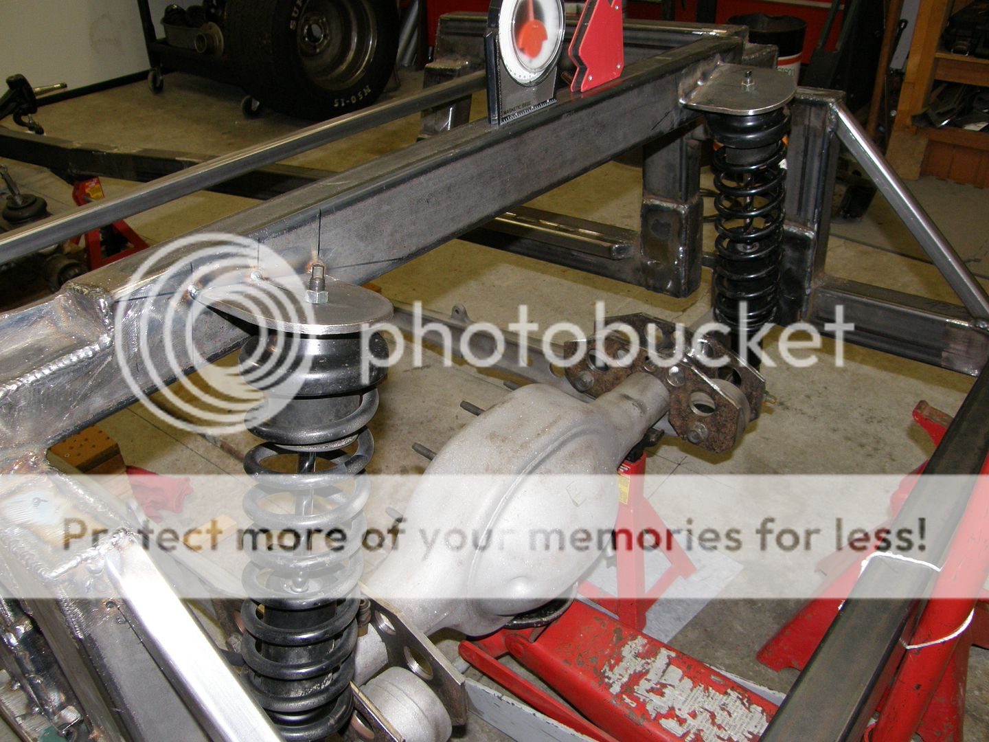

    1200 lb Model T roadster.
    I don't think it's necessary. It's a very small/light car and it'll be powered by a turbo'd 4 cyl. The frame is overbuilt and every stress point is fishplated.
    Yep!
    I'm building this car for next to nothing and that's what I had available.
    First, I'm gonna check around to see who can do it and how much to true the housing up after the welding. The housing will be securely clamped to the frame table. Rags soaked in ice water wrapped around the housing on both sides of each bracket. Short welds, alternating to each side with adequate cooling time between welds and welding all the way around the housing. Not much more I can do! I'll post results when it's all said and done.

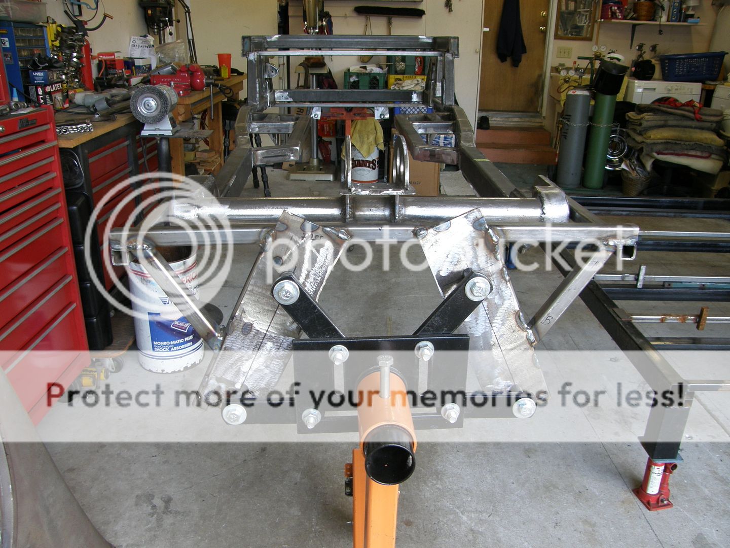

    I finished the rearend housing today. Took most of the day. I clamped the **** outta the rear to the frame table and wrapped the tubes on each side of the weld with rags soaked in ice water. Then, I'd weld a 1" bead, blow it with compressed air and let the tube cool to the touch. Alternate to the other side, do the same thing, then alternate back. Took awhile but the axles and bearings still slide in quite well. Don't think I warped it at all. I checked on having the housing trued up and the guy was talking $200-$300............not!

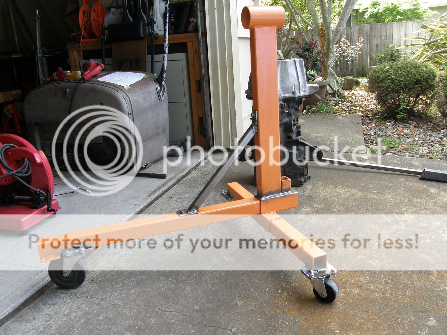

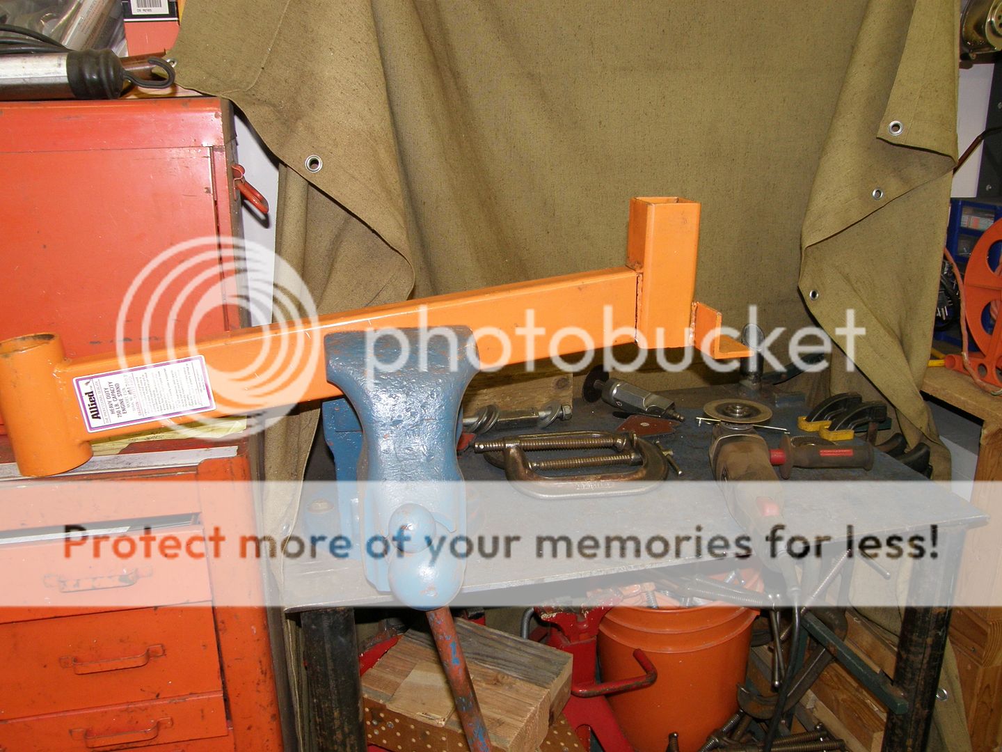

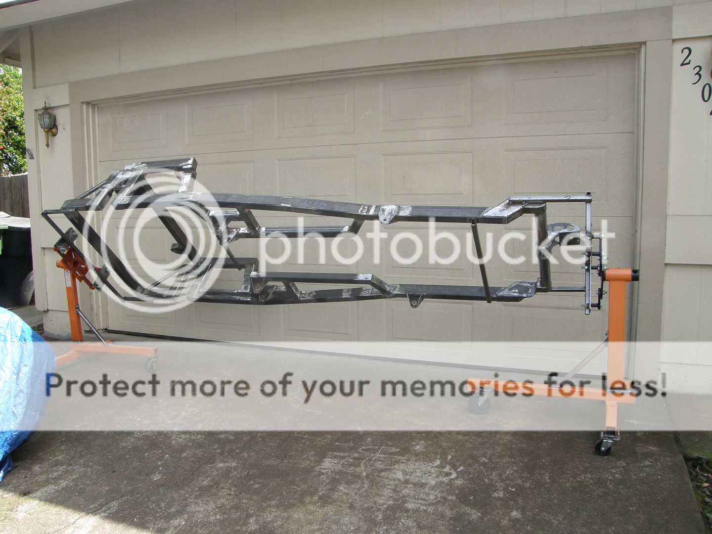

    Slighty OT but I also threw together a quick and dirty frame rotisserie. Had a couple of those funky HF 3-wheeled engine stands laying around. Had to make a couple of mods. The main bars needed to be squared up, I made a removeable brace and added swivel casters.
    Built some mounting structures outta 1" square tubing and s**** metal, tacked 'em to the frame rails and bolted 'em to the engine stand heads.
    I was gonna add a stick of tubing between the 2 stands but this thing is stable and rolls great so that wasn't needed. Now I can flip it when I need too and roll it into the backyard for blasting!
