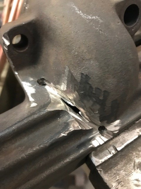

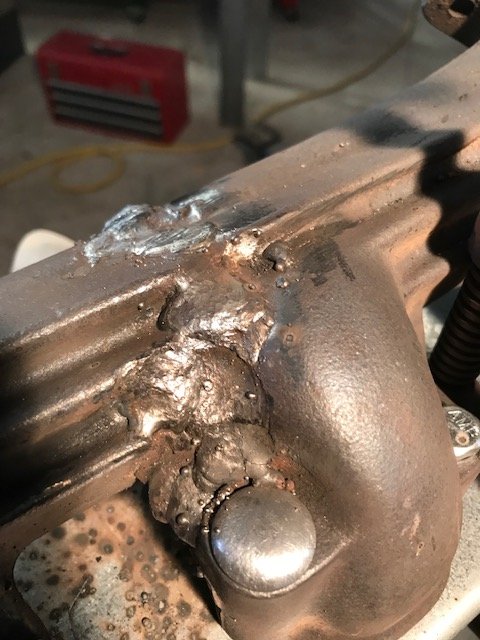

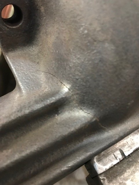

    Here is my first attempt to MIG weld a cast iron exhaust manifold. IMG_2800.jpg

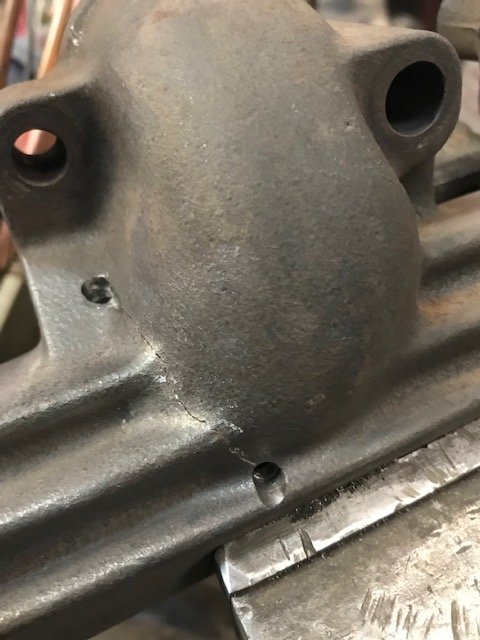

    Here is a small crack.
    I marked it with chalk

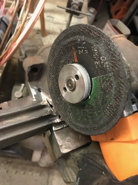

    I drilled a hole at each end of the crack
    I used an angle grinder to cut a notch to accept the filler wire. The filler wire was a stainless steel alloy wire ER308L. I used the gas that I had: Argon 75% and carbon dioxide 25%.

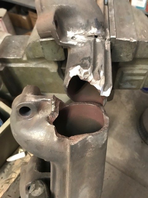

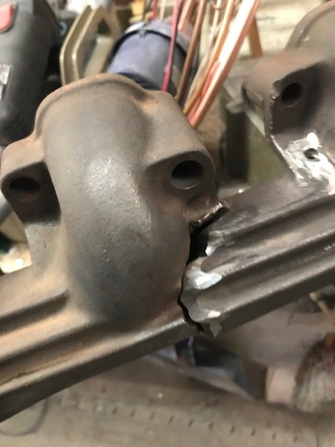

    Here you can see the tough part; the exhaust manifold was cracked in half.
    I ground the edges of the break at a 45 degree angle for the filler wire and checked for alignment. See the next picture.

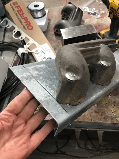

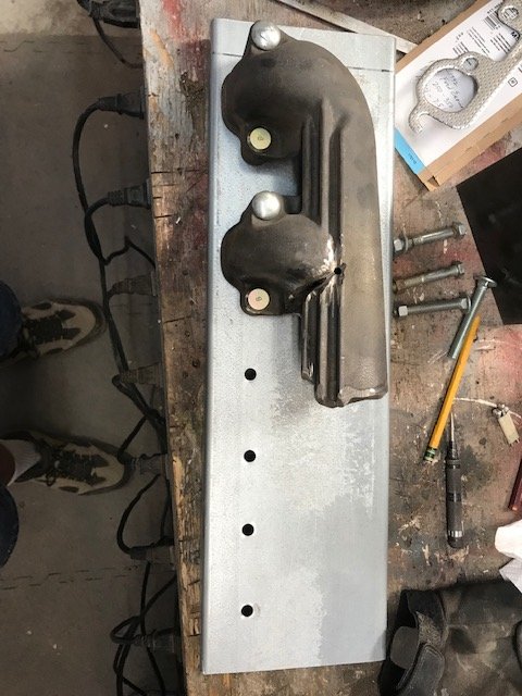

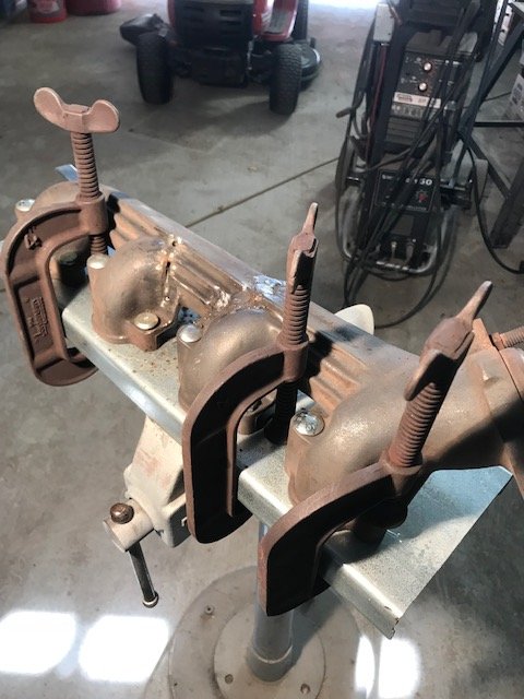

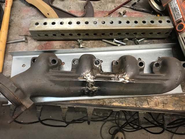

    I had a heavy piece of commercial grade 2x6 framing steel that I used to align the two pieces. I drilled the holes according to the exhaust gasket. I should have drilled the holes as large as the holes in the manifold for proper alignment. But, I used smaller stove bolts to attach the manifold to the steel stud.
    I bolted the manifold to the steel stud.

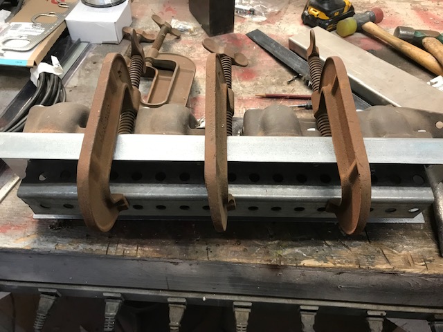

    Then I used a 2x2 piece of heavy wall square tubing and used C-clamps to stiffen the clamped ***embly, since I guessed that welding the manifold might cause the ***embly to warp.
    Another view of clamping the ***embly.

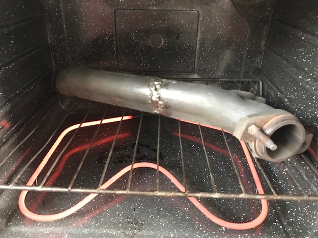

    I heated the ***embly in an electric oven to 475 degrees for about half an hour.

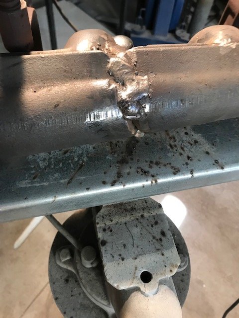

    Then I held it in a vise and started welding.

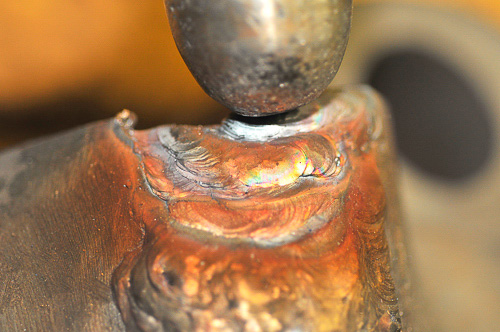

    I welded about an inch at a time and then tapped each weld 40 to 50 times with a somewhat rounded tip body hammer. Someone told me this is called "*****ing" the weld. Maybe some call it peening.
    I forgot to take a picture of peening the weld so I borrowed this picture from the Web. There was no rust on the piece I was welding.

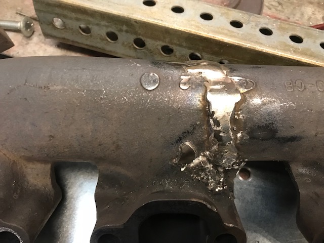

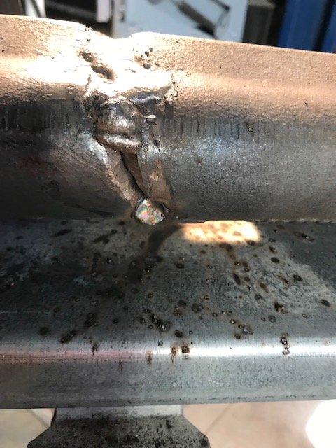

    A view of my amateur welding.
    Another view.
    About a third of the way through the welding, I reheated the manifold ***embly to 475 degrees. After another third of welding, I reheated the ***embly again.
    After welding all that I could reach, I removed the manifold from the 2x6 and welded the backside of the manifold.
    When the welding was complete I reheated the manifold to 475 degrees and left it in the oven for several hours for it to cool to room temp.

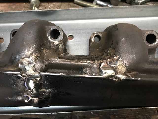

    Ouch. More amateur welding.
    More ouch.

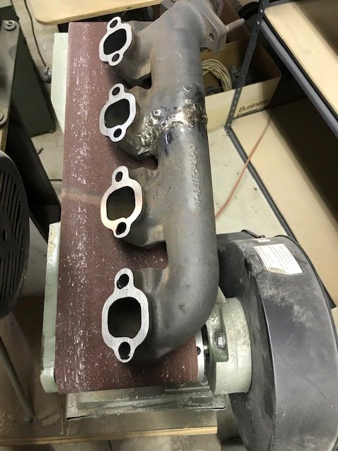

    Here I started to grind away my embarr***ment.
    I finished by surfacing the manifold on a belt sander.
    While installing the manifold I discovered that one of the end holes did not align properly, so I used a die grinder to elongate the hole by about 1/16 of an inch. The manifold has been on the engine for more than a month, having run the engine to operating temperature several times, and NO leaks. This job made me sweat, but thank the Lord He guided me.
    Oh, by the way, I was looking for the stainless steel wire on eBay when I had the thought to check what I had. Low and behold, there on my welder was exactly the wire I needed. I must have picked it up at a garage sale years back. What a blessing.

  5. You do know that they make a special nickel stick rod for welding cast iron, right? That MIG weld will likely just break again after some heat cycles...
    Rich S. and flatheadpete like this.

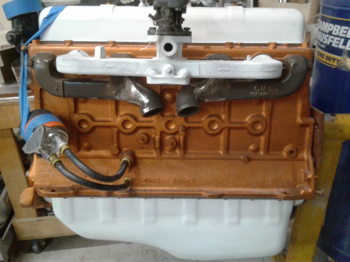

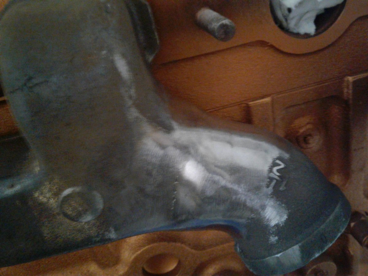

    My take.
    Mig welder.
    Crown Royal nickel wire 80$/2 lbs
    The rest regular mig wire 25/75
    20171116_215119.jpg 20171116_211901.jpg 20171116_211951.jpg 20180321_201515.jpg

    Looks like you did your research before you started. Good job with the pre-heat and maintaining the work piece temperature. Stress relieving the weld by peening was right on. Attaboy!!
