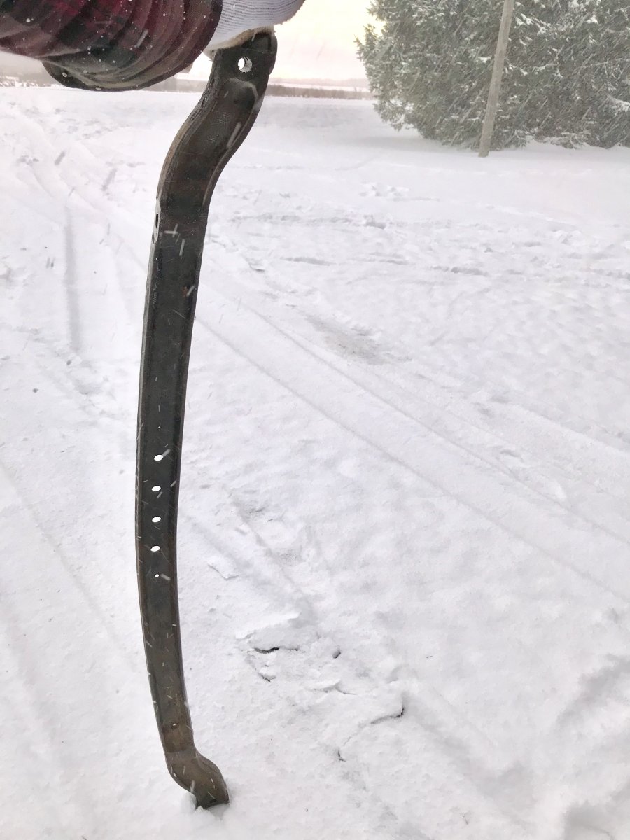

    Hey fellas , I have a partial drilled axle , and was wondering if it’s gojng to be a problem with heat to mig ( I don’t own a tig) the holes closed ?
    ( prefer undrilled)
    I shouldn’t need to make a jig should I ?
    I just want to be sure I don’t ****** it up. Thanks

    Welding those wouldn't leave me with a great feeling of security, always wondering if it compromised the integrity of the axle. They're small, so how about filling them in with some epoxy, smooth and paint?

    I ***ume that's an original axle? If so it is forged steel and you can weld the holes closed without any problems.

    I would suggest to pre-heat the axle before welding. When finished welding wrap in fire proof cloth and let cool sloooowly.......just to be safe.

  8. Plug them.Hide the plug. No weld no heat worries.

    Those holes are pretty small I don’t see any problems with welding. Weld it, grind the welds with some finesse so you don’t make things too ugly and finish any lows or pin holes with your favorite filler.

    I'd drill slugs, insert, weld, grind flush. But I live on the edge...;)

    I would check it for straight after welding. Weld equally on both sides.

    I've welded holes that small in forged axles before. I preheat the area and tig weld with mild steel wire to minimize any porosity. I back the hole with a piece of br*** when welding. Let it cool naturally, don't rush it.

    Having done this several times in much more extreme cases (1” holes all the way across) in your case, I’d just hold a block of br*** or copper behind the holes, crank your mig up, and weld them closed. Should only take a few minutes to carefully dress them to invisibility with a die grinder or small flap disc.

    Well the guy who actually does it for a living gave you the right answer from my viewpoint and that is pre heat it, weld it up and let it cool. I'd be finding some bolts that were the correct diameter to fill the holes and cut some plugs to fill the hole and do a lot less welding.
