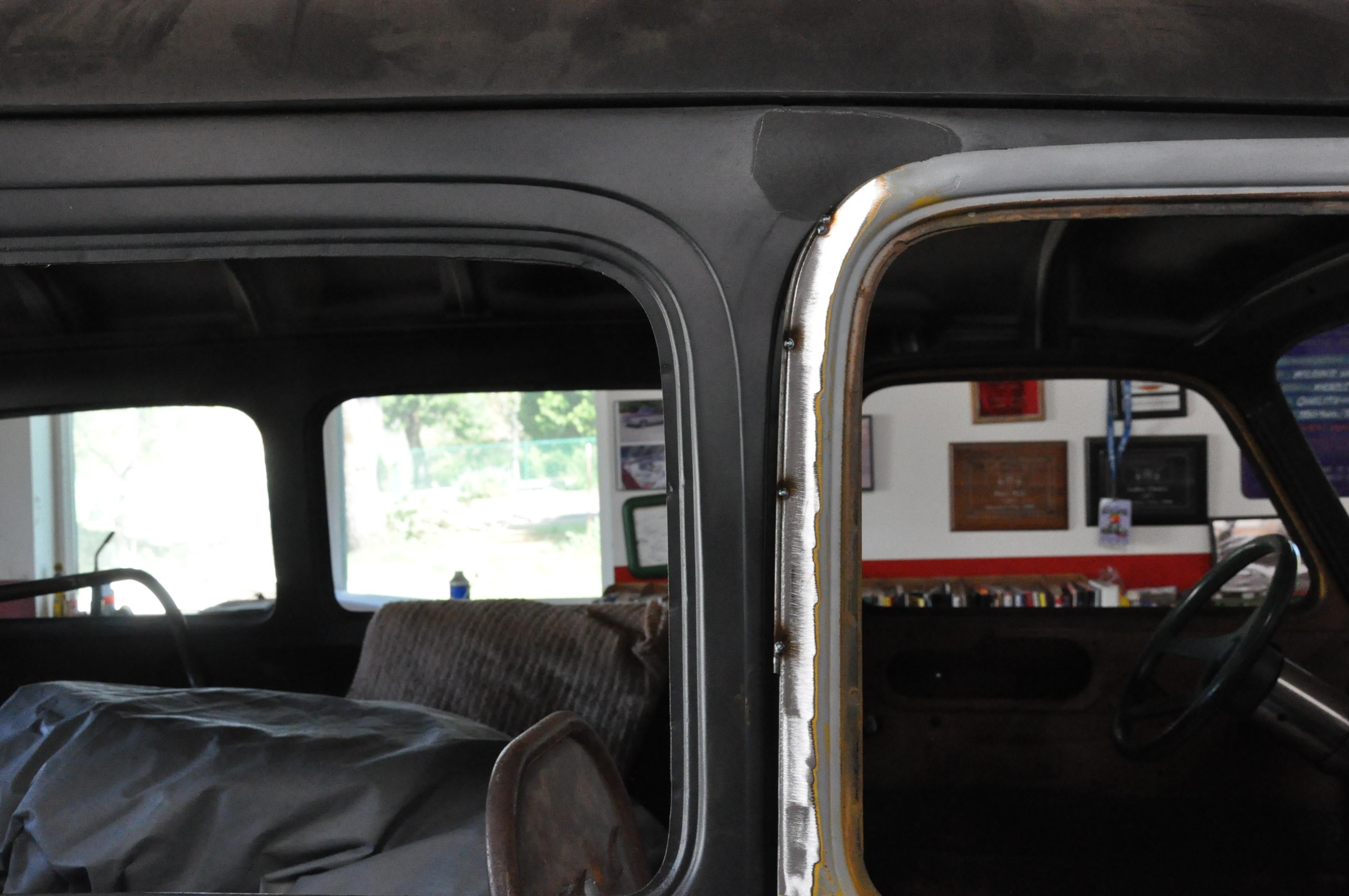

    Using a filler rod about the same size as the edge of the door.. tack it on grind it down.. takes time but works great.
      490.1 KB
      610
      437.7 KB
      611
      463.5 KB
      499
    reagen likes this.
