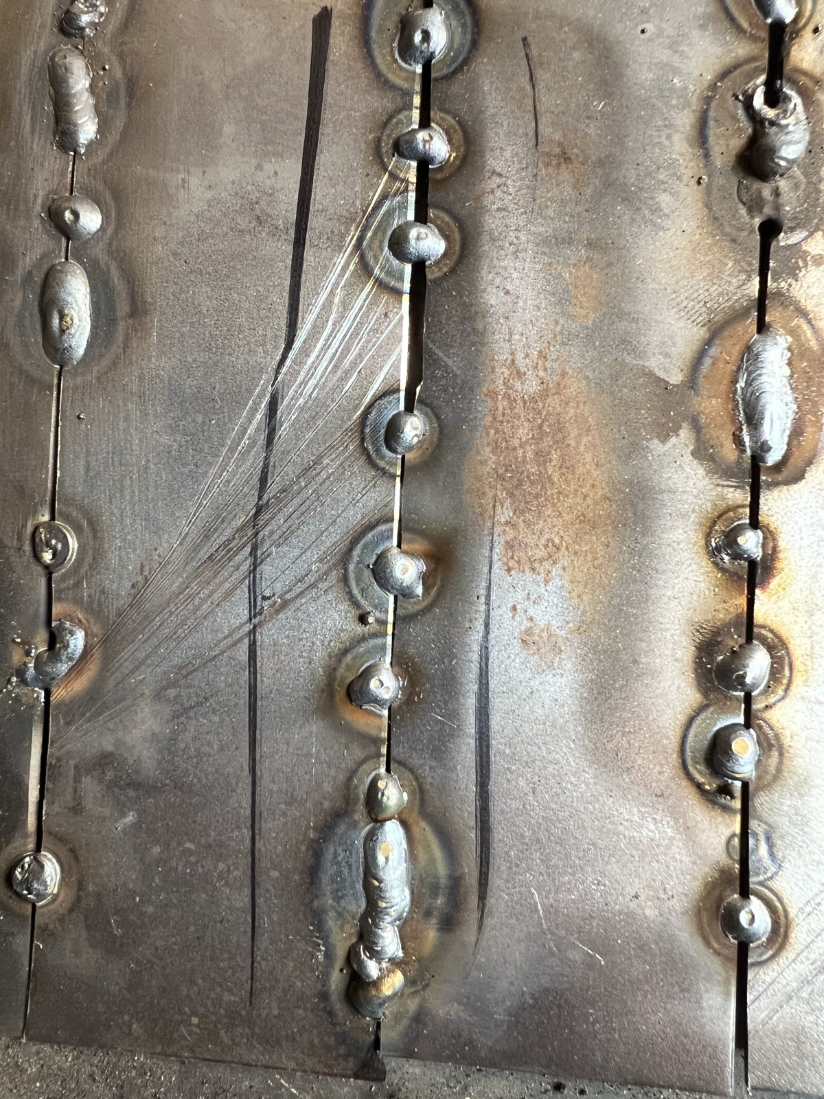

    The liners will often get damaged right at the handle end where you grip the lead. That area is often the place it gets flexed too much, the most often. Also plan on replacing the tip, if the wire balls up at the rollers, the wire feed stopped movement has most likely damaged the tip. I have replace more tips then I have ever replaced liners. When you replace the tips, run the wire out of the lead about 1 1/2" then slide the tip over the wire and screw it in place, then cut the excess wire off. I do this every time I replace a roll of wire as well.
    Looking at your pictures, the metal appears to be clean enough. unless the metal has a coating on it (which needs to be removed if present), the metal itself is not likely your issue. There was also a comment about welding the different gauges of metal between 16 and 18/19, that minimal difference in the gauges of the metal is also not your issue. Get the welder set up so the wire feeds smoothly and do lots of practice, you will either get it, or you probably won't ever get it.
    Also, I sure hope you do not intend to try to fill the gap below the two sideways tacks without some kind of a backer. I have lots of years welding sheet metal, I would not attempt that one without a backer, then it would still be border line.
    I have done a lot of automotive floor pans over the years. Floor pans are a great place to learn welding skills, because they are nearly always covered and out of sight. That said, very few floor board welds I have done were ever **** welded. Even the auto factories overlapped floor joints.
    As far as floor board welding was concerned, if the "new floor pan" was joined at a factory joint, I drilled the holes and did the plug welds. If the weld was where a sheet of factory metal was cut, I would flange the original pan and weld the new pan over the top of the flange and the new pan edge was fully welded (move around as it is done), then all the seams were seam sealed above the floors.
    I often welded floor pans in snow plow trucks in the rust belt. In 25 years of doing it, anytime the floor pans needed to be replaced a 2nd (or 3rd) time, it was always because the new pan rotted out. The flanged weld areas were never bad. I would cut the flange area off and add a doubled flanged filler between the new pan and the original floor. Most floor pans rot out from water sitting on top of them, not from under the vehicle. The few that rotted from the bottom spent much time sitting in water, and most of them needed complete floor pan and structural support replacement.
    The old jute backing the car companies put under carpet for insulation can hold water for 2 weeks after first getting wet, and that wet jute usually sat against unprotected steel.

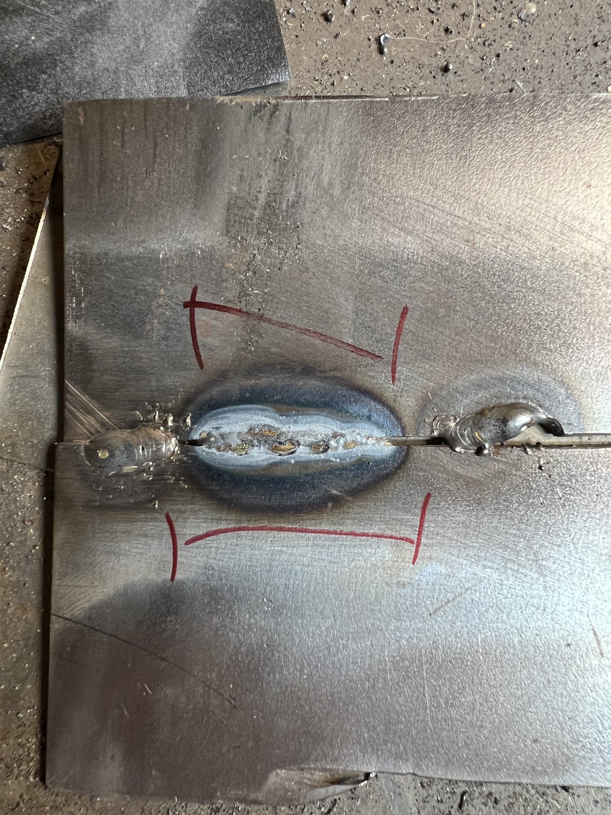

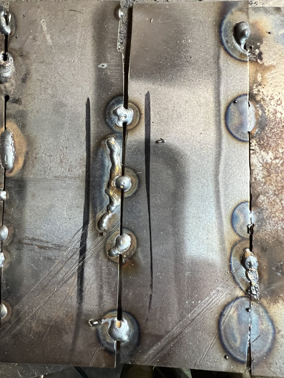

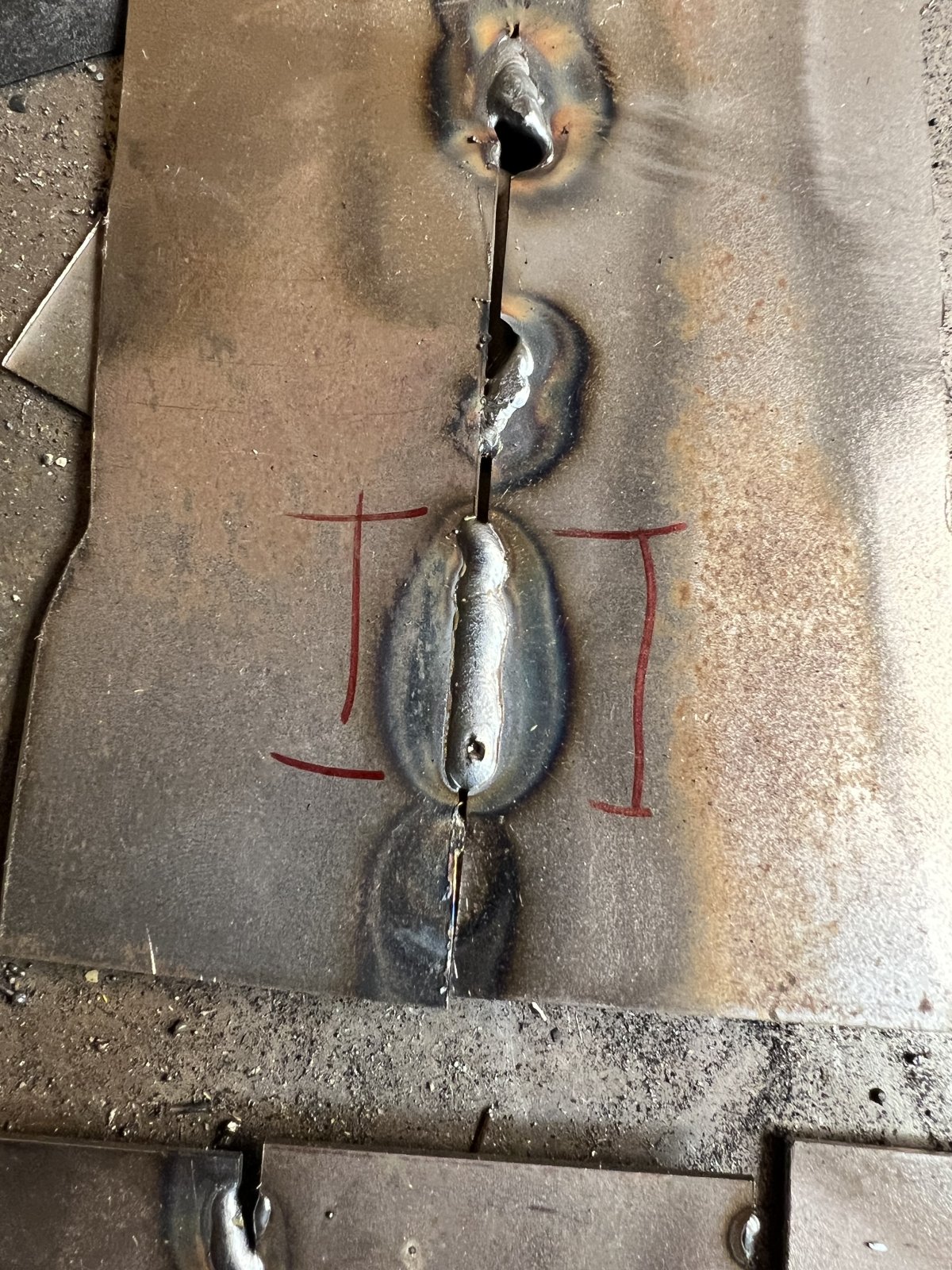

    Well I read through most of this real quick, but that metal he is welding is clean! I hope everything I weld is that clean! Second rough grinding is no problem, the weld will melt it, no problem!
    Also a gap is desirable to get a good weld, but you can get a weld with no gap and not get that humped up stuff.
    Like mentioned, a little more heat, a little less feed, maybe a tad faster travel, and change the angle of the gun.

    Just curious, have you tried to but weld them, or started with a gap and sticking to it?
    I’ve never tried to weld a gap in sheet metal.
    Why did you choose that approach?

    Personally I try to avoid any gap when welding sheetmetal. I can see having a small slit where a cut off wheel was used to trim a panel to fit. I saw somewhere that tilting the grinder/cut off wheel on an angle when trying to match a patch panel to a body, would make the two pieces come together flatly with no gap. Never tried it myself, but it might work.

    gap-no gap depends on your heat and technique you have become accustomed to and what works best with your equipment.

    About those ****py welds.......IF it ain't shiny clean it just won't weld right. (forget that junk about 'burning the paint/rust /OIL out as you weld over it!! Never works!)
    You're not using an extension cord on your welder are you ?? Bad idea. Make sure it is a HEAVY duty cord if so. Too small a wire will make the welder run real cold/erratic .
    Aim the torch/heat slightly toward the thicker metal when welding.
    Last resort.......Gob the weld on and then grind it down.
