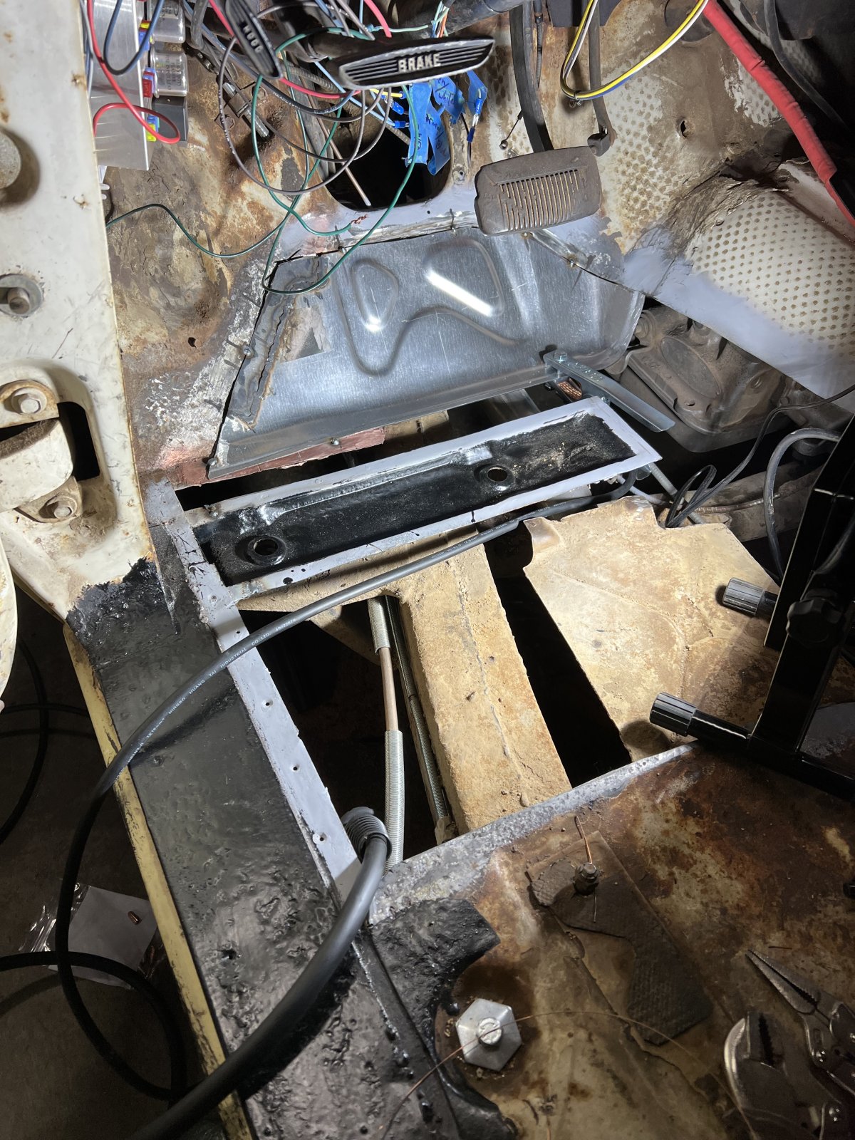

  3. 1930artdeco
    Joined: Oct 25, 2011
    Posts: 786
    1930artdeco
    from Lynden, Wa
    Update: got the toe board in!!!! Starting to spot/**** weld it in slowly. Only ended up with a few blow throughs. Great more holes to fill…….. now I know why you don’t do weld runs on sheet metal.

    Now your cooking, everyone starts as a beginner but having good equipment makes things a lot easier. For me to weld I have to stay focused and take my time.

    Some things can only be understood by experience. Your learning curve has just begun. After you burn enough holes, you will learn how to fill them in pretty quickly as well. Hang in there and keep going.
    Keep the lenses clean on your welding helmet. I cleaned mine everyday. That helps as well, when you can actually see the puddle, you can learn how to not burn through, as often.

    Put a copper bar on one side and weld from opposite side. Welder might be set too hot.

    If you don’t have access to a copper bar try a piece of aluminum or br*** . The copper bar , aluminum or br*** works as a heat sink .
    Looks good Your getting the hang of it .
