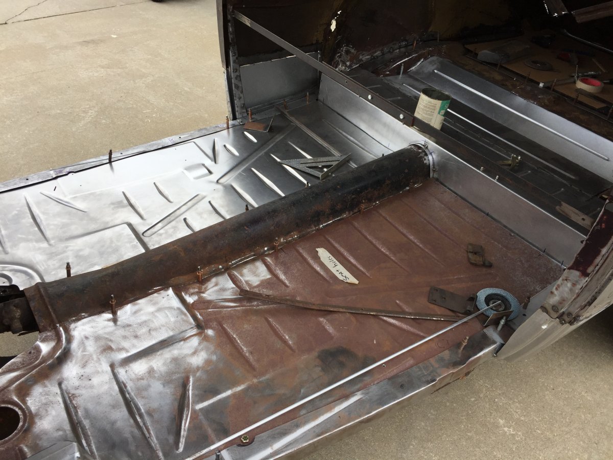

    One more opinion for you ! Whenever I try to shortcut something I always regret it later. So after many years I learned that putting in the extra effort to do something right the first time always pays off later....meaning no problems later.
    I think since you have a Mig and not a Tig, you should concentrate on how to make the Mig do the job. I'd start with using .023 wire which will work best if you put a .023 liner in your welder. The wire is easy to get crimped if you try to use the larger liner. I would also do s***ch welding like 46 Caddy mentioned. I have just modified a dashboard where I used .030 wire and s***ch welding. It did pretty well but had to be careful. Since I have a bunch of sheetmetal to weld in some future projects (at least two floorboards,rockers, and maybe a chopped top), I bought me a second mig and set it up for just .023....which means less heat input with each s***ch. S***ching is like a line of overlapping spotwelds. It seems to work well for sheetmetal and somewhat limiting heat input and subsequent warping. Controlling the heat input is a major concern when welding thin sheetmetal. Doesn't hurt to pause between each s***ch to allow the heat to dissipate.Also, grind welds slowly and don't heat the panel with the grinding wheel either. Go slow and allow cooling.
    Try to never get the panel or the weld red.....just keep it cool and everything will be cool..........
