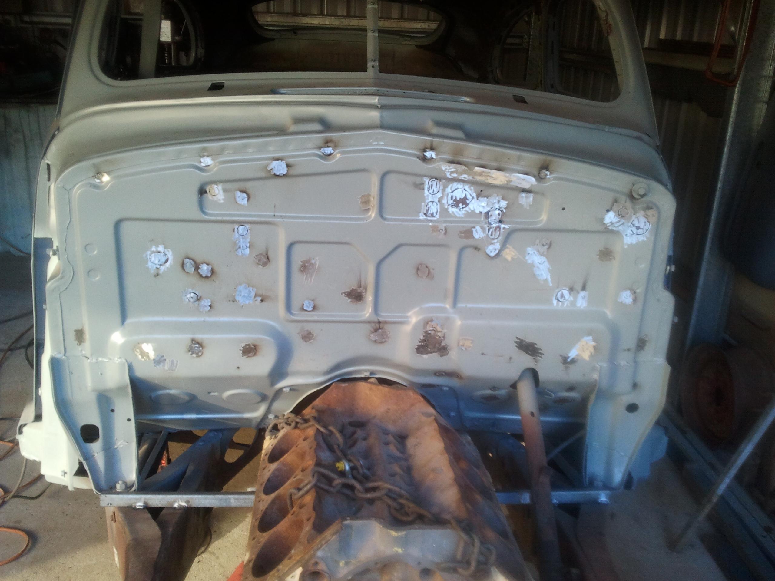

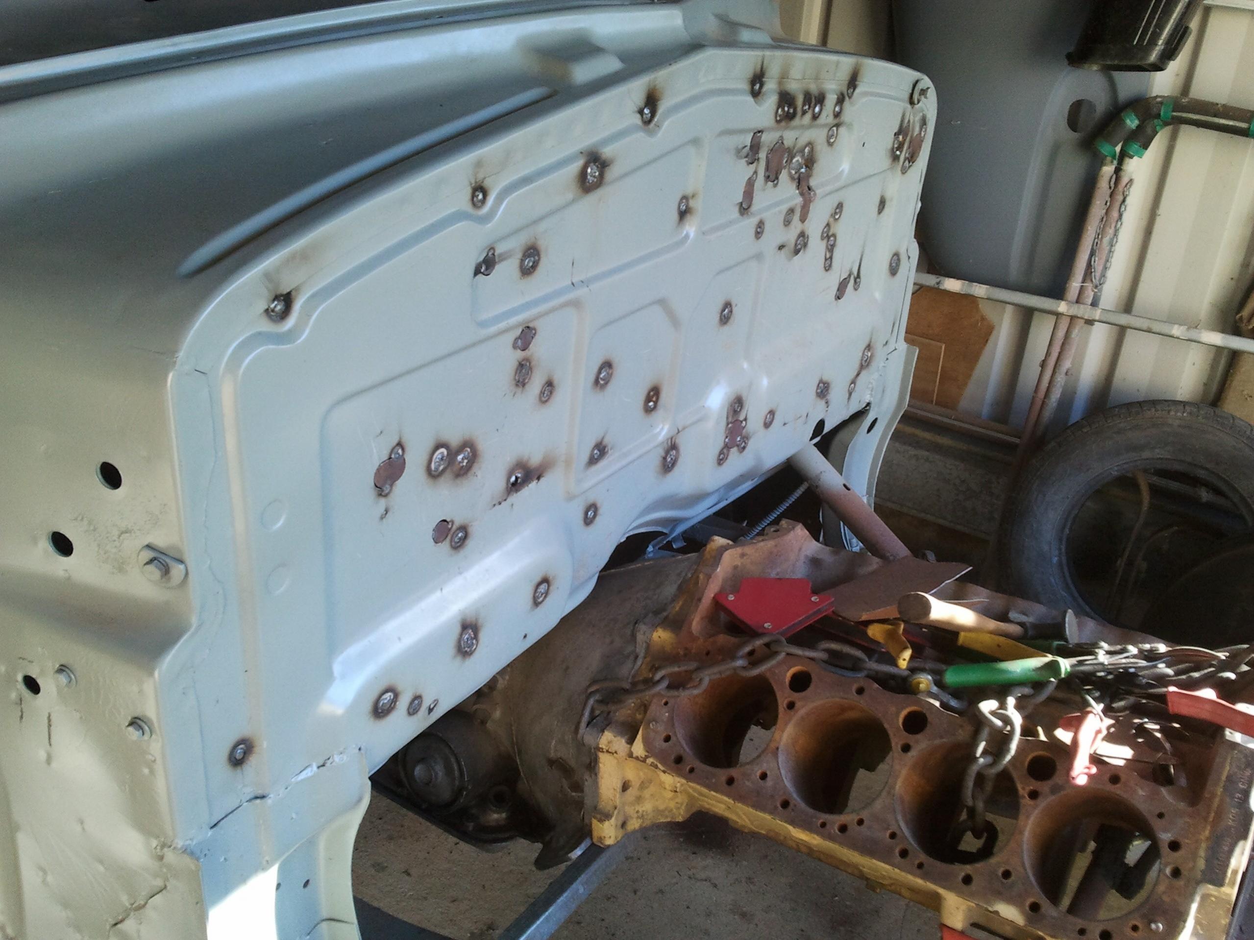

    A block of copper behind hole and MIG weld, spot by spot for smaller holes then grind and linish smooth. Larger holes require filler pieces cut and tacked in with a MIG, a quick grind and linish before TIG'ing them up. I lost count of the number of holes in my '46 Olds firewall. 60+ :D It would have been easier to replace firewall with a flat sheet however I love the OEM pressings.

    I agree with mgtstumpy on the OEM Olds firewalls. Pretty neat stampings, but looking from the inside out it looks like someone emptied a shotgun with double 0 buckshot. I was amazed at the number of factory holes in my 39 Olds. Lots of welding ahead of me also.
