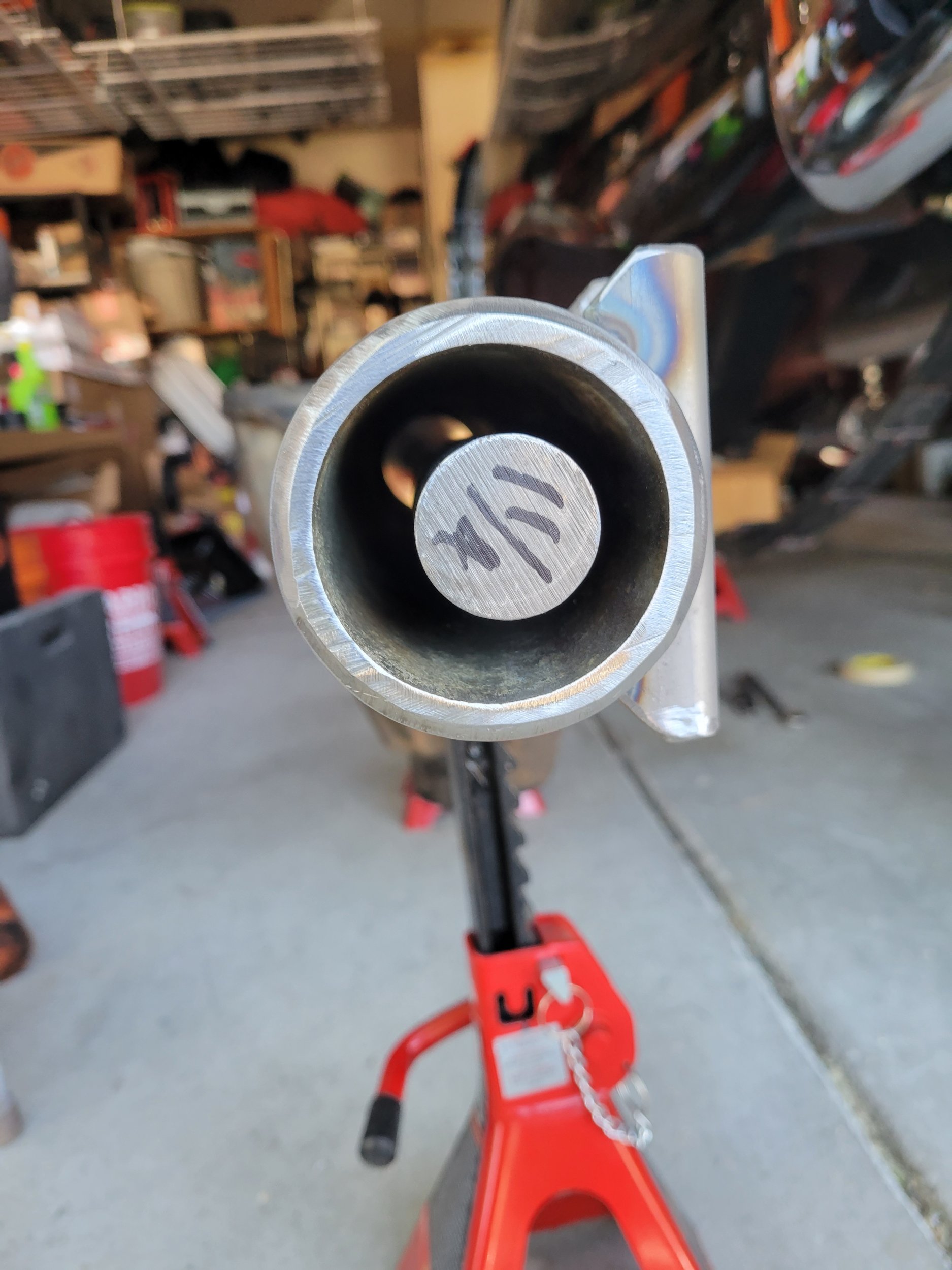

  14. 20230515_094147.jpg On my stock Dana 60 out of a truck with 5/16" wall thick tubing, the housing needed straightening before being jigged and perches welded on, I was very suprised, just goes to show ya gotta check 'em... pic shows perch only tacked in place.

    Welding the perch completely may bring it back mostly straight. I would have definitely done that before having it straightened.
