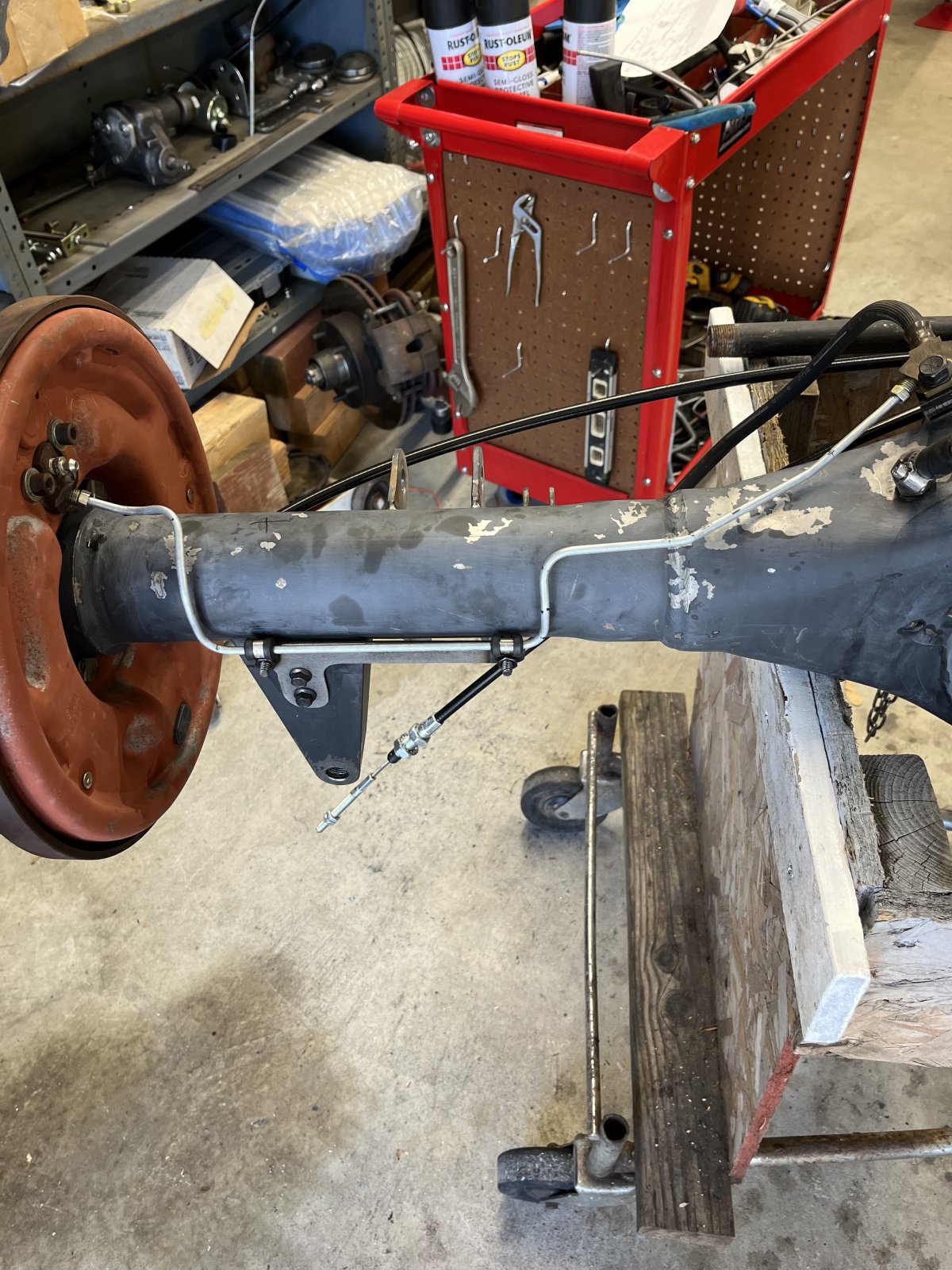

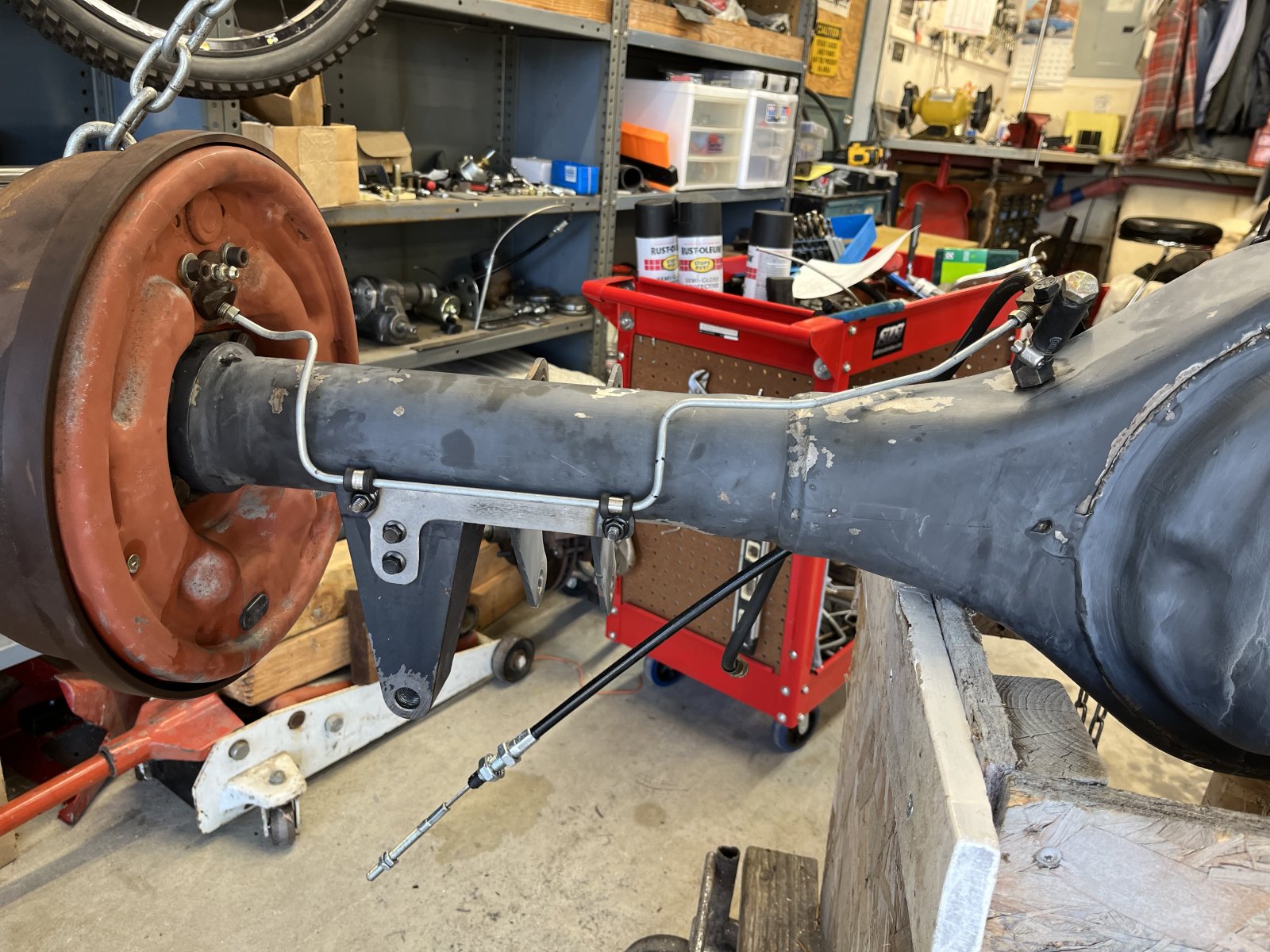

  14. nochop
    Joined: Nov 13, 2005
    Posts: 4,560
    nochop
    from norcal
    You’re that guy! Lol
  15. 2OLD2FAST
    Joined: Feb 3, 2010
    Posts: 6,055
    2OLD2FAST
    from illinois
    That's amazing considering the tolerances I've seen .
    nochop likes this.
  16. Rickybop
    Joined: May 23, 2008
    Posts: 10,660
    Rickybop
    Night shift. :rolleyes:
    :D
    seb fontana, 2OLD2FAST and nochop like this.
  17. nochop
    Posts: 4,560
    nochop
    from norcal
    chicken and Happydaze like this.
