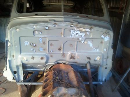

    This is my firewall, cut patches to fit hole(s) and hold or get someone to hold a thick piece of wide flat thick brass stock on the back of areas you are welding it to. I then tack welded (MIG) holes and patches from outside and will TIG them up later. The weld won't stick to brass and no dags on the inside making it easier to finish later. Brass will get HOT.
    If you can't find someone use some magnetic triangles to support the brass against the panel and then hold it flat with some steel RHS tubing behind on the magnetic supports sandwiching it to panel..
