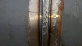

    I'm not sure where some of these guys are getting there info. Saying you machine is only good for max 1/4. Are they trying to get full penetration or what....lol Its funny how the welders at the nuke plant i work at tig weld 1.5" thick wall pipe with only 150 amps all day everyday. Ive been tig welding for 25 years, I own a lincoln precision tig 185. I have never wished for a bigger machine on steel, now aluminum is a different story. Now to answer some of your questions...
    First off you must be patient when starting your weld. Your welds prettiness will depend on your consistency of dip (filler material) move (tig torch). To much coffee will tell on you when tig welding. It will show any hand shake. Give that pedal a mash to get you started. You must wait for material to start puddling as wide as you are going to want your weld to be. Once material starts getting some heat you will want to slowly back off your pedal to keep puddle a consistent size, special when you start coming towards the end of your material.
    Your problem with the tungsten balling up is one of two things. 1 your polarity is in reverse. 2. when you are adding you filler rod you are adding to much and your tungsten will suck it right up.
    Nickels: you will not get a weld looking like nickels on steel. You need to try aluminum if you want the nickels. Your weld will look like circles on steel.
    Argon settings: If your welding in your shop 25 is fine. You can probably turn down little more. But remember the gas is what is shielding your weld. Turn it off to see what happens if you get a little wind blowing buy. So better tad high then to low.
    Tungsten Diameter: 3/32" is good for your machine. You would only need bigger if welding aluminum. Tungsten will stay sharper longer with the 1/8". I personally like the 3/32" better.
    Distance tungsten can stick out: Rule of thumb is the width of the mouth on the cup. So if you have a 3/8" opening you can stick it out 3/8". Again this is rule of thumb.
    No filler material: Your welds will be just flat, because you are not adding any filler material. Your puddle is the penetration.
    If you really want to get good. Google walking the cup tig welding. And learn this technique.
    And for those who want to argue. I posted a picture. So when you can lay them down like this free handed ...... hit me up.
