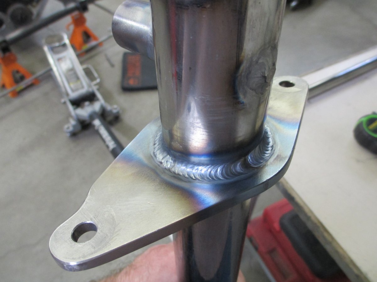

    My handwriting is terrible, one teacher compared it to a baby chicken walking across the paper, after stepping in an ink well. I would rather weld than write, anyway. IMG_0299.JPG

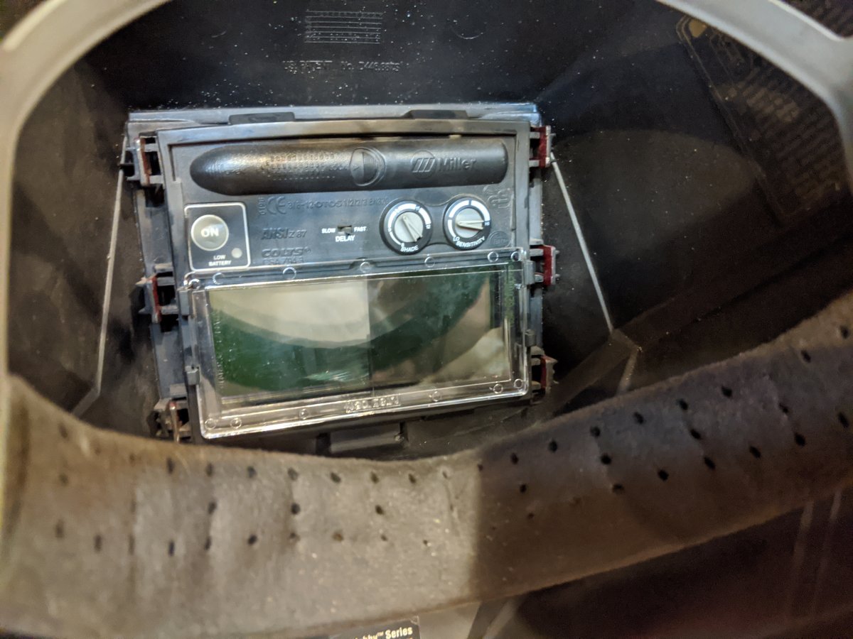

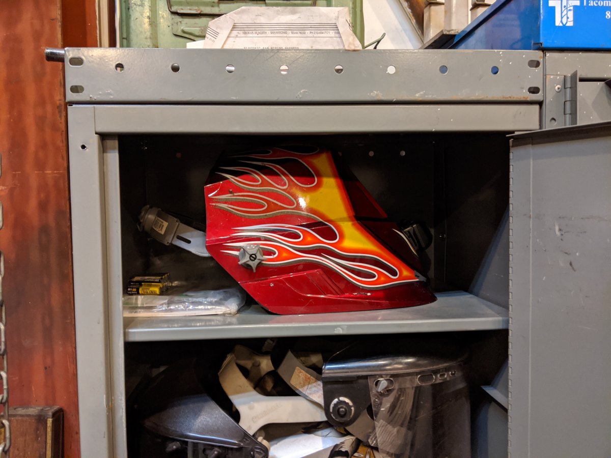

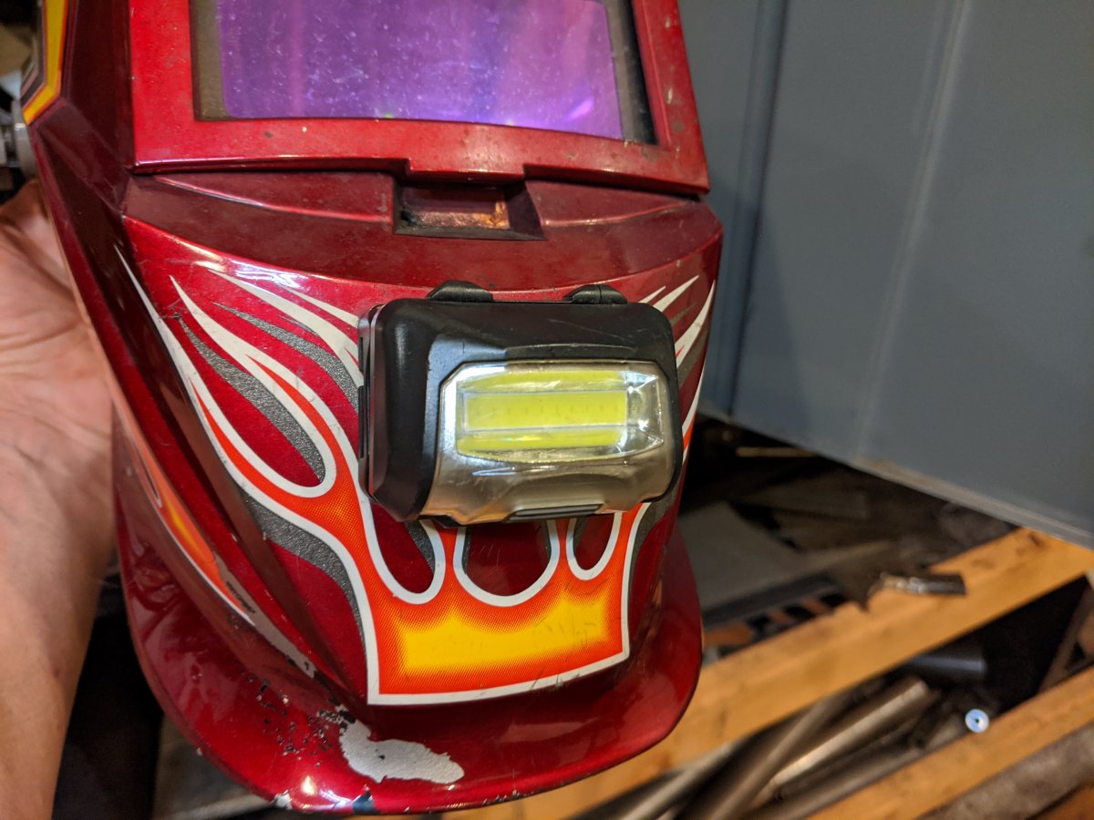

    Three little tips,
    Keep the helmet clean and dry,
    If it's not on my head it's in the box.
    Use a bicycle type headlight attached to the helmet
    With fresh batteries to light the work
    Use magnifying lens
    I'm using 1.50 lenses and reading gl***es on
    So I can see when I flip the hood up too

    Well, there goes that theory! Lol ! Nice welds!

    Paul, looks like you have every accessory but a radio on that helmet.

    I can use all the help I can get.
    Filtered air under the hood would be nice.

    Marty, I take your point. I did not mean to imply a person has to have a fine writing hand to produce
    excellent welds. I just noticed through the years some
    guys that had really nice writing skills made exceptional
    appearing welds. I just think there is some correlation
    between the two. Your welds are top notch in appearance and surely quality as well. Nicely done Sir.

    Marty, can you tell us about this weld?
    What machine, settings, tungsten, filler rod, anything?

    I would rather be decent at welding, than write like Richard Petty. King Richard the most beautiful signature
    I have 2 tig welders, a Lincoln 300, that I bought new in '76, and an old Miller Gold Star that I gave $700 for around 2003. I used the Miller, when welding the 1/4" thick brackets on a .250 wall front axle. When welding steel, anything thicker than 1/8 ", I use a 3/32, 2% tungsten, and a gas lens (shown). The screen, collimates the gas, allowing the tungsten to protrude further out of the cup, to reach into corners, without contamination. As far as filler rod, that weld was done with 1/16, ER 70S-2. As far a setting, unless I am **** welding 1/16 steel, I rarely switch the machine off of the middle setting, that has max amps of 225. I adjust the rheostat, to to a range that makes the pedal comfortable, for the various metal thickness. Both of my machines are big, heavy, and old, but I find them reliable. The machines with pulse, make it easy, almost like cheating ! I select filler rod size, to match the size of weld I want to achieve. The last bracket shown, was welded with .045 filler, the tube was .065 wall, and the mounting plate was 10 ga .134 thick. IMG_4981.JPG IMG_4983.JPG IMG_4982.JPG IMG_6207.JPG

    Thanks Marty, that's very helpful!
