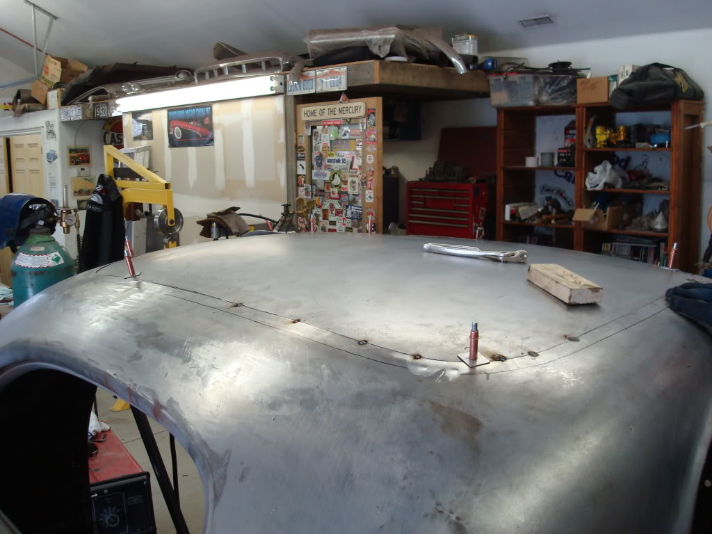

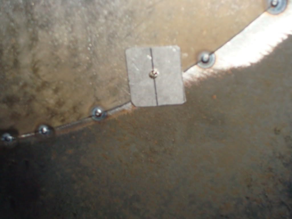

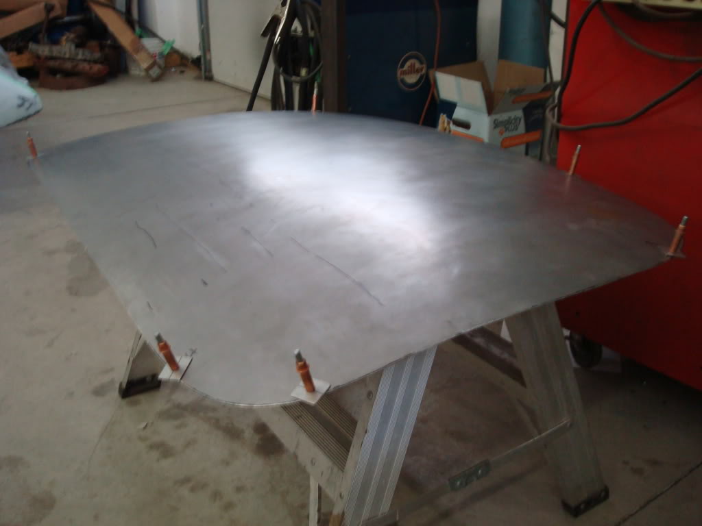

    I use mig for meatball stuff and for tacking (+1 on the Esab easy-grind wire, makes good tig filler too), anything involving an outer skin I prefer to tig. As many others have said; align, tack, knock the tacks down, weld short sections, hammer on dolly to minimize shrinkage, bump/ file/ pick/ floater disc to shape panel after the welding is completed.
    I like **** joints as tight as I can get them, have never used panel clamps. I sometimes use a small s**** of sheet metal with a hole in it on a Cleco or skin pin, if necessary add another sheet metal s**** on the back side to keep the panels in line till they're tacked, plug the Cleco hole after welding. Hopefully the attached pics show this more clearly than my description.

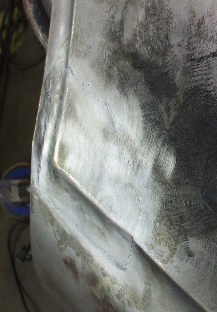

    Cheap air tool from Harbor Freight works great for me. Photo is 18 gauge.
