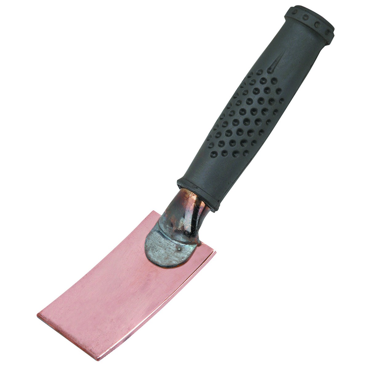

    With a mig and copper backer a little gap isn't such a bad thing as it gives you a little "free" penetration.

    You use the copper backer or s**** behind large gaps or holes.
    Mig wire will not stick to it.

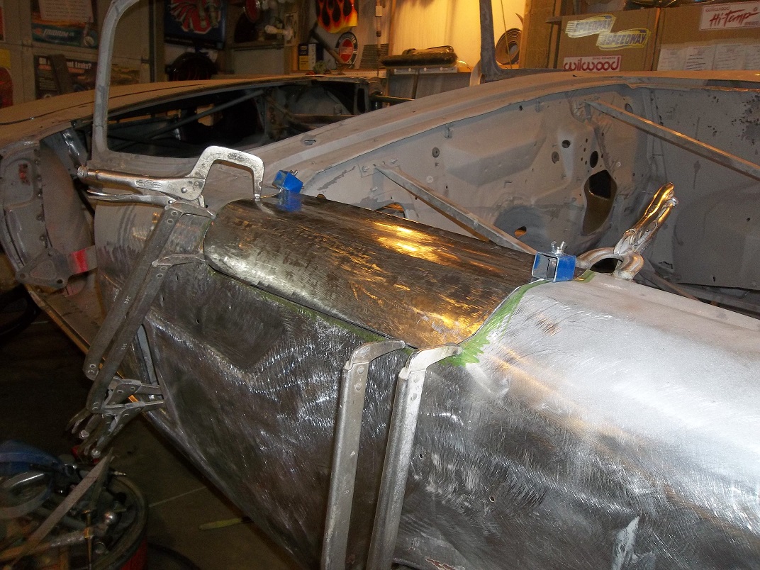

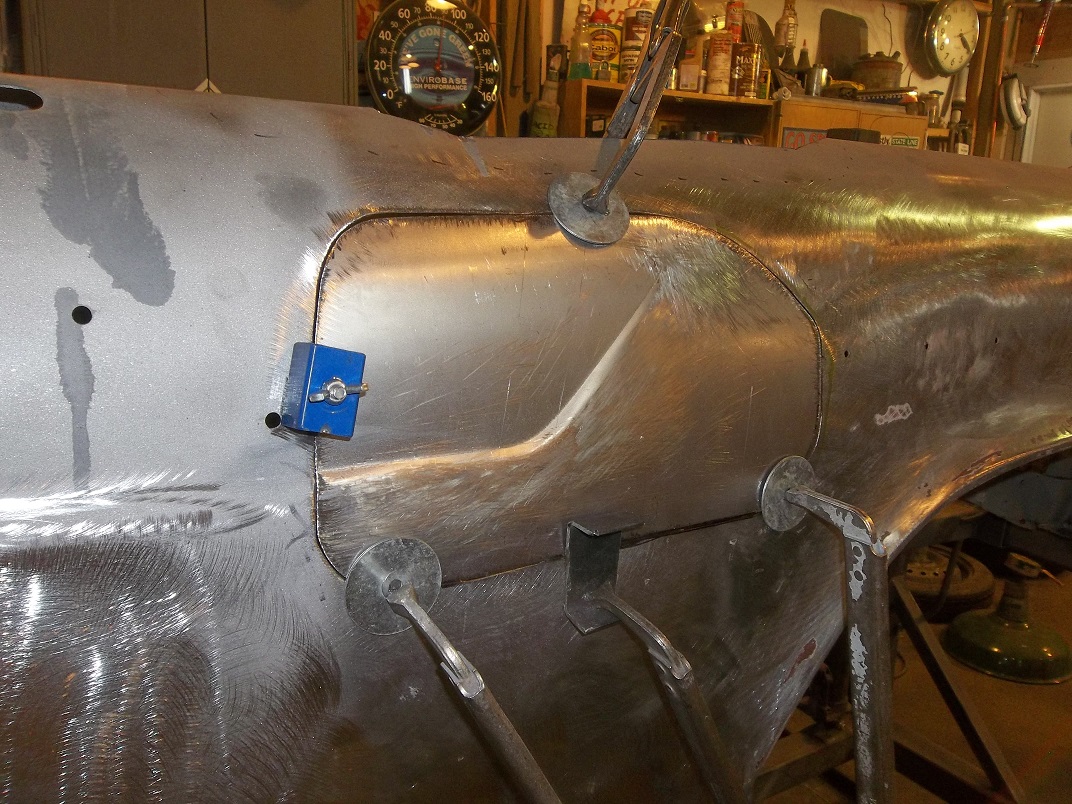

    Ok armature question 1001. What do y'all use to clamp the 2 panels together when you have difficult areas.
  25. I've used 2 clecos and a piece of s**** to hold the joint together.
    And as said above, a small gap helps.
  26. Can't have too many vice grips! I use the panel clamps too.
      438.9 KB
      310
