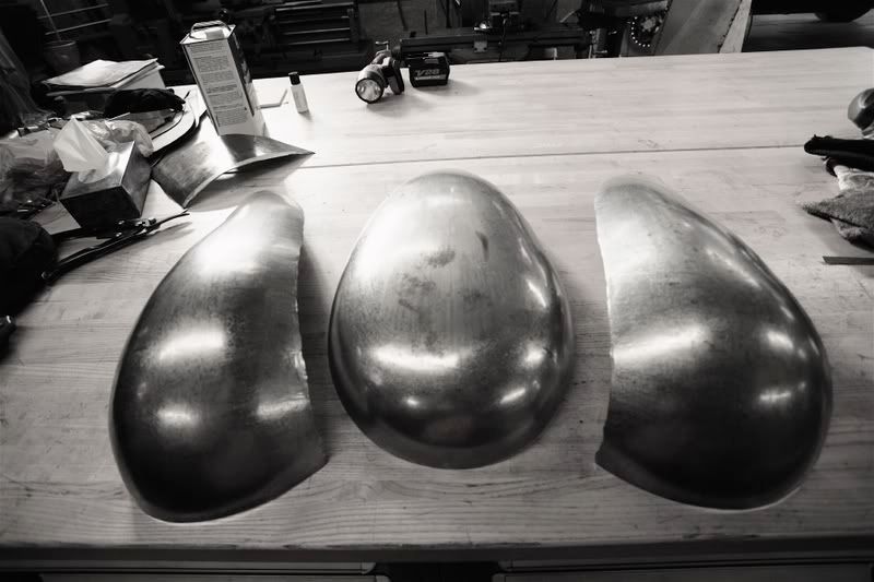

    Attached is a picture of a piece of 20 gage cold rolled that I shaped for a fender flare. I ended up throwing it on the s**** pile, and later grabbed it and made it into a fan shroud cap for an aircooled engine. As you can see it has a tremendous amount of compound shape. No annealing or heat of any kind was used to make the part. I have never had trouble shaping cold rolled steel into virtually any shape I want shaping the metal cold. There are times when heating and beating are faster, but I don't think it has anything to do with the more technical annealing process.
    Annealing is a term I don't use much in relation to cold rolled steel because I have heard it said that true annealing of steel must be done in a more controlled environment than most of us can muster. Not sure if this is true or not, and can't remember who said it, just that I respected their opinion. I know that you can relax sheet steel with low temperature heating (no color change) and cooling with a torch or shrinking disc, but I'm not sure that this is technically annealing.
    Anyone know different for sure, or is the term annealing a little over-used in relation to steel?

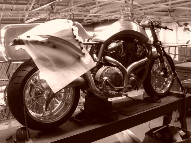

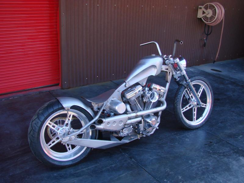

    Let me help out a little bit...
    "To anneal steel it has to be heated to cherry red"
    Actually to anneal steel it needs to be heated to about 600-700 degrees. Takes on a Brown color.
    The aluminium for the tank that Jesse James made did not need annealing there is not much shaping in that tank and it would be easy to put that amount of shape in without annealing it but that is off subject."
    That Tank was .080 3003 with a 24" Radius in the whole top of the panel. It could have been done with a powerhammer and No annealing, but that would have drasticly changed the overall thickness of the material. It would have also work hardened the hell out of it, and run the risk of stress cracking. At that time I did not own a powerhammer. Just a Mallet, Shot Bag, and an English wheel.
    Gas welding is the method that was used in the old days and I don't think it can be improved on for **** welding sections together. Mig and tig have their uses but gas welding is by far the quickest, least distorting and easiest to metal finish if it is done properly."
    Gas Welding is great for keeping the weld and panel "soft" and workable, But you run a higher risk of warping. This is because gas welding has a much larger Heat Effected zone than a TIG weld.
    For steel I only TIG
    For Aluminum I either Gas Weld or TIG weld.
    It all depends on what tools you have and what you are comfortable with.
    *Note* One of the biggest rules of thumb for welding sheetmetal. Make sure your gaps and tacked together tight! If you cut corners and get lazy with your gaps. You will pay for it later when metal finishing your work.
