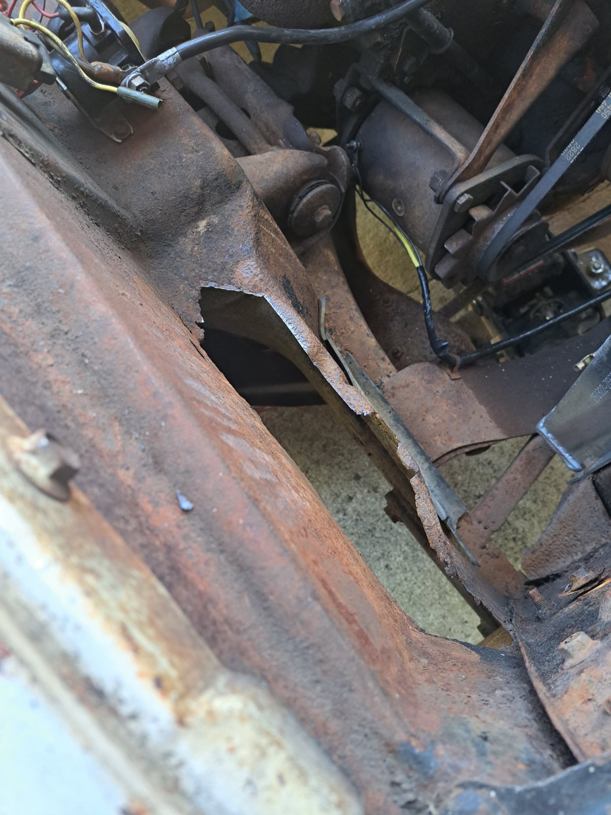

    pictured above, my lack of battery tray, im fixing the "tray" part with angle iron and a junkyard sourced license plate.

    Once you start on the car it looks like you need to cut back that hole to some solid metal before patching. That thin rusting stuff will just melt away. Then clean all of the edges to bare metal.

    Any chance the aftermarket makes a replacement inner fender for your car? Based on your picture, there is a good chunk of metal that needs to be removed before you are left with only sound metal. Angle iron and a licence plate ain't gonna fix that. Also, I am not seeing metal that is clean enough to weld. Cut out the rough, weak, thin stuff then use a grinder or a sanding disc to clean the metal in preparation for welding. From what I can see, no metal in that pic is ready for welding ... a wire brush just isn't up to the job.
    Either you've got a bad ground (metal not clean enough) or your ground is good but you are actually attempting to strike an arc on metal that just isn't prepped correctly/clean enough.
  13. From the photo of the missing battery tray you posted...the metal in the area you appear to want to weld to looks pretty thin and pitted. That metal will pretty much dissappear with the addition of the welding spark. Even a seasoned welder will fight it. You'd probably benefit from cutting deeper to find better metal as your starting point.
    Edit: @borntoloze types faster. ;)
  14. In that pic the metal is WAY too rusty and most edges too thin. You will never get a good ground, weld and will end up with lots of blow throughs

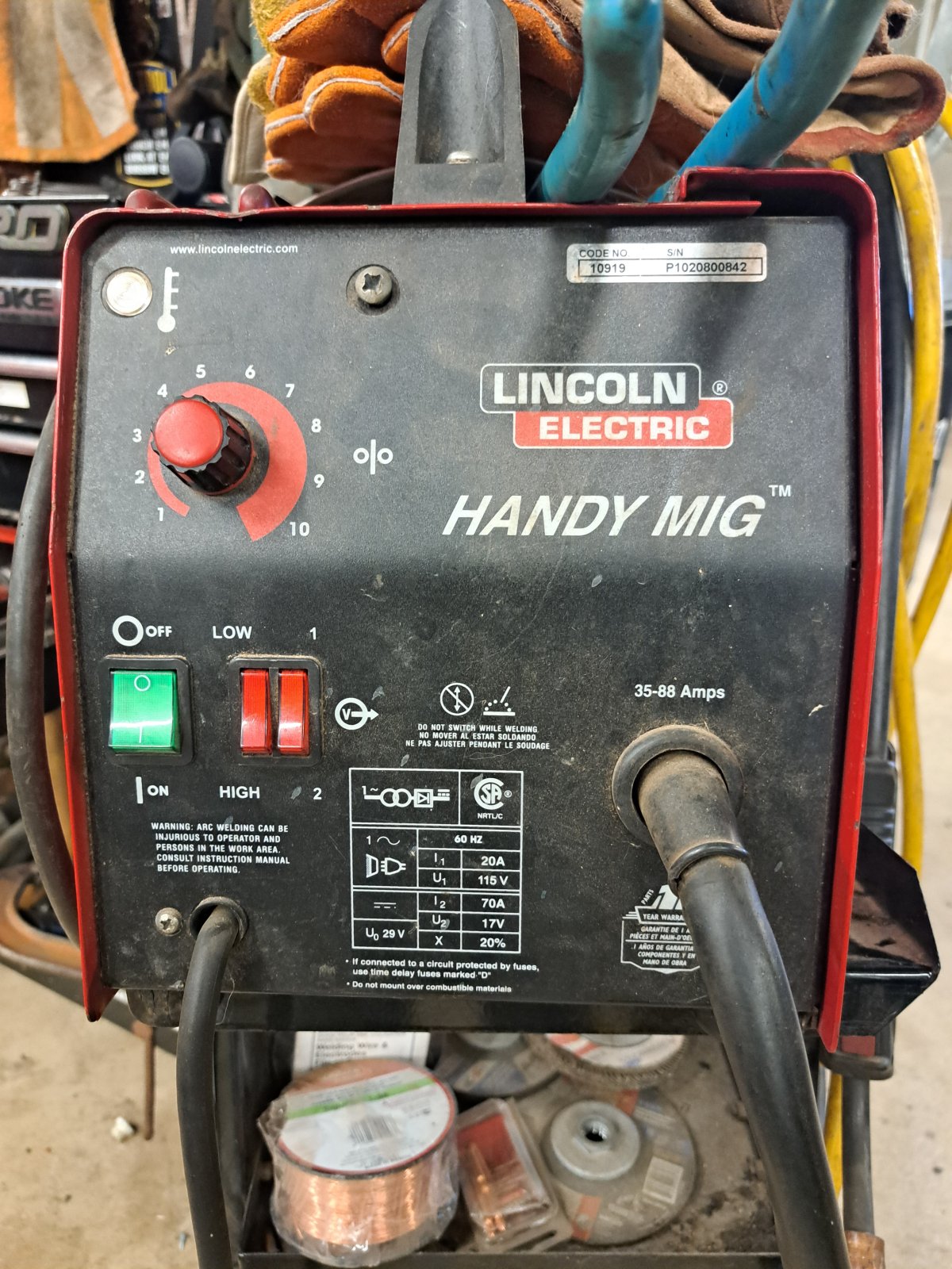

  23. my dads lincoln welder has very few options.
    it has a knob that goes from 1-10, i have it set on 3.
    it had a switch that has Low, and High.
    and a switch that says 1 and 2.
    its funny that the tombstone for stick welding is properly labeled with exact amperages from 35-225, but this mig welder has very few options.

    Sounds like a Handy Core model. The dial is your wire speed and then you basically have 4 voltage settings (which is pretty common on 120 v MIG's) low and then you can adjust that between setting 1 and 2 and then High which you can again adjust between 1 and 2.
    If it is this model here is the manual if you don't have one.
    https://www.lincolnelectric.com/***ets/servicenavigator-public/lincoln3/imt821.pdf
    Squablow likes this.
  25. indeed it is a handy mig. i had to go help my mother so i put the welder away, going to practice some more after i read through the manual, as my dad lost it long ago. 20230831_144202.jpg

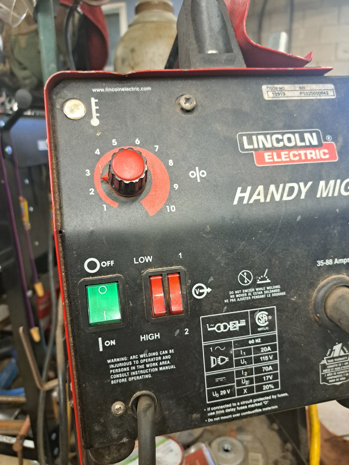

  29. its spattering, really bad. i have a video im going to upload, here are the settings i have it set to. 20230831_151836.jpg
    im using some s**** 18 gauge steel.

    Lay the cup against the metal, don't try to let it float above the surface.
