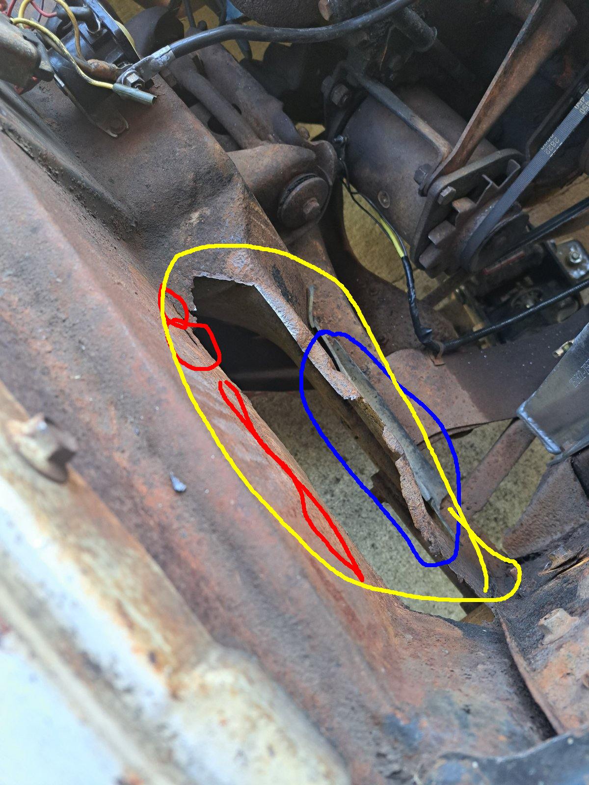

  15. Naw, that inner fender patch is an easy 1 piece patch AFTER you know what you are doing. None of the bends are even that crisp. Most of the shaping could be done with basic tools like a small fence post or piece of pipe, a couple 2x4s and a vice.

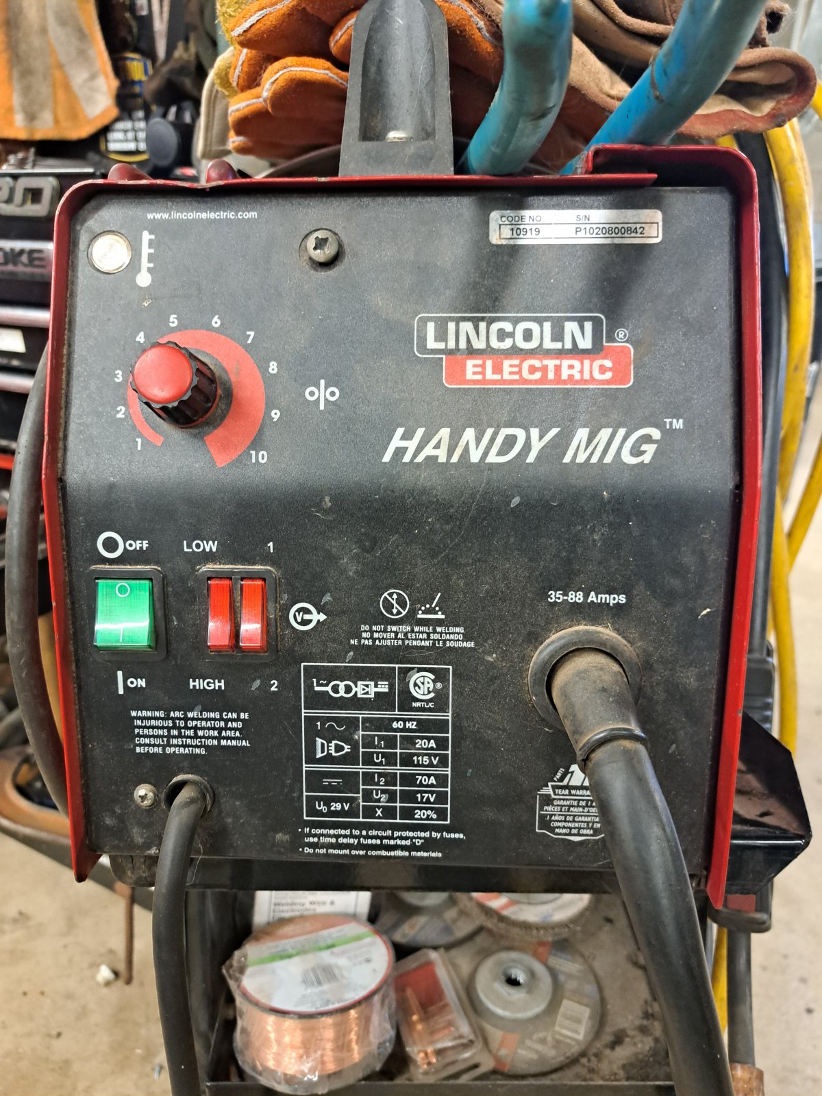

    IDK if you found a manual or not, but the Lincoln website does have manuals for old machines.
    Here's the one for your 10919 unit. http://www.lincolnelectric.com/***ets/servicenavigator-public/lincoln3/im756.pdf
    In general:
    1) Clean the metal until it's shiny
    2) Use gloves.
    3) Brace your hand against the workpiece so that your movement can be steady.
    4) Position the torch more closely to the workpiece.
    5) Move more slowly.
    It looks like you might also need to increase the wire speed (controlled by the dial) and increase the voltage. The manual has a chart with recommended settings for various material thicknesses.

    As a noob with no major tools, first I would create a patch for in the red ..... it is rusted out there & nothing to weld to.
    Then I would tackle the section in blue, I would bend the flange & make the side maybe 2"?
    We cant see what is on that side below ... getting that piece welded into the top will give something below to weld to ..... because it has a sharp angle going down in the front, I would probably make that in two pieces possibly 3 & weld them together. Just easier to do with no special tools.
    Does some weird stuff as it gets closer to the front.
    Then would make the shelf in yellow, should be easy enough to bend to shape .... again could do it in 2 pieces if needed.
    I just suspect there is a lot more work there then meets the eye ... we cant see from the photo.
    What I mean when I say you need to look at the job then create a game plan on how to complete.
    The more experience you have the better your game plan.
    The better your tools the better the plan ..... In my example above even a noob can do a solid repair.
