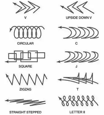

    Cursive "e" is my go-to. Your "circular" with a slight slant to it. I also had a guy show me what he called the "Lincoln wiggle" sort of a 2 step forwards, one step back, two steps forward...pushing the puddle. Makes for a nice "stack" but I am not sure about penetration.

    My welding teacher taught us that wiggle but just called it "the flick". I had trouble doing it consistently. It made pretty beads but didn't penetrate that well for me, but some guys had good luck with it.

    LOL! Same thing. Looks pretty but I know it is not penetrating after viewing the back side. That sounded weird didn't it? I didn't mean for it to sound weird, but it did, didn't it? I know it did.

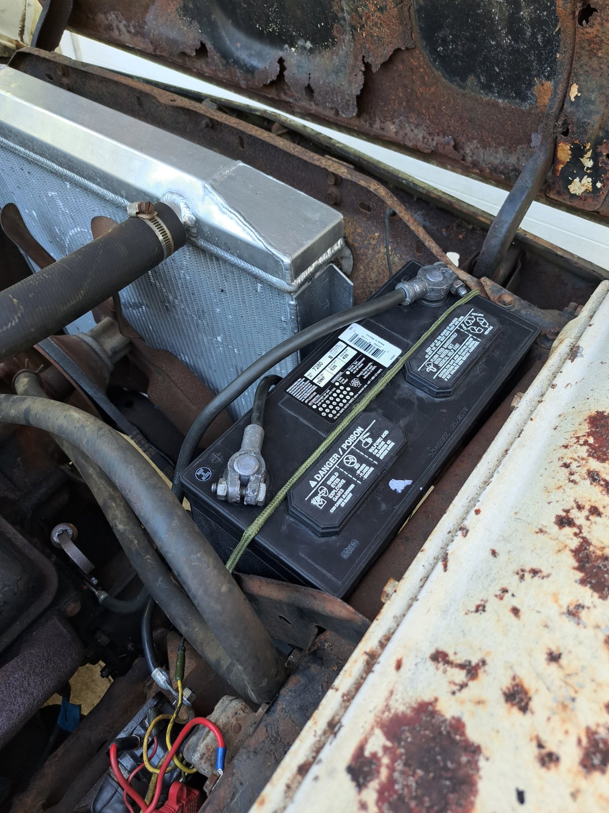

  8. this is the battery tray i mentioned earlier, im still fixing it "bolt together" instead of welding 20230901_103816.jpg and this is the ancient tombstone i mentioned earlier in the thread
    2Blue2 likes this.

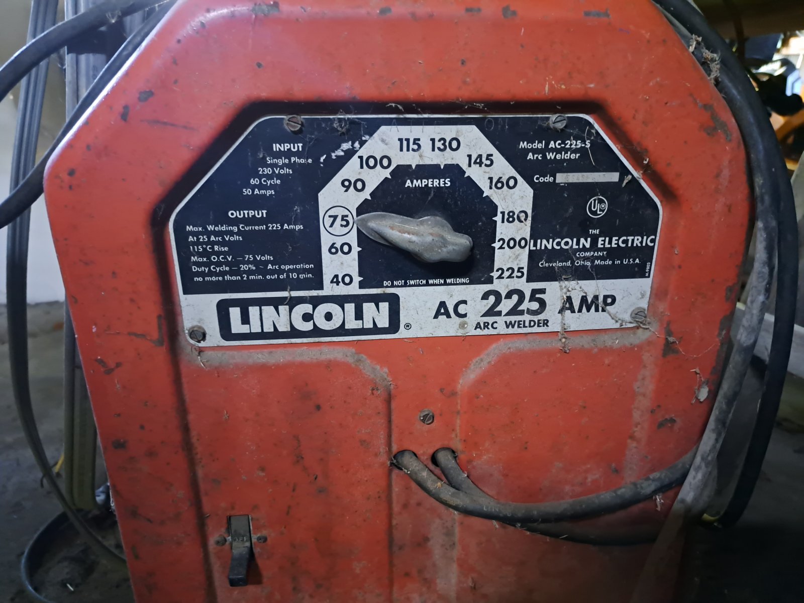

    That is one of the best "Buzz Boxes" you can get. Why do you think there are so many out there? Stick is totally different than mig but both are totally achievable for the novice with some practice and learned advice. You are getting advice from professional welders and self taught here so do not give up and start bolting things together. Do not be afraid to expand your knowledge and skill set. You may never be perfect. Very few of us are but we can put out some satisfactory results because we are not afraid to learn.
    Boneyard51 and The_Cat_Of_Ages like this.
  12. i do plan on properly replacing the battery tray in the future, but for now itll get it on the road. 20230901_112110.jpg
    i expected to be able to do it pretty quickly, i was heavily mistaken. so itll need to wait a couple weeks or months while i learn how to properly weld.
    i have FAR from given up, im just working with what i have for now, and coming back once i have the skills to do it proper :)
    Boneyard51 and Happydaze like this.

    That'll work for now, but something a bit more substantial than an aluminium number plate might be a better idea. No steel roadsigns around?
    You get your ribs tickled around here suggesting you might be able to properly weld in a couple of weeks or months, but don't be put off. Practice, practice and practice. Then repeat.

  16. no inspections here, plus with a battery on it its like its not even there. its a lot safer than the previous setup. 20230901_124020.jpg
    a real battery hold down is on its way, i also need to fix my heater core, considering making a heater valve thats separate from the rest of the heater core.
    i'll get more issues from my rusted out hood.
    Lone Star Mopar and alanp561 like this.

    That battery isn't sitting on those bolt heads, is it?
    clem likes this.
  18. Another idea if you want it sturdy as you're still learning. Keep your angle iron frame, find some 18g sheet, cut out a chunk, bend it 90 deg so it will fit inside your new tray and up the rusted side (covering the open areas). Get some weld through primer (like SEM 39783), hit everything with a flap disc to get to clean metal, drill holes in your new panel (couple on the bottom, sides and top), spray everything with primer and plug weld the panel in (fill the holes with weld). Grind your welds flat where the battery will sit (you might even use a piece of rubber under it like an old tire tube), paint the whole area and you're done. You can use some seam sealer if you want around the seams (also in the wheel well area) to make it less likely to rust again.

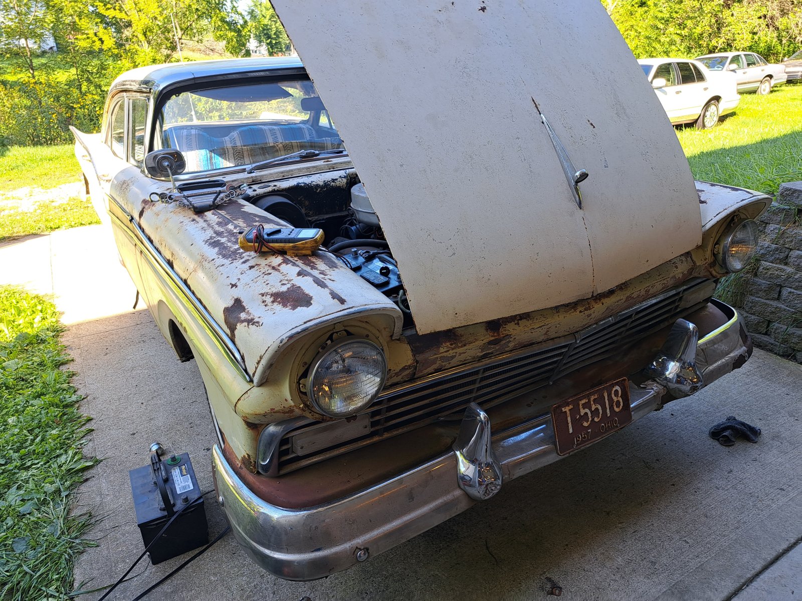

    what car is this in?
    The_Cat_Of_Ages likes this.
  23. my 1957 ford fairlane, i just noticed the screws and screw brackets for my headlight bezels are missing 20230901_163234.jpg

  25. thats my dads, he 8.1 vortec swapped it. its a killer car.
  26. its sitting beside it, its locking it in.
    alanp561 likes this.

    It's not really about being macho for me. I wear appropriate boots, pants, often a leather apron and always recommend everyone does the same... but for bodywork and building brackets and so on where it's going to be a lot of very short, precise welds my skills just fall apart when wearing gloves. They don't make welding gloves for little girls and I have little girl hands. It is what it is. ;)
    What I mentioned about moving the tip of the gun in a pattern is probably the #1 most important welding tip you can give a guy (that he wouldn't necessarily figure out on his own through trial & error), so make sure you practice that, Cat.
