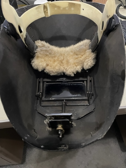

    Seems there's always someone eager to tell you how to spend your money ...

    I agree with you 100% .... Where you are going to save money in building your car is doing the fabrication & welding yourself.
    I live on a fixed income retired .... I have no options to go earn extra money .... I could afford a $50 helmet.
    Using the helmet you have is a ******** joke .... people are pumping you up to say thats what they learned on .... You want to build a car? ... Get good at welding & fabrication .... spend your money there.

    I threw one of those flip lens helmets away 30 years ago. Didn't work worth a darned welding floor boards under the steering wheel and dash, every time you flipped the lens down, the helmet moved on my head. The full flip helmet (with the big lens) worked much better for me. The auto darkening helmets were even better, when I used them often, but now that I'm only welding once a month or so, I'm back to the old flip helmet.
    Not every professional welder is a boilermaker, in fact, probably very few are anymore. There are a lot of welding occupations where skilled welders are still needed. Lots of industrial welding is still being done by humans, and much of that relies on highly skilled people. Most industrial welding shops require certifications, and at many of those, having an auto darkening helmet is a must. Then there are fabrication shops and the old fashioned welding repair shops that still have skilled people welding stuff together. The area the welder (the person) is working in has different requirements for the equipment he (or she) needs to do the job.
    In the automotive world, the welding equipment you invest in is like any other part of the hobby. If you do the same type of work often, you tend to buy better stuff to work with, its kind of a natural flow of things. If you only do something once or twice in your life time, you can usually get by without all the cool expensive stuff, but when you find yourself doing the same thing over and over, those cool expensive things that make the job easier, become more important.
    The OP is just getting started with welding. He has some equipment to work with, all he needs now is to learn the skills. If he enjoys welding and finds himself doing a lot more of it, it won't take long for him to figure out some things are worth spending the money on. If he doesn't like welding, what he has, as long as it functions, is probably OK.

  17. ekimneirbo
    Joined: Apr 29, 2017
    Posts: 5,357
    ekimneirbo
    from Brooks Ky
    Let me see if I can put this in an orderly fashion ..........
    Flip up and down welding helmets work just fine, but you are blind until the arc starts. Sometimes during that movement, you don't always start your arc exactly where you meant to. They work fine but they can be more difficult when you are doing welds where you are under a vehicle or out of position. They do not have any batteries to fail. For the most part they have exceeded their evolutionary era and most people will like an auto darkening helmet better.
    When you are fighting minor nuisances, it affects your weld many times.
    Auto-darkening Helmets need replaceable batteries or you have to throw them away when the battery fails. There are different settings to control the shade of darkness. Cheaper helmets often have a limited range of shades available, and they are directed at mig and stick welding needs.
    Stepping up a little, you can get shades that also work for Tig welding and/or grinding. I don't ever wear my helmet when grinding.......I have a face shield for that. BUT......the Tig welding settings are handy when I use that welder.
    If you don't Tig weld, you don't need the additional settings.
    One of the newer developments is called "clear view". It is definitely an advantage worth having. Many times the problems with welding are caused by the inability to see clearly. You think you are seeing things ok, but often you are proceeding somewhat blindly and following the light. Clear View is nice to have.
    You can spend a LOT ($500) for some name brand helmets, but you can find mid priced ones for maybe half that.
    I stepped up to Miller Hemet years ago and it worked fine...........till it quit and started getting flashes. (I own Miller welders but have had Lincoln in the past) My son bought a Lincoln with clear view on sale for about $250 at the time. He let me try it and I was immediately hooked. Bought me one too.
    My grandson got hired in his first real job to weld for a company that makes truck frames. They gave him a little training and a test and hired him. They gave him a Jackson helmet to use. My son tried it and said its even better than the Lincoln one. I looked them up on line and they apparently sell one for about $250 that has shades for Mig welding and one that has more shades for about $450/$500.
    If money is limited and someone is just starting, I would get a HF helmet. Don't get the cheapest one or one with some fancy design..........they all get beat up and chipped.Looks like HF has stepped up their price variations. The $50 one is probably OK to start with. I would not spend a lot of money on a HF helmet simply because its not something they specialize in and we all know you can get some good and some bad stuff from them. BUT, a $50 investment is doable. Says it should last 6 years. Sometime later if you want to get more involved in welding, you can look at better helmets.

    iwanaflattie
    My stainless teacher only uses the old school Flip hood for stainless,I weld galvanized on the roof and use my 30 old hood given to me by a friend,it was his dad.
    The auto darkening ****s for outside, galvanized ****.
    I used my 30 year old flip hood for my stainless projects at school and it worked great.
    You can bring an auto darkening at work
    But it's not recommended,if it stops working you'll be standing around till you go buy a new one..
    Ironworkers only use old flip hoods and so do pipe fitters for the same reason...
