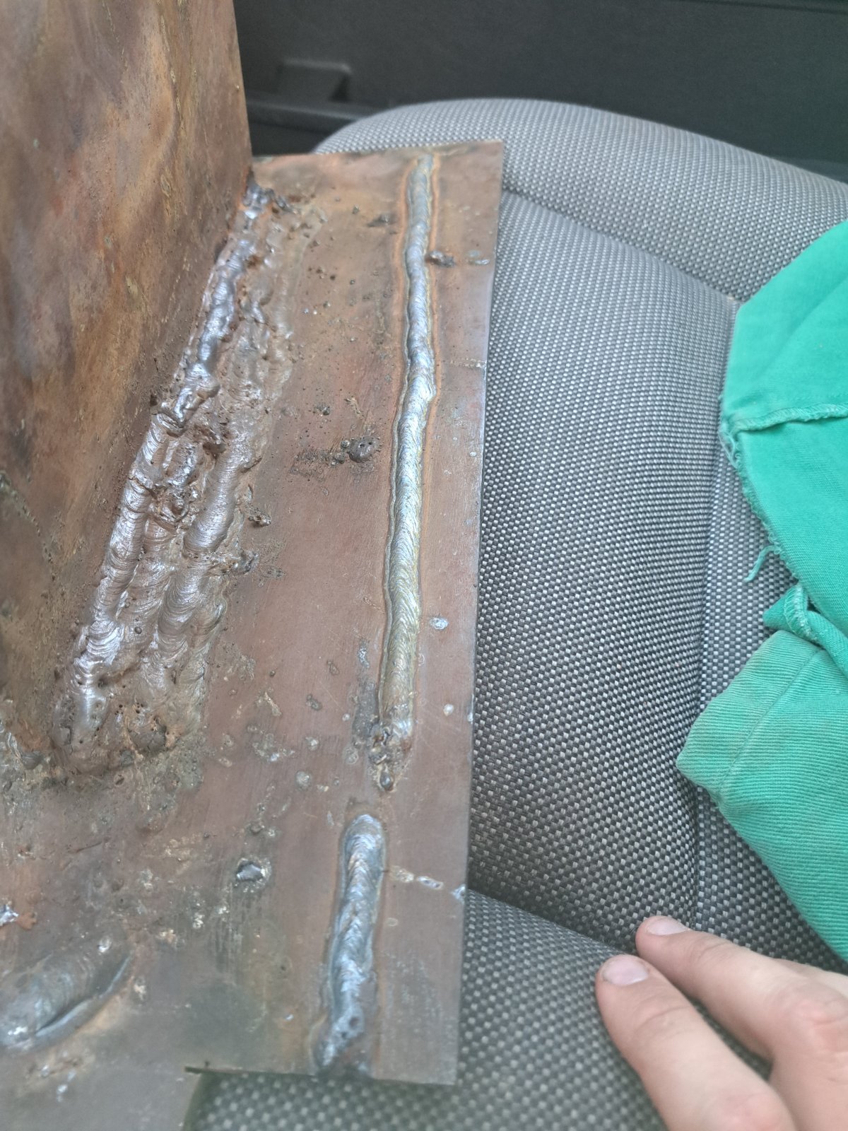

  15. homework this week is: lay beads on the other side and make it level 20231002_153532.jpg

    There you go, dude. See what 6 hours with someone almost as good as I am will do for you ;). Practice, practice, practice, then go back to Wayne and learn some more. One of these days before long, you'll be able to run a bead like that last one overhead. :D

    He's just learning to strike and control an arc. My son Wayne is teaching him the basics and then will take him into the finer points of welding. Wayne isn't about to send him out without knowing what he's doing, I promise.
  22. The metal you are practicing on is a lot dirtier than anything I'd ever weld on o_O
  23. stick is not very picky
    alanp561 likes this.

    I find it's a good practice to clean any metal I'll be welding, before welding it. Good habits lead to consistent welds.

    @The_Cat_Of_Ages , the young guy learning to weld has a buzz box and a MIG machine that was his fathers. For right now, my son Wayne is showing him how to use what we call "farmer's rod", E 6011, E 6013 and E 7014 that are run on AC machines so that he can learn how to run a bead. There's a reason it's called "farmer's rod" and it's because we haven't known too many farmers who didn't start out welding rusty farm equipment with the cheapest AC machine they could buy rather than pay a good welder to do the job right. For what the kid is learning right now, rusty scrap metal works just fine. Hit it with a wire brush and go. The impurities will burn out of it. When he is able to control the arc and the puddle, Wayne will teach him the proper ways to weld plate as well as sheet metal. There's more to being a welder than being a shop rat in a climate controlled environment.

    you said it all when you called the 6011--only thing nicer on rusty is 6010,prob not for ac tho--and doesn't dig as deep as 6011 either

    Couldn't agree more. When I was a kid, I learned to weld on a MIller "buzz-box" using the aforementioned "farmer's rod". With that, you could weld through rust, paint, and chicken shit. When I got my MIG, I had a lot of bad habits. It took a lot of time and a lot of work to break them. When I first got the MIG, everybody told me how easy it was to use. Not with dirty metal it's not.
